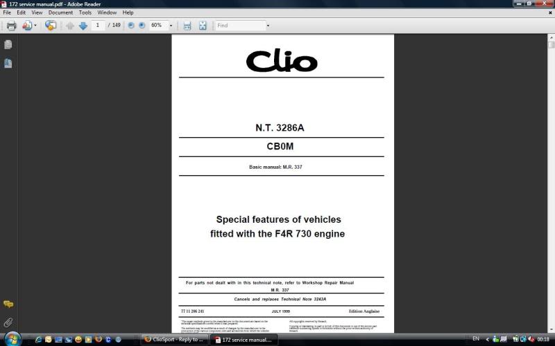

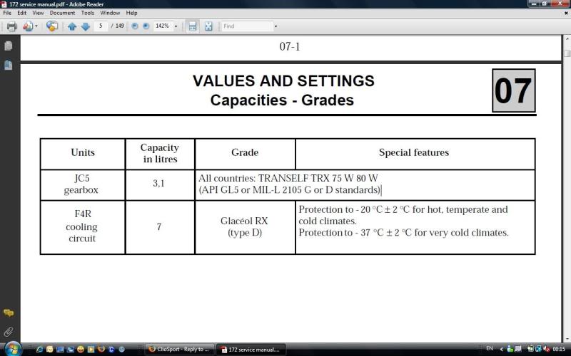

what oil goes in the gearbox? grade etc i need to check my levels as i have a slight leak aswell.
I hope this answers your question mate ;)
Taken from here ;)
