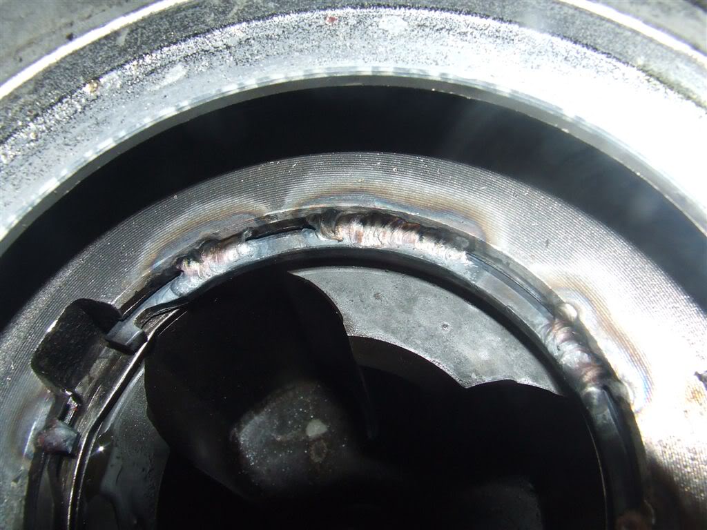

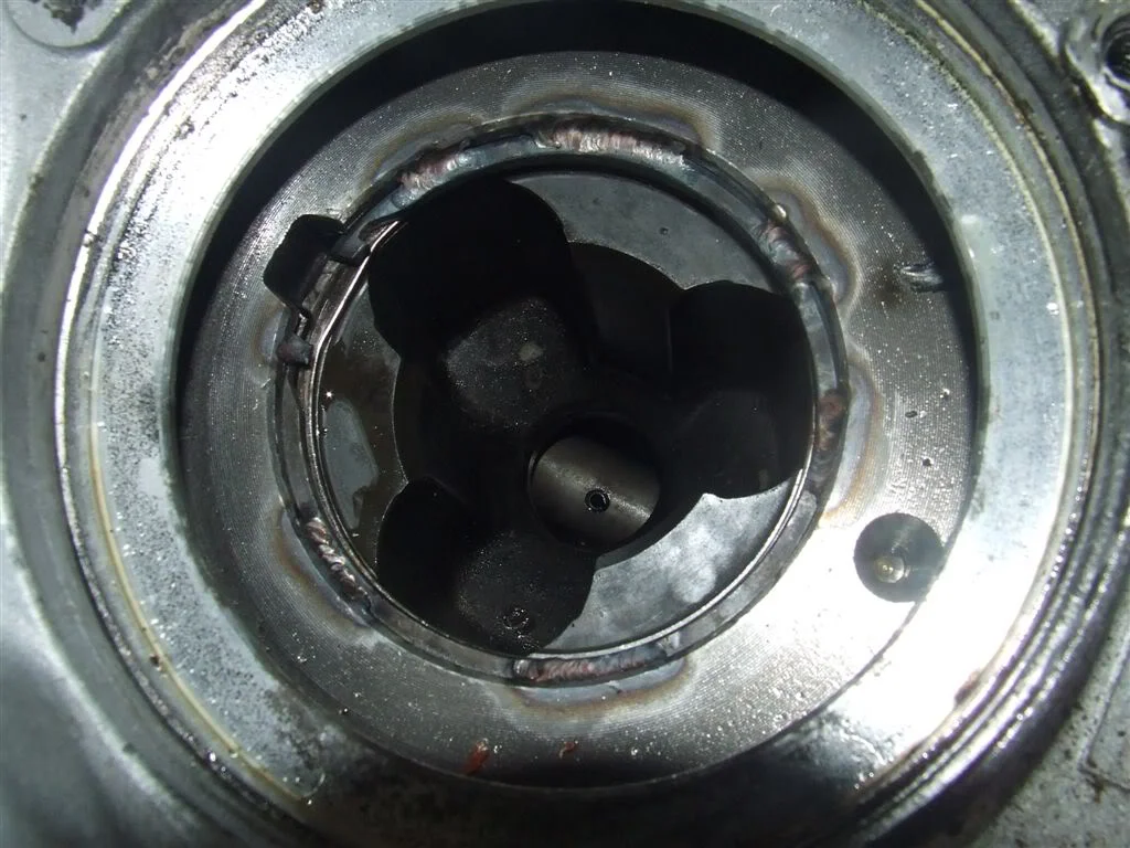

circlip going means one of the sunwheels in the differential can pop out, leaving you with no drive.
you can usually tell its the circlip and not the clutch/gearbox as you can select all gears without the use of the clutch but the speedo still rises accordingly
unfortunately, once the circlip pops out once, it creates a chamfer on the gearbox casing meaning that if you replace the circlip with a new one it could do it again! :(
renault eventually fixed this with the bolt in diff, but to retrofit one is a big job.
I got mine welded in
not sure if this is easily done with the gearbox in the car though :(
