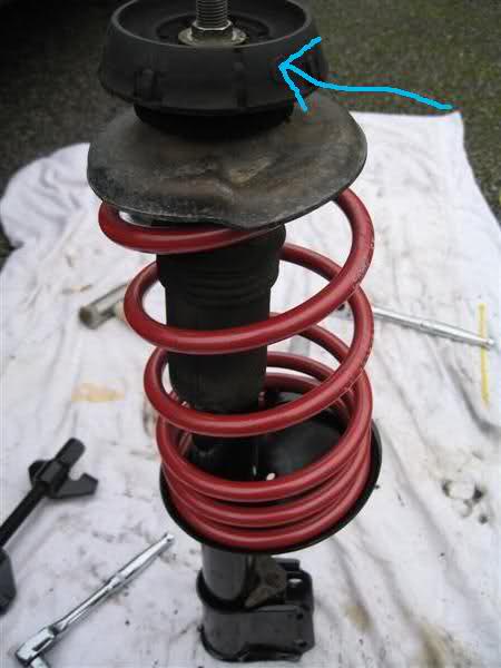

got standard top mounts, recently replaced the rubber and put that big washer in there to

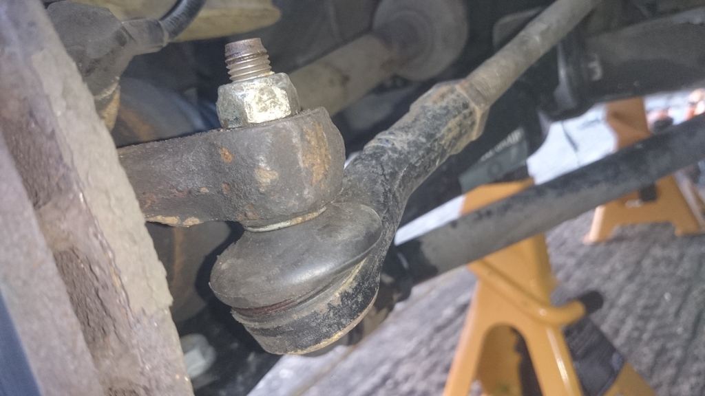

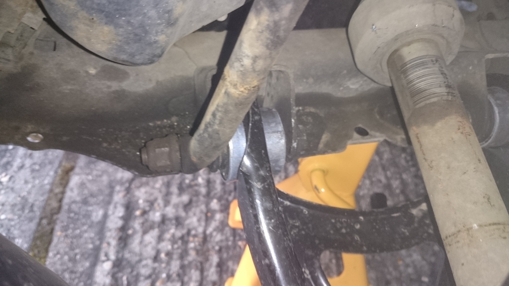

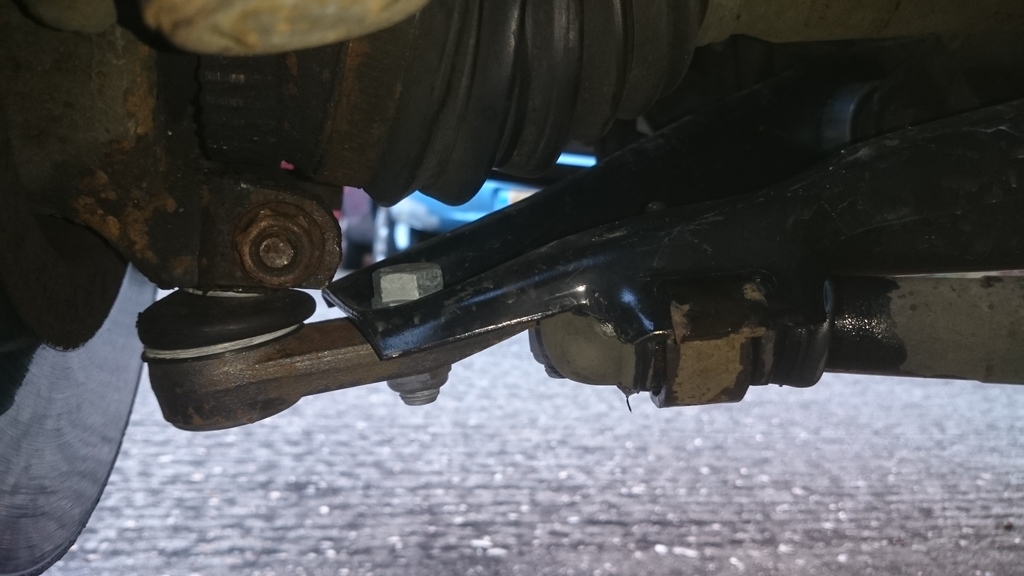

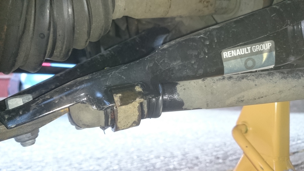

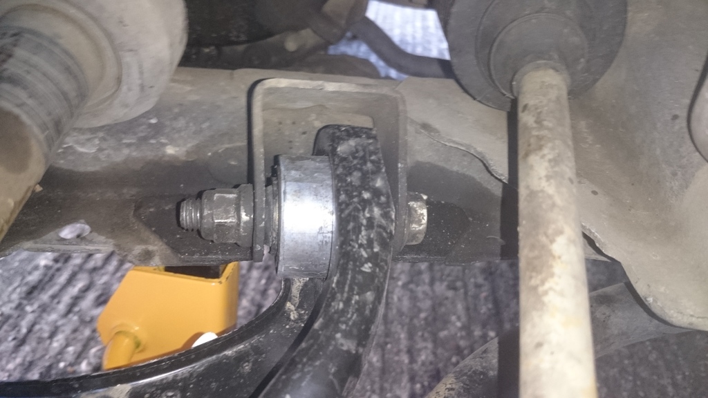

on the below photos of bolts is there anything to watch out for? are there any certain torques I need to watch out for? ive just done them all up as tight as possible?
  172
If it's not a top mount my money is on a snapped spring.
From the pics that lower ball joint looks brand new

lower ball joint?? I have just replaced the wish bone
