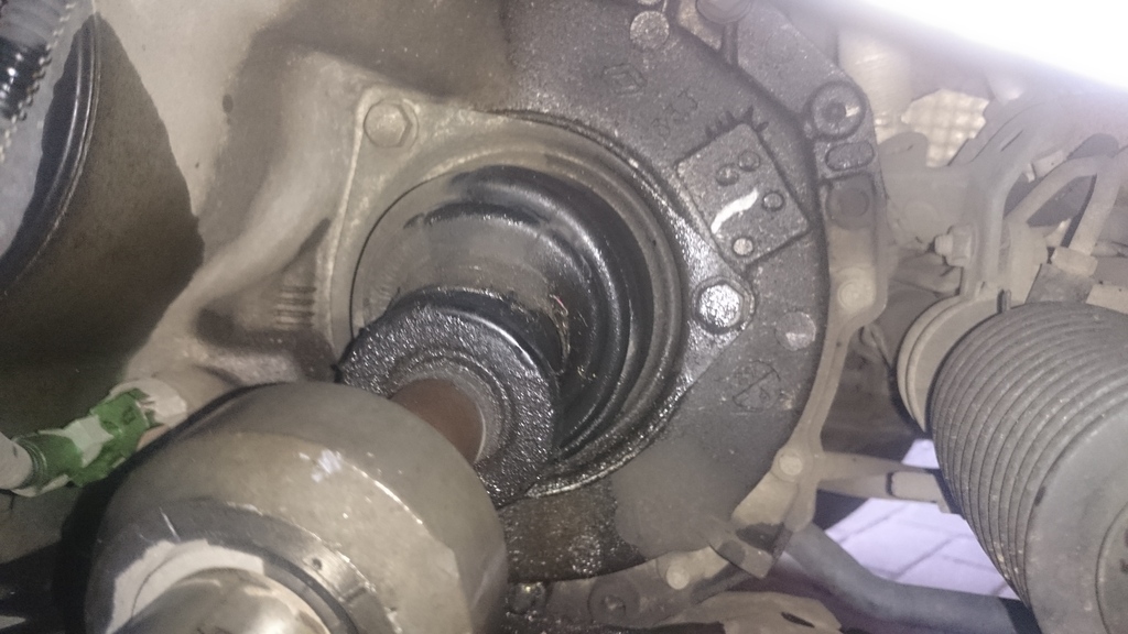

well all I have to say is what a total t**t I am!
after taking things to bits for the forth time I worked out what the donking was. I haven't done the pinch bolt up tight enough when doing the wish bone and the pin the coming out of the hole.
but whilst doing the bolt up I managed to empty the content of gear box oil onto the driveway, fan f**king tastic...
it got dark so couldn't check but this came off or broke
luckily alex was at the end of the phone to advice me, thanks mate
