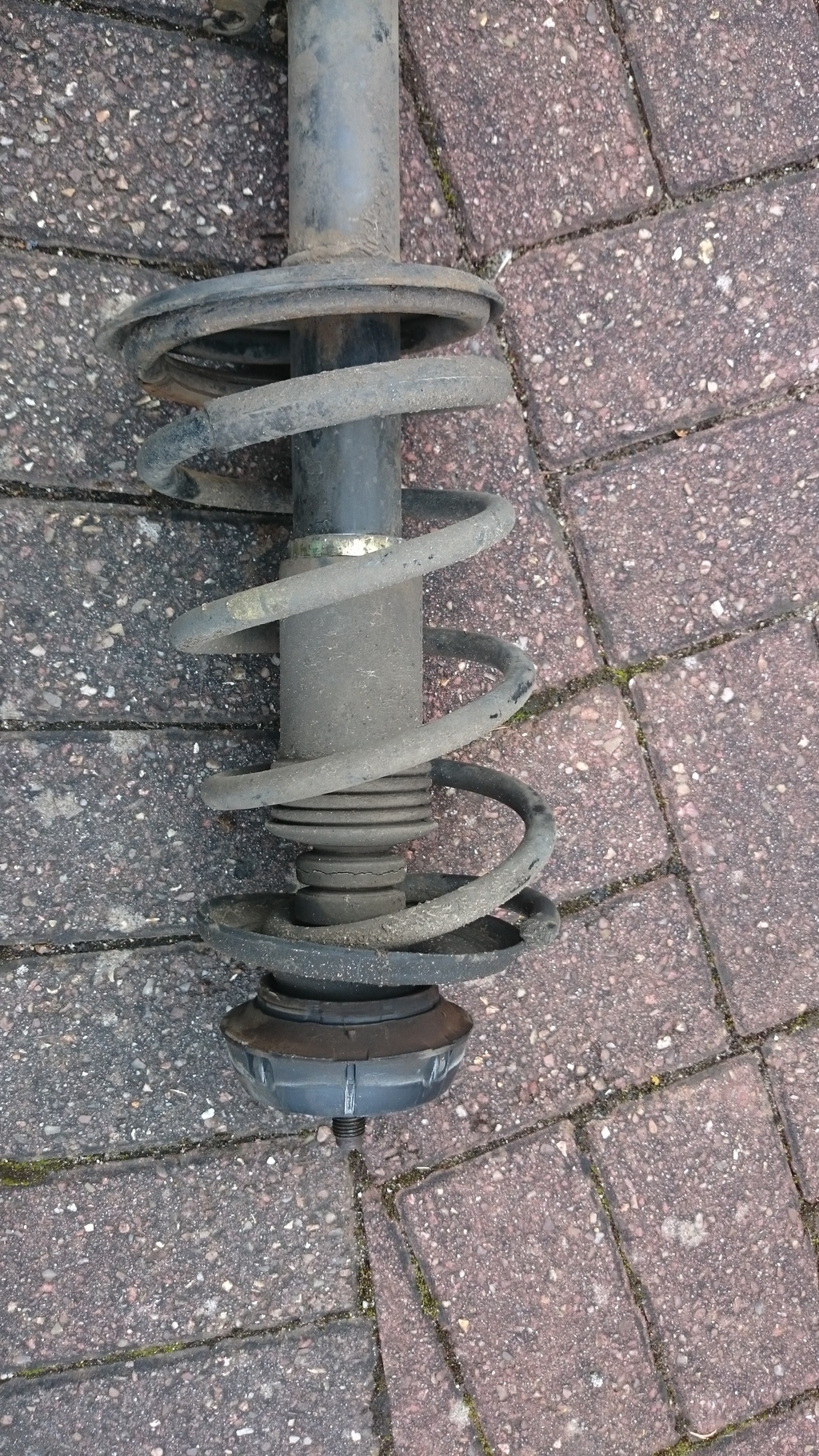

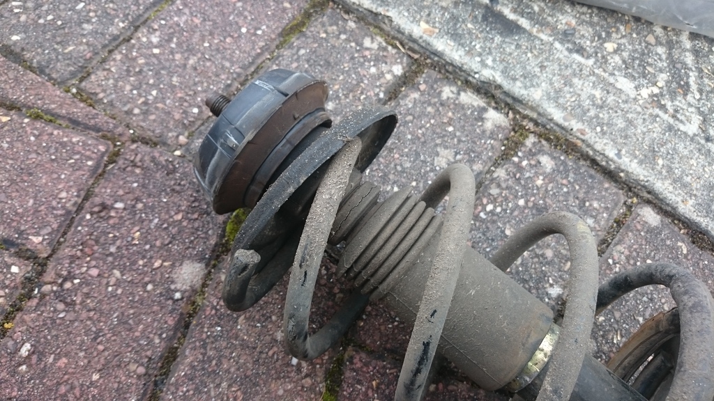

Ok taken things to bits and this is what I've got, don't think the spring is broken but has been dislodged.
Would people agree?

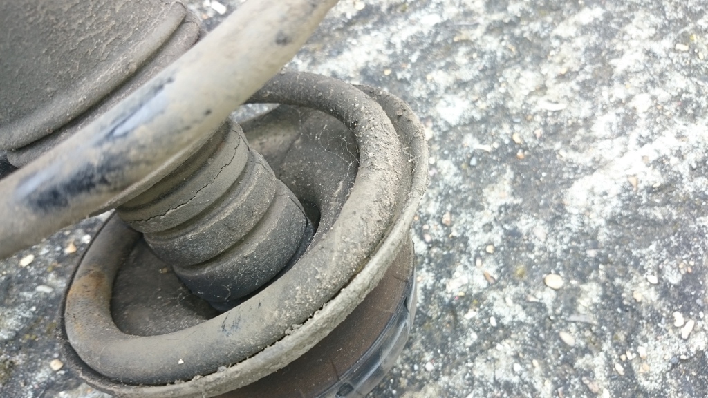

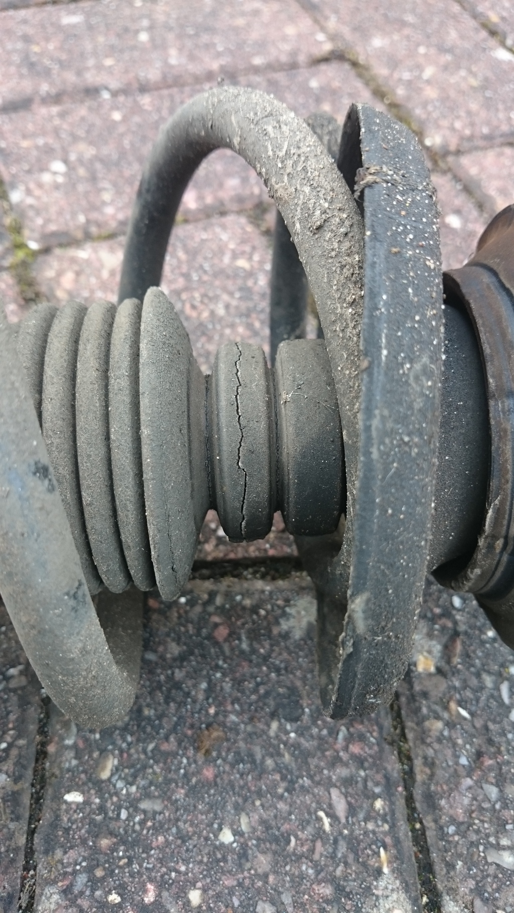

But I do have a crack here, is this a problem?

ok interestingly just driven the car and the noise is back so the spring must be working it way out!
what could cause this dodgy spring or dodgy spring cup holder thing?

Turns out the opposite side front had a crack in it too.

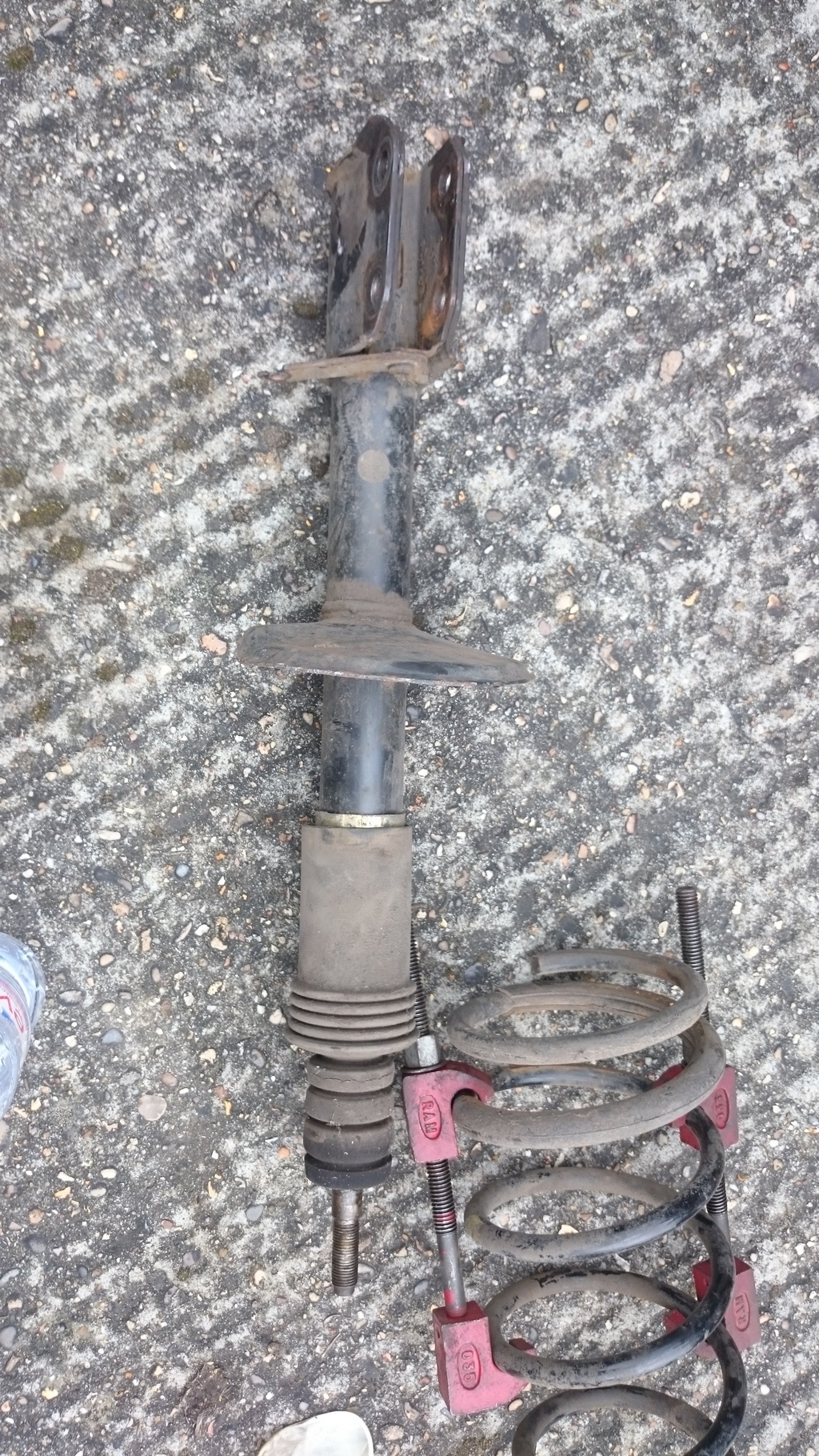

Looks snapped

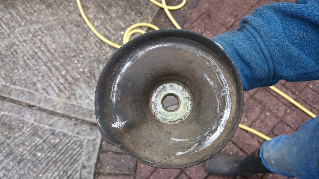

took everything to bits again yesterday as after putting the spring back into the cup it was still making a donking noise.
the top cup where the spring had come out of looks like this, its got lots of scratching around it -
where as the other side (drivers side) the top cup doesn't
so not sure where to go now? how do I tell if the damper has gone?
the spring is in its cup but still making noises, I know its the spring cos I can feel it through the steering wheel

That looks broke to me! Replace them both if you can.
Dampers usually look wet when they've gone, and if you bounce the car it'll keep bobbing for a bit after you stop.

Is the piston fully extended?
Damper looks knackered to me?!

Well the piston should be fully extended on its own
If you have to manually pull it up then it is goosed
Easy to tell

The top spring cap should not be internally scratched like that as its part of the total shock assembly.
The top cap is making contact with the rubber bearing holder on the underside of the suspension turret,so it cannot rotate with the spring/shock.
The likely cause is an incorrect fitment of the top mount bearing,a bearing failure or a mismatch of old & new genuine superseded components,that need modification to work.

the only part ive changed in the suspension setup is the rubber top mount and that's been in a year and not making any noises.
