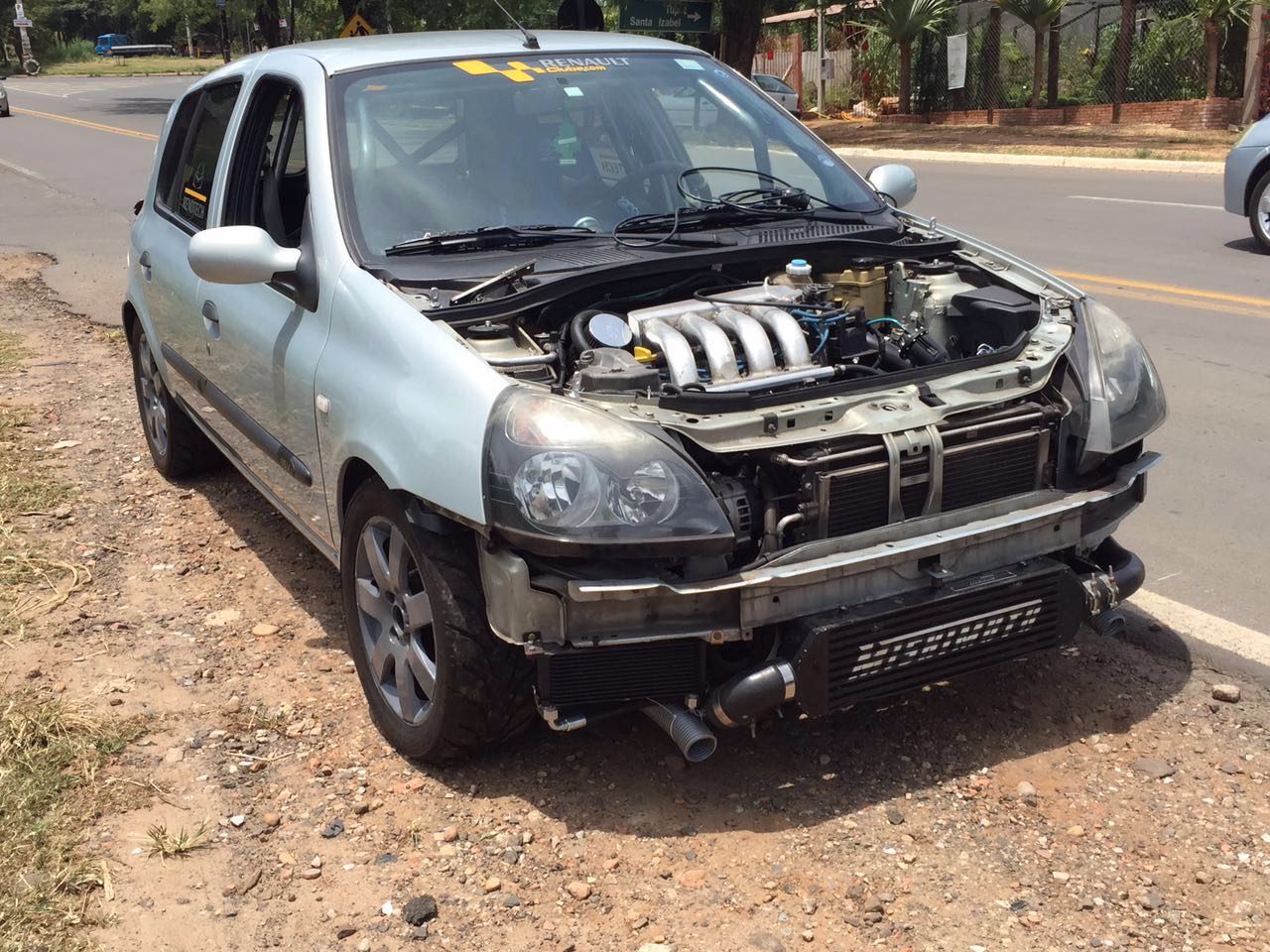

Just sharing, some pics of my project :hearteyes:
