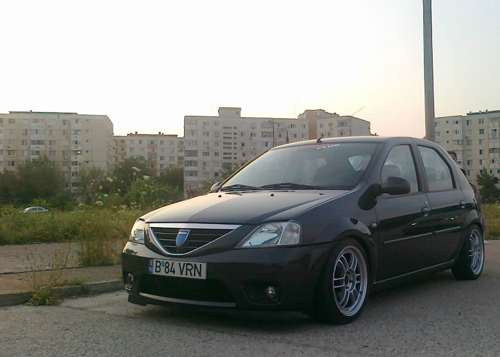

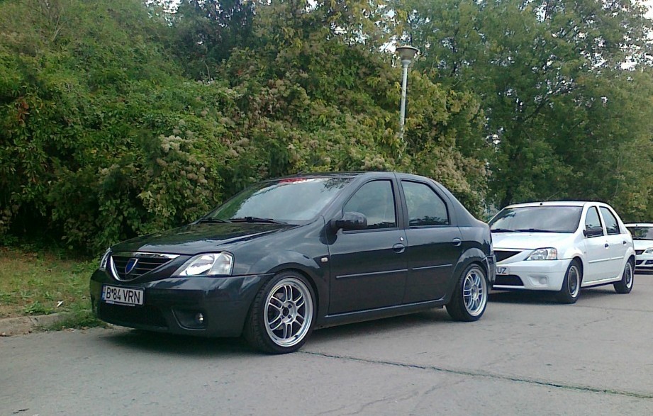

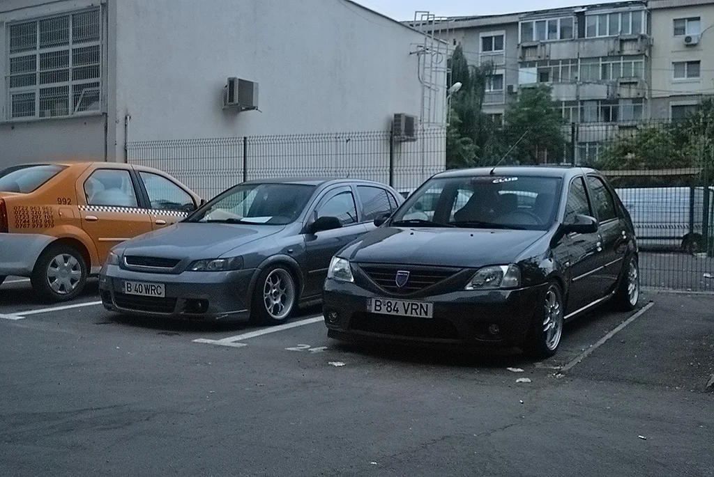

This is my 2006 Dacia Logan. All the underpinnings of the car are pretty much Clio 2, so I guess it's not that far from the theme of the forum. Mine has the 1.6 16v k4m engine which seems to be a pretty good base for tuning judging from what I've seen around here :)

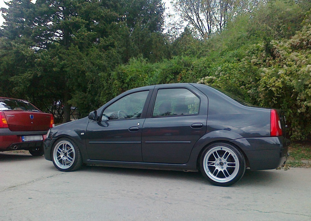

Suspension:
-"trimmed" ;) H&R -45mm springs
-reworked stock shocks, 25% stiffer.

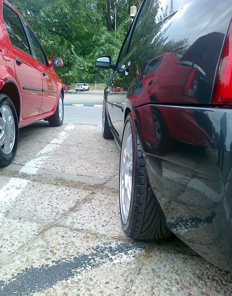

The H&R springs are probably the only springs that than bring the awful stance of the standard Logan down enough for it to look good. Despite the ratings, the car dropped 55mm up front and 65mm at the rear. This still wasn't enough though, so I chopped one coil form each spring.
I'm probably researching getting some Clio 2 coilovers and adapting them to the Logan. The front ones should be a direct fit as the car uses the same 58mm struts as the Clio, the only difference is the shape of the rear springs. Never got a chance to measure them and see if the springs will fit though.
Wheels:

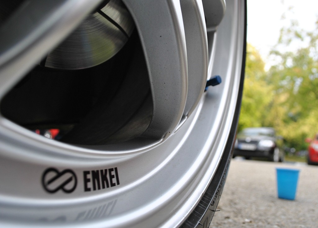

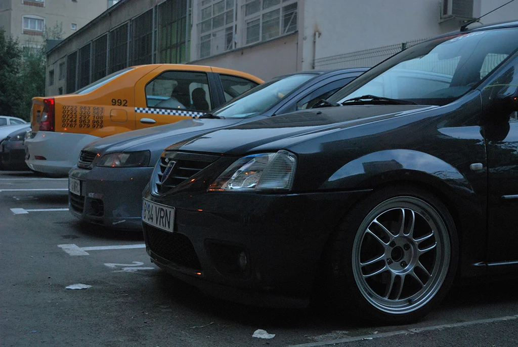

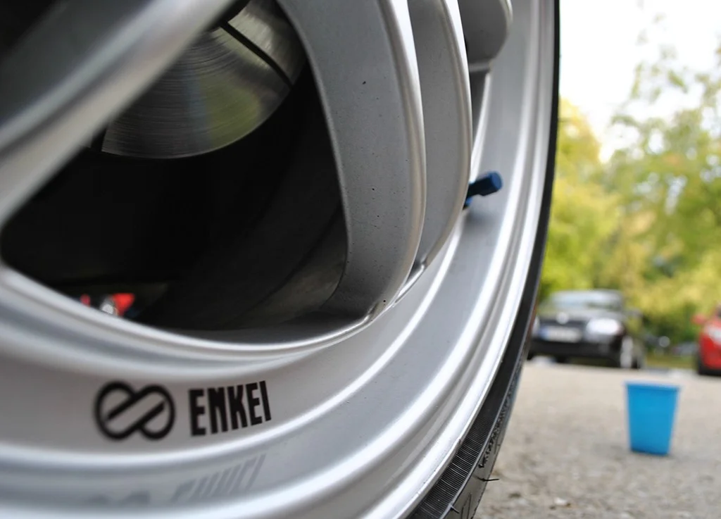

-Enkei RPF-1 17x7 ET 43 with 25mm spacers / front and 35 mm flange / back
-Toyo T1-R 205/40 R17 tires
-stud conversion
Another problem with the stance of the car is the fact that this car is wider overall than the Clio 2, but uses the same rear axle. This coupled with standard ET50 wheels means the car looked like an elephant on skates.

Could you have not got staggered fitment on the wheels, i.e. wider at the back? Anyway, certainly go for coilvers over chopped springs! Could do with going a bit lower...
Going to de-badge the front grille? The Dacia logo is massive!

Needs the chrome from the front bumper removing though. not keen on that.
True that! The car needs a full respray anyway, the paint has seen a lot of abuse over the years so debadging and removing the "chrome" will be done then.
17" RPF1s are only made as 7" wide for 4x100 fitment :(
I could have gone with 16x8 for the same price and weight, but for some reason I didn't. I kinda regret it now.
And yes, it's not low enough ;)
I hate the size of that logo, but Renault seems to like it, the made the one for the facelifted version even bigger. Looks like a damn bottle opener now! It's hideous! :banghead:

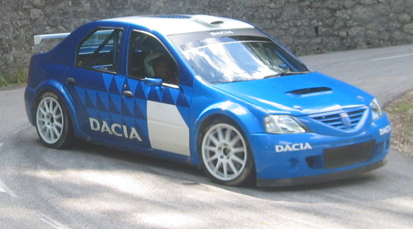

...as is the rally spec one above in Mick's vid!
Chopped springs on standard shocks though?!
