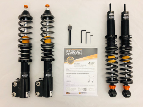

My ast 4100s, brand new 110nm rear springs and 90nm springs when I sent the rears off for full service and valve. Come with 400lb F+R springs also. Cheaper than both those setups.

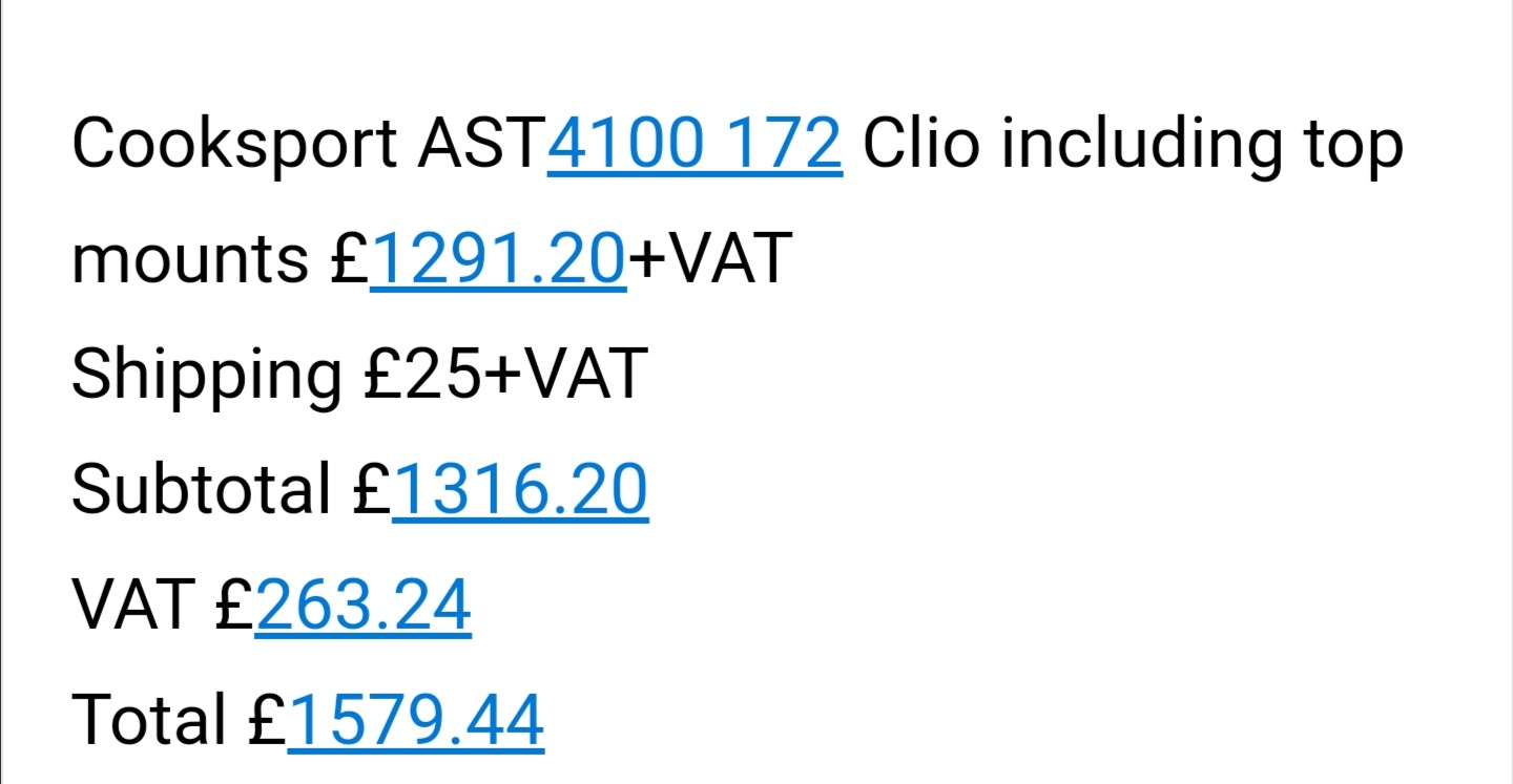

Cook sport have ast4100 for £1200
I'm on AST5100 with 80nm all round.. Trailered to the track.. Ilya is running the same but 90nm front and 110nm rear.. i feel i have a bit more flexibility when adjusting for wet/damp conditions.. We have our cars setup quite similar and definitely in the wet conditions mine handles better having a softer rear.. In the dry then obviously Ilya was quicker than me (turbo'd) but id say we are evenly matched in the handling department.. A stiffer rear helps the car rotate and dials out understeer.. a softer rear is safer though and not so twitchy..

Are they only £300?
Out of stock now, did you buy the last set!? I hope they get another batch in at that price in the future.
Hmm. Mine are 182 60mm £1200 + £20 delivery all in
