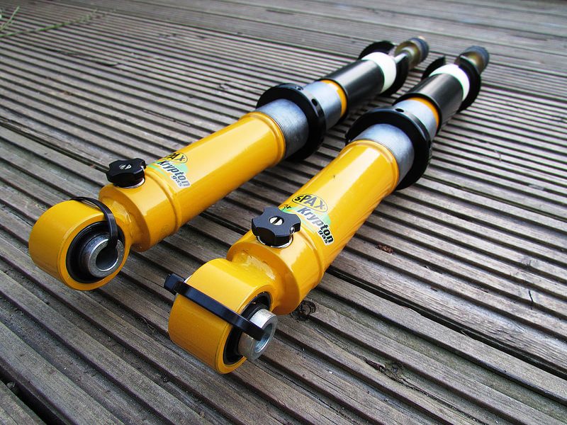

New rear units delivered to me this week
. by Ricard o1, on Flickr
I have the Spax RSX set up with this new style rear struts, note that these, dont use helper springs and have 3 lowering shims...on mine I binned the lower shims and used shorter springs (9'') to retain the helper. I am using 400lb rears with this kit and the 342lb fronts. which is too soft, but im in the trial and development phases of racing at the moment, to see what works for my driving style.
I think a good start would be 400lb all round, maybe then uprating to 450s all round, then when you get a feel for the car, adjust, i.e stiffen up the rear to suit driving style.
Note that the spring rates suggested are for the Spax coilovers.
p.s the new rear struts are leaps and bounds ahead of the old units. Note, that these cannot be re-valved (unlike the fronts) as they are a sealed unit.

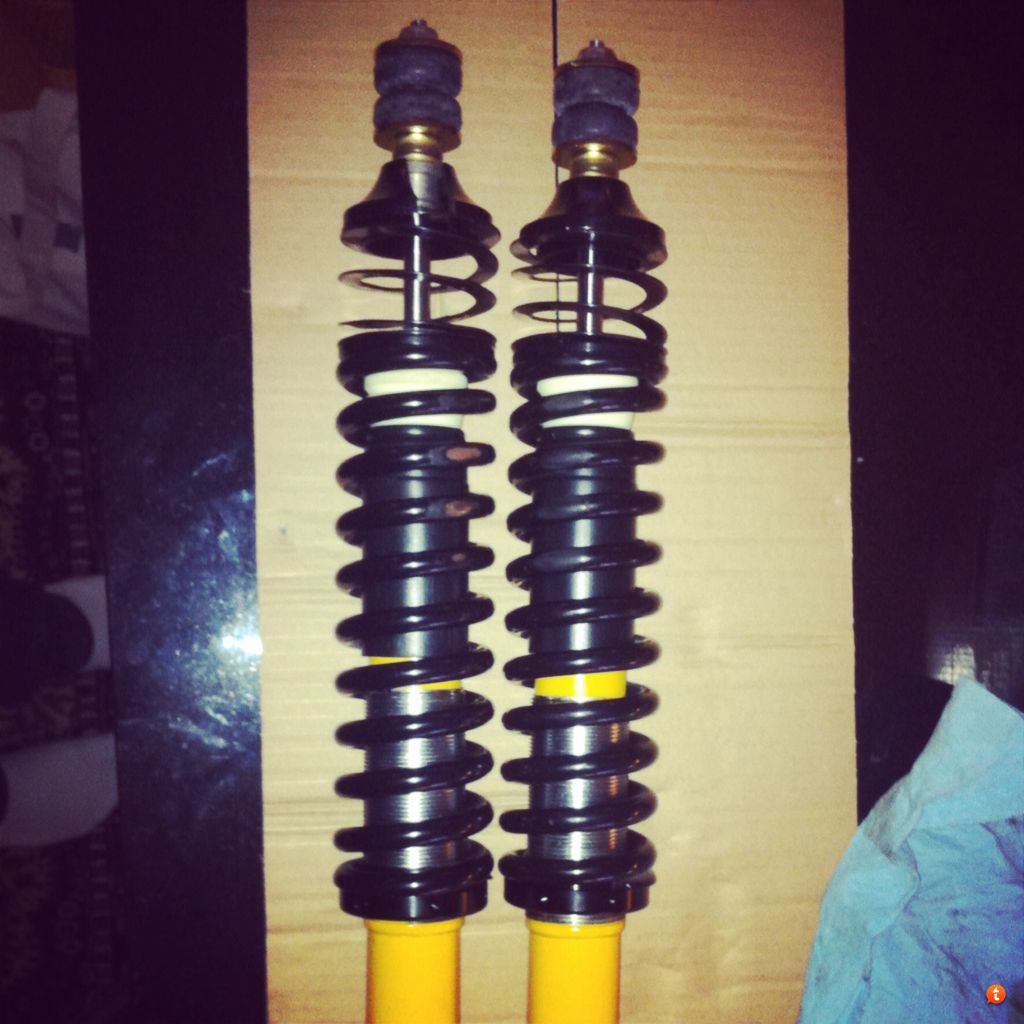

Where did you get the springs from? Spax direct? Thx
Any 1.9'' spring will work, the standard Spax springs are way to long imo they hinder the ability to lower the rear of the car to an ideal level. I got the rear springs from Mark Fish which I think is the Faulkner items.
I have the 11" Spax springs and will order the 275lbs Faulkner springs, do you think i should stay with the same length? I only ask as you've mentioned the 9". How mine sat with the 11" seemed ok ( approx 20mm higher than arch line) but would like the option of lowering the ride height a bit, will the 11" be ok to do that? I didn't want to compromise the components.
Might as well drop to 10" or 9", you can still adjust the height of the collar to original height. I found that the rears could not go low enough, and btw im no stance queen, the car is used for racing and isn't actually that low in terms of whats on here.
This is my set up (minus the height spacers).

Newer style rear struts?? What's the difference between yours and the other rear struts, I bought my kit last year so I'm guessing that there the older style ones. What's the advantage with the helper spring on the rear, I have them on the front just not on the rear?
Daniel
The new struts ( i say new they may have come out last year) have a slightly thicker piston, dust cover, larger rubber mounts and the shims. The Spax tech when I spoke to him said they are also valved go up to a next spring rate, these are very similar to the Spax race rears that are controlled for the 750mc club (on ktec website). Helper spring is to stop main spring rattling when uncompressed.
I purchased my Spax in 2012 and the rears was pathetic in comparison.
My 1st set of RSX rear coilovers were purchased in Feb 2013 and didn't have helper springs only the 225lbs 11" items. They lasted about 11k and less than a year so Spax sent me a pair of new dampers under their 2 year warranty.

We tested, tested, and tested some more, we were lucky to get a box of springs from Curtis at AST, and just kept trying them, all with different camber and toe settings.
Suddenly the car felt good, very good, we didn't even look at the final spring rates, as the car felt epic, that was good enough.
Flat through Craner Curves at Donington was good enough. :)
