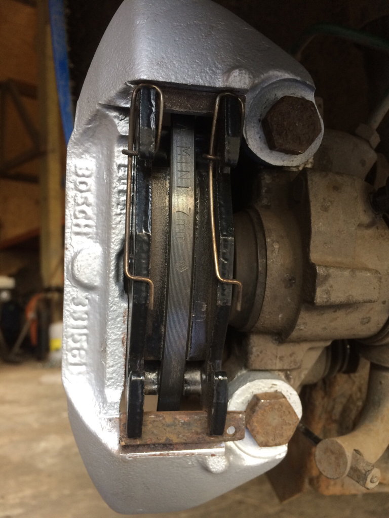

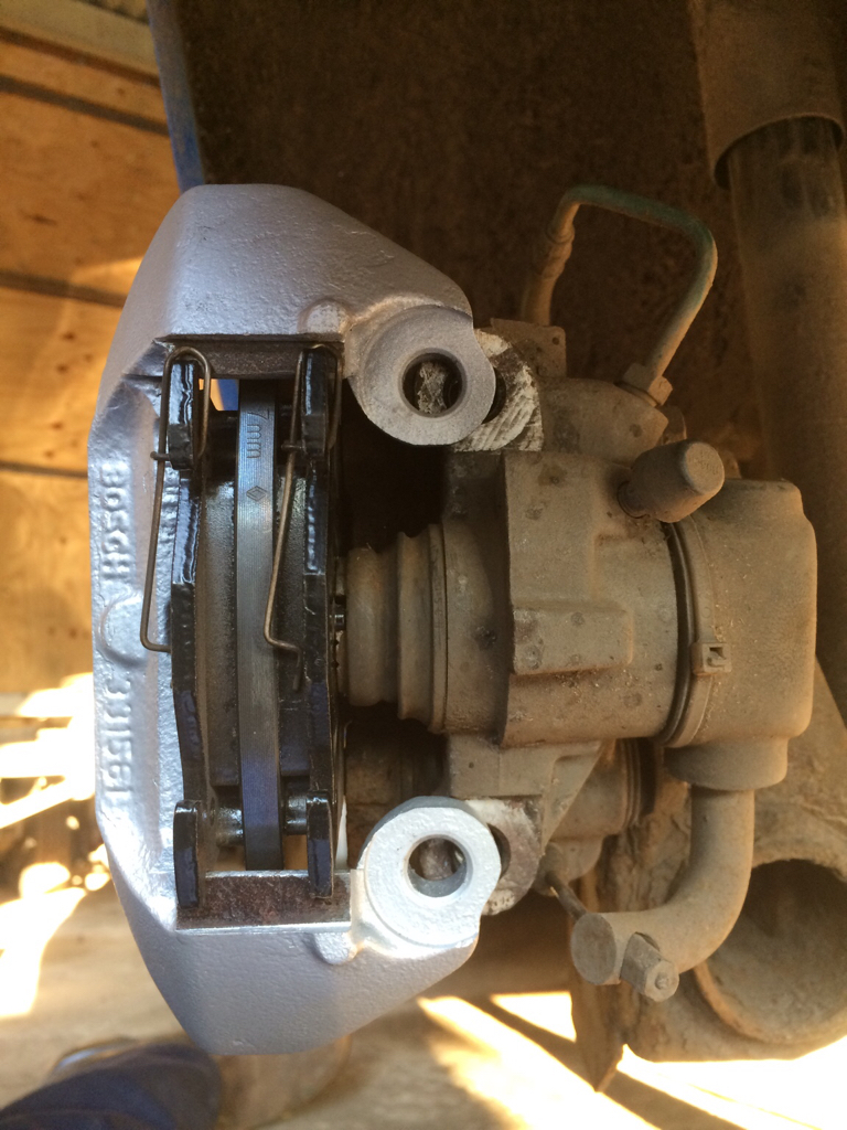

Offside is back together perfectly, got to the near side and this is as far as I can get...
Yes I've wound the piston in (clockwise) as far as it'll go...
There's no way I can bolt that carrier back on!!!
Yes the handbrake is off.

Thanks for your quick responses... decided if it was Fubar I'd try a little harder before a new calliper. Removed the boot, cleaned the piston and y pushing and turning (a lot!) eventually wound it in after all.
feel a bit of a numpty but job jobbed.

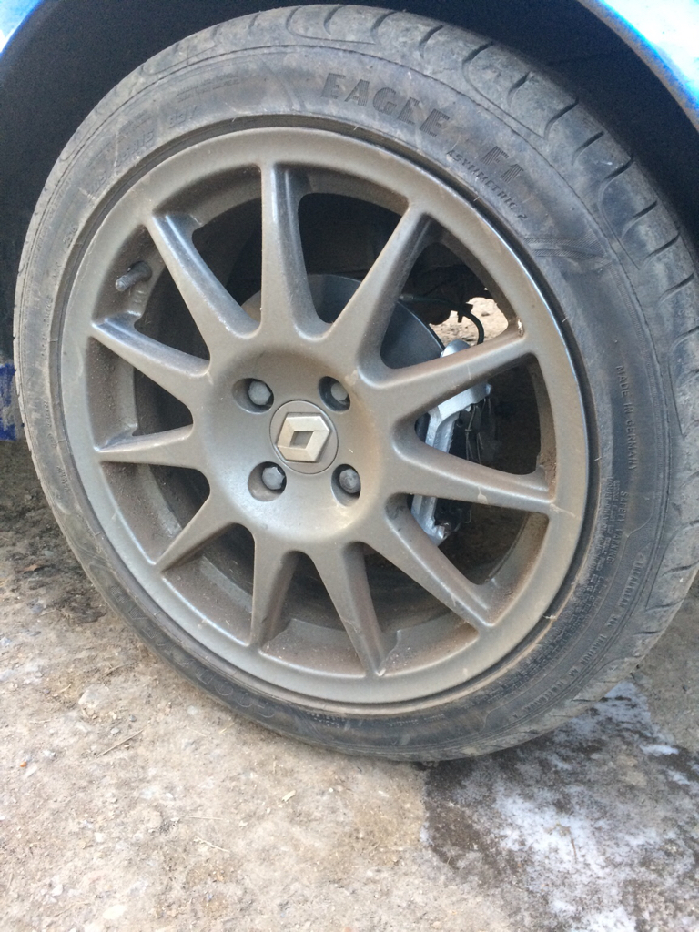

Now she needs a good wash to show off the time I put into cleaning & painting!
