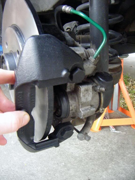

lee131 Car Breaking mk2 DCI Jul 27, 2009 #1 right my pass rear brake line that goes to the caliper as pictured(green to black one) is almost worn through, where can i get a braided replacement?

DrR ClioSport Club Member Car VW Golf GTD Jul 27, 2009 #2 Which?? The green one or the black one? Just get a standard replacement, don't think there is a braided one for it.

B bmh.01 Car BMW M135i Jul 27, 2009 #3 There isn't and theres no point as the rears don't do anything anyway.
B bmh.01 Car BMW M135i Jul 27, 2009 #4 Passenger side is 82 00 113 855 and £25~ Drivers side is 82 00 133 856 and £25~

B bmh.01 Car BMW M135i Jul 27, 2009 #6 You could do but i'd want the flexible part in personally, those are deffo the part numbers. Dealers assumed/can't be arsed to look.

B bmh.01 Car BMW M135i Jul 27, 2009 #7 Ignore the drivers one above should be: Drivers side is 82 00 113 856 and £25~

lee131 Car Breaking mk2 DCI Jul 27, 2009 #11 bmh.01 said: Ignore the drivers one above should be: Drivers side is 82 00 113 856 and £25~ Click to expand... YOU THE MAN! Thanks, will check passenger side later too, it wasnt clipped in place when i got the car so there lies the culprit, im just gonna go cable tie mad!
