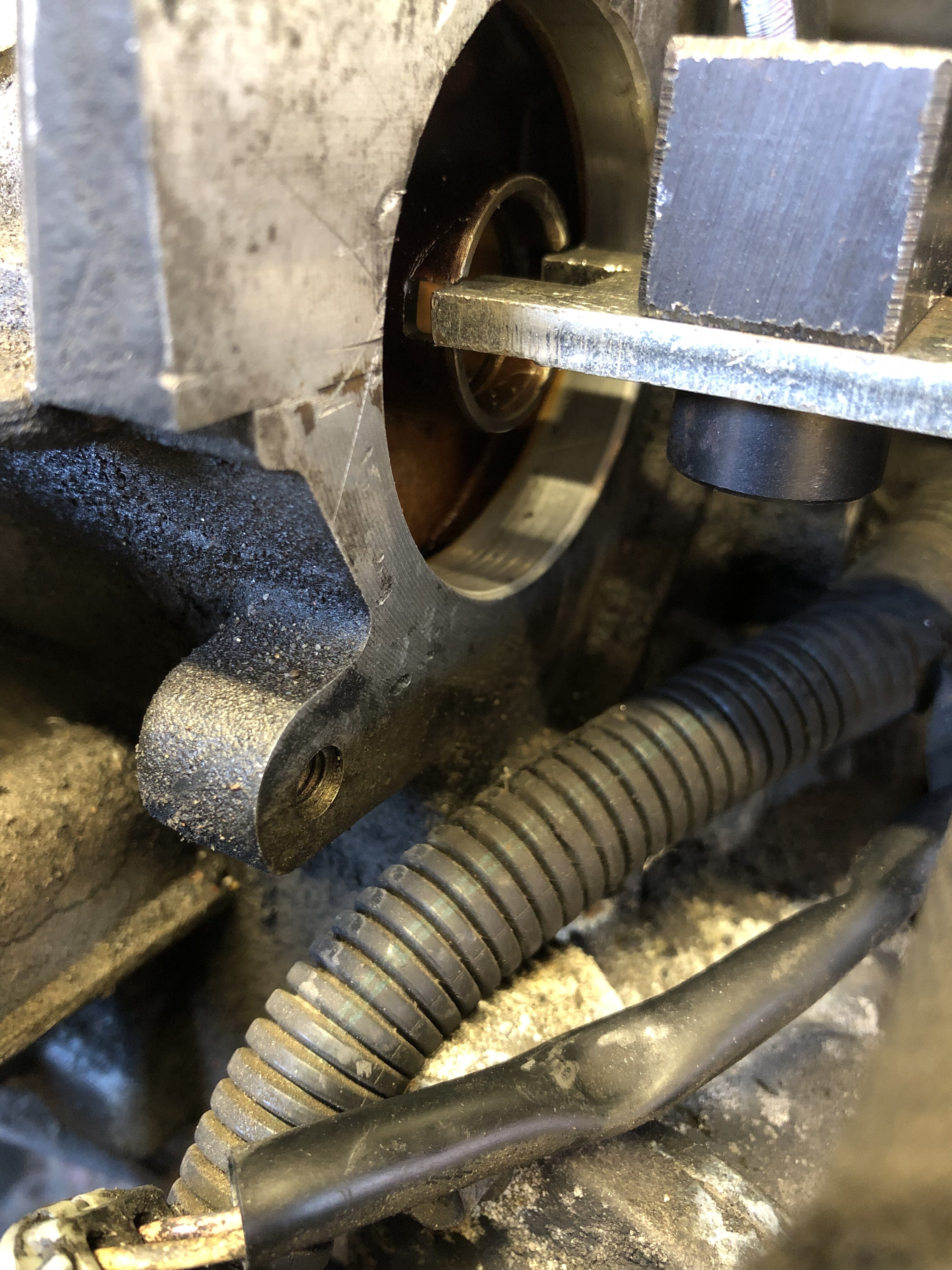

Ive done/doing the cam belt change on my 172, this the second time I’ve done it, using the gen tools. Im struggling to get the horse shoe tool 2 slide into cams nicely, it will go if u force it! But it’s p**sing me off because it was spot on when I started. I’ve gone bk through the motions 3 times now & can I f**k get it 2 slide in any ideas?? Or will it b ok as is??
Cheers

That's not far off at all is it 😅
I'd probably be ok with that.
🤣 no it’s not, it’s just p**ing me off because it slid in 2 start with!, I’ll live with it then & rebuild it cheers mate 👍🏻
  R5gtt, 182, volvo...
I imagine you’re running the tension off the belt, locking the pulleys.. shoe in, then going full torque on each cam in sequence.
Instead. The front cam tends to rock anti clockwise and the rear rocks clockswise creating tension before you even start.
So.. Lock the pulley tool, take out the horseshoe, tweak the front one up (clockwise) using the cam tool as a spanner and nip up the dephaser pulley, then lightly tweak the rear down/anti-clockwise and nip up the exhaust pulley.
Now when you put the shoe in it should rattle around like the videos and slide about, if not un nip the pulleys and go again until they’re totally at rest and the shoes rattles when the exhaust and dephaser are just nipped up. If you get that right you’ll rip the exhaust and dephaser up to torque first time and it’ll be perfect.
What normally happens is as you rip on the pulleys in sequence to full torque one moves and throws it out, partly because sh1t happens, but also because the pressure hits the shoe before you complete the sequence. Easy as peas.
