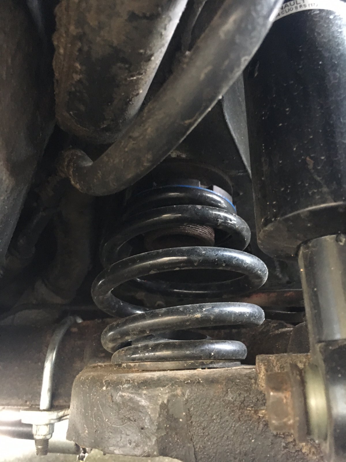

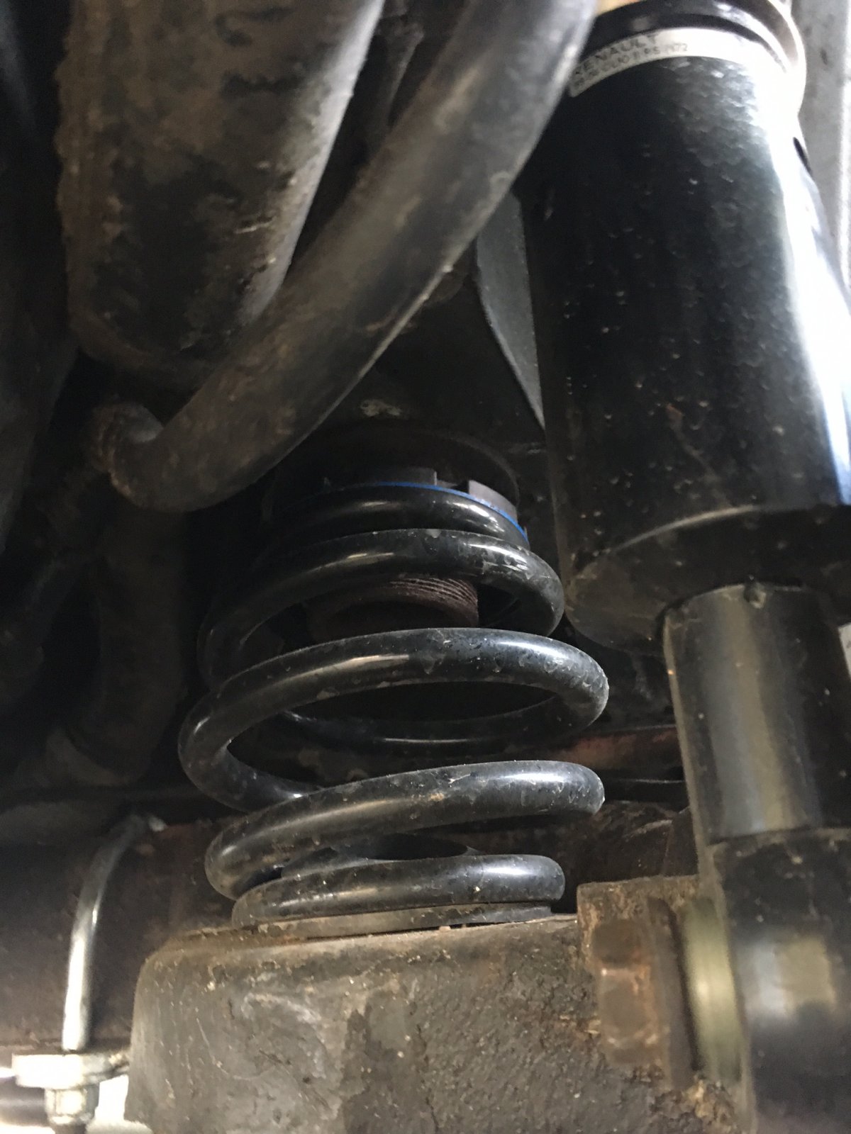

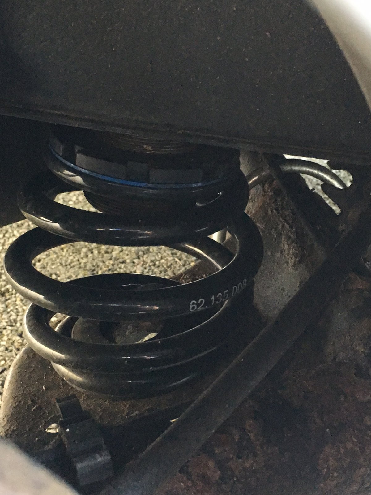

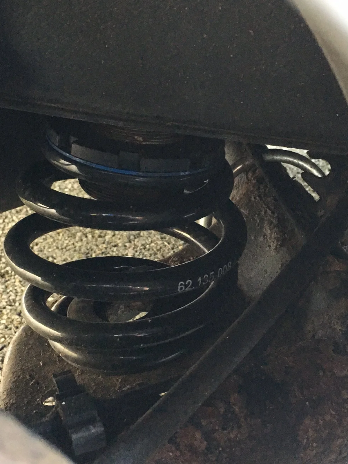

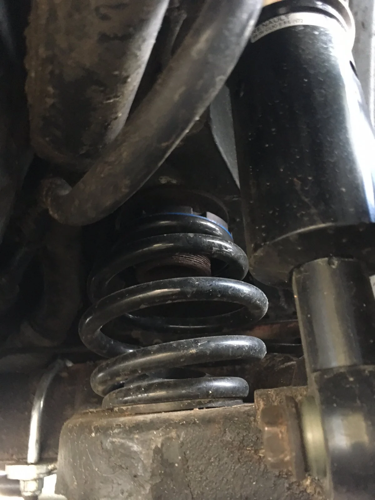

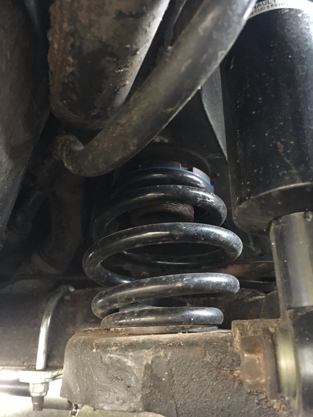

Sorry for the delay, here are the rear BC Springs in Situ....PLEASE NOTE I AM USING THE HEIGHT ADJUSTER FROM THE BILSTEIN B14 KIT FOR THE REAR.
