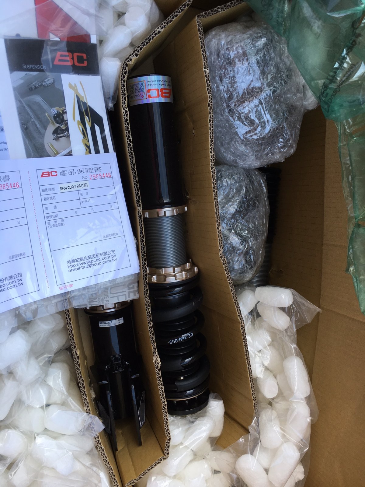

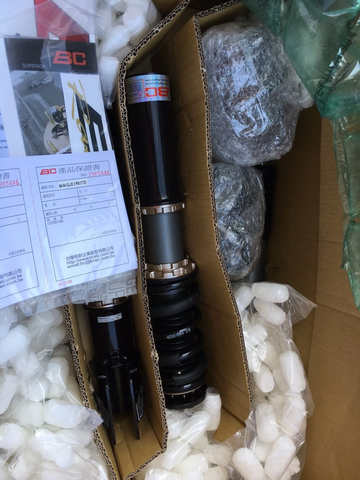

Quick update, I have just received my new BC racing DR kit with 9kg front and 8kg rear springs after the advise I received from this thread so thanks for that, the kit looks great, the only concern is the rear height adjustment, I was under the impression the kit was fully adjustable at the rear however Kam racing said the only adjustment was using the spacers for the springs, it looks like on the shock itself you can adjust the height however Kevin from Kam explained not to do this. Does anyone have any experience with this?

Adjust the height using the spring perch iirc. The adjustment on the rear shock might be the set preload height.
Yeah it was the rear I am talking about, I understand the front end. I will go for the larger spacer at the rear, just to confirm the spacer goes on the bottom of the spring?
