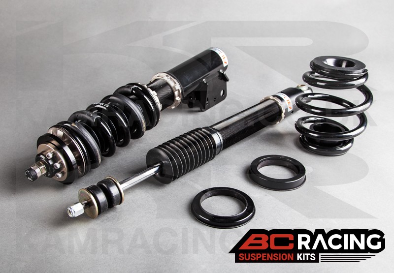

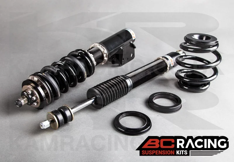

Is it an issue that the BC Racing DR rear shocks do not have the spring as one unit like the GAZ Golds - I have been told there is rear adjustment to stiffen up the shock
@JamesBryan does that mean all 4 corners can be corner weighted with the BC's? I though it needs to be a full coilover set for a full corner weighing set-up?
It can be yeah. The cornering weigh setup is done by moving the weight around using the height adjustment.
So making one wheel lower will reduce the weight on that wheel and making it higher will increase it's weight. This also affects the opposite corner to which you are adjusting.
That's the RSX kit out the window then. The BC DR kit is only £866 with adjustable solid top mounts, versus the KTR kit with top mounts at £1200. BC DR's it is then, just need the best spring rates for my situation now, track car driven to and from track with the odd weekend blast....8/8?
8kg/8kg would be a good start. That's 450lbs all round.
If you wanted the similar rate on the front as the 182 Championship Spax ones, then 750lbs equates to 13kg!

13kg would be to much for a car driven on the road you'd think. Will go 8/8kg and take it from there. Just need to find £800 now, lol.
