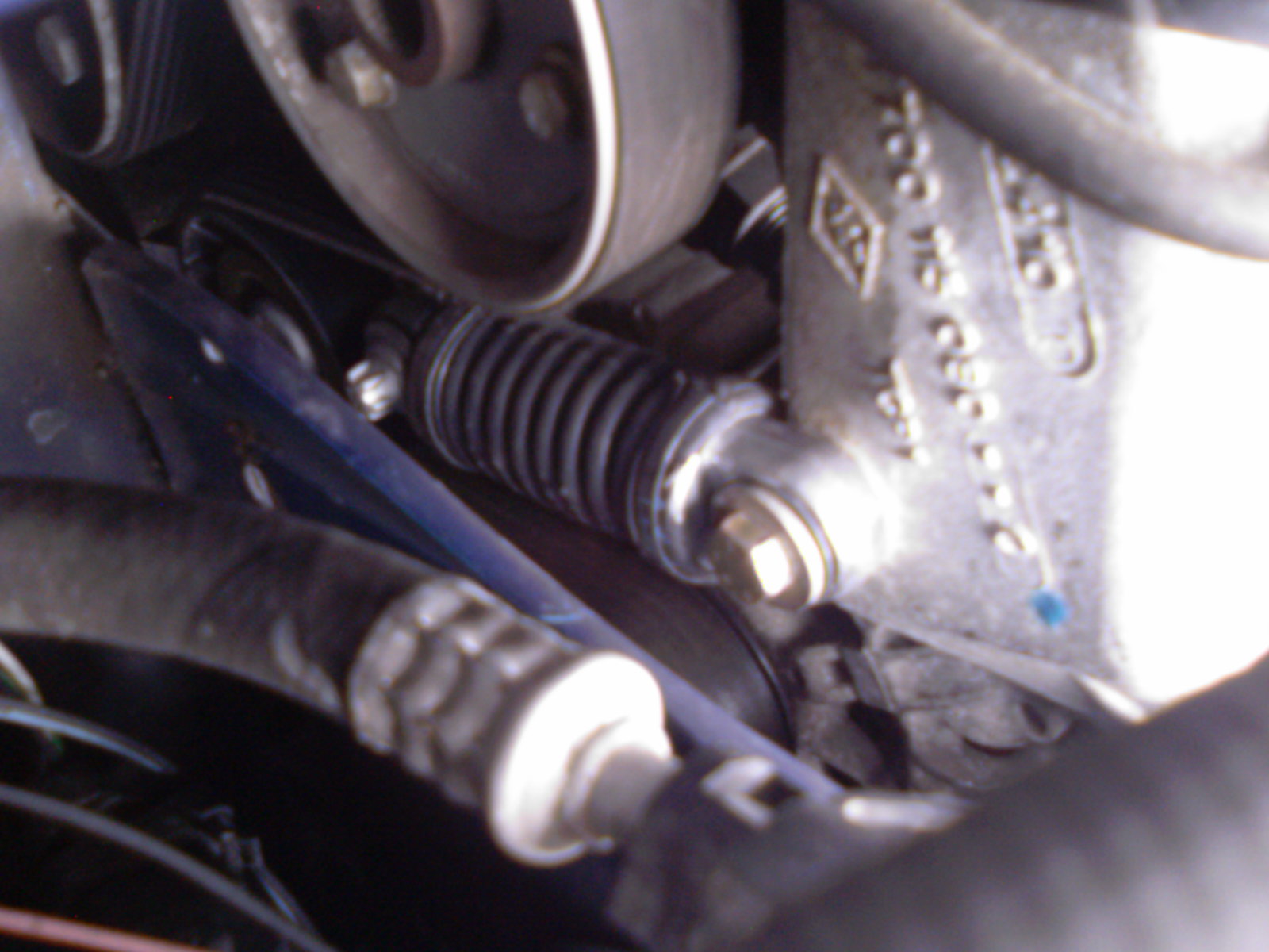

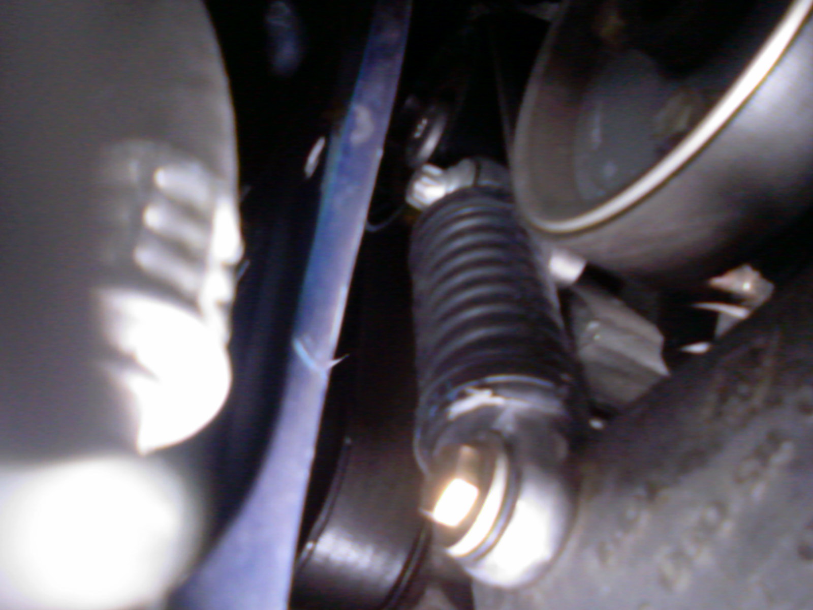

take it the tensioner is the thing that looks like a rod with a spring on it. sorry to sound stupid not that good with engines
is this the right thing and does it look new to you sorry to keep going on but need the car right.
