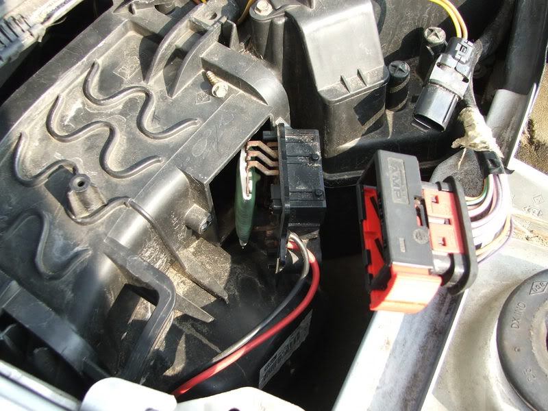

Its dead easy to get to it, look at the guide I wrote on changing the pollen filter.
The fan is in the housing next to it !
http://www.cliosport.net/forum/showthread.php?t=223024

The Haynes is wrong, as it doesn't cover the Sport models. The panel on the drivers side comes off as I have described.

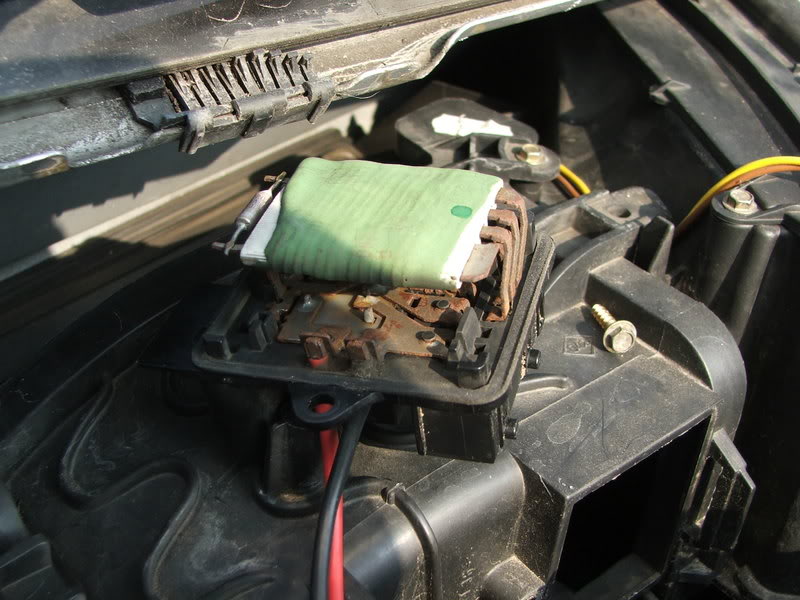

Its almost certain that if the fans not turning, its the resistor pack that has stopped working.
I have successfully repaired a couple like the one I have shown below, but replacement is the only way if its the sealed can type. They cost £87 from Renault and a fan motor is £80.

Is there a way to check if the resistor pack is broken? I see from your pics it looks easy enough to remove. It looks to be a fair bit harder to remove the fan itself though as some bolts are quite far back.
Also I saw 2 sets of wiring (that are possibly not related to the fan). There is that block of wires that are visible on your pics (with the red clipping mechanism) but there is also a 2 wire connector which I guess connects to the resitor pack. Is this the only electrical connection to the fan? If so I could easily check I have some kind of voltage going to it.

The two wire (brown/yellow) connection is for the stepper motor that activates the re-circulation flap. Check it by getting someone to press the recirc button while you look inside the plenum.
The red/black wires go to the motor.
If you'r resistor pack looks exactly like that one, you can test if the fan motor is working by pulling the plug off and shorting out the two black wires
The fan will run at full speed.
Look at the small silver pointed object on the top left of the resistor pack. That is a heat activated fusible link. Stick a meter across it and see if its blown (ie open circuit) if so you can do a temporary repair by soldering a 30 amp fuse in circuit till you can replace it.

The resistor pack is a transistorised chopper circuit rather than resistive components type, If thats gone wrong, they are expensive.
