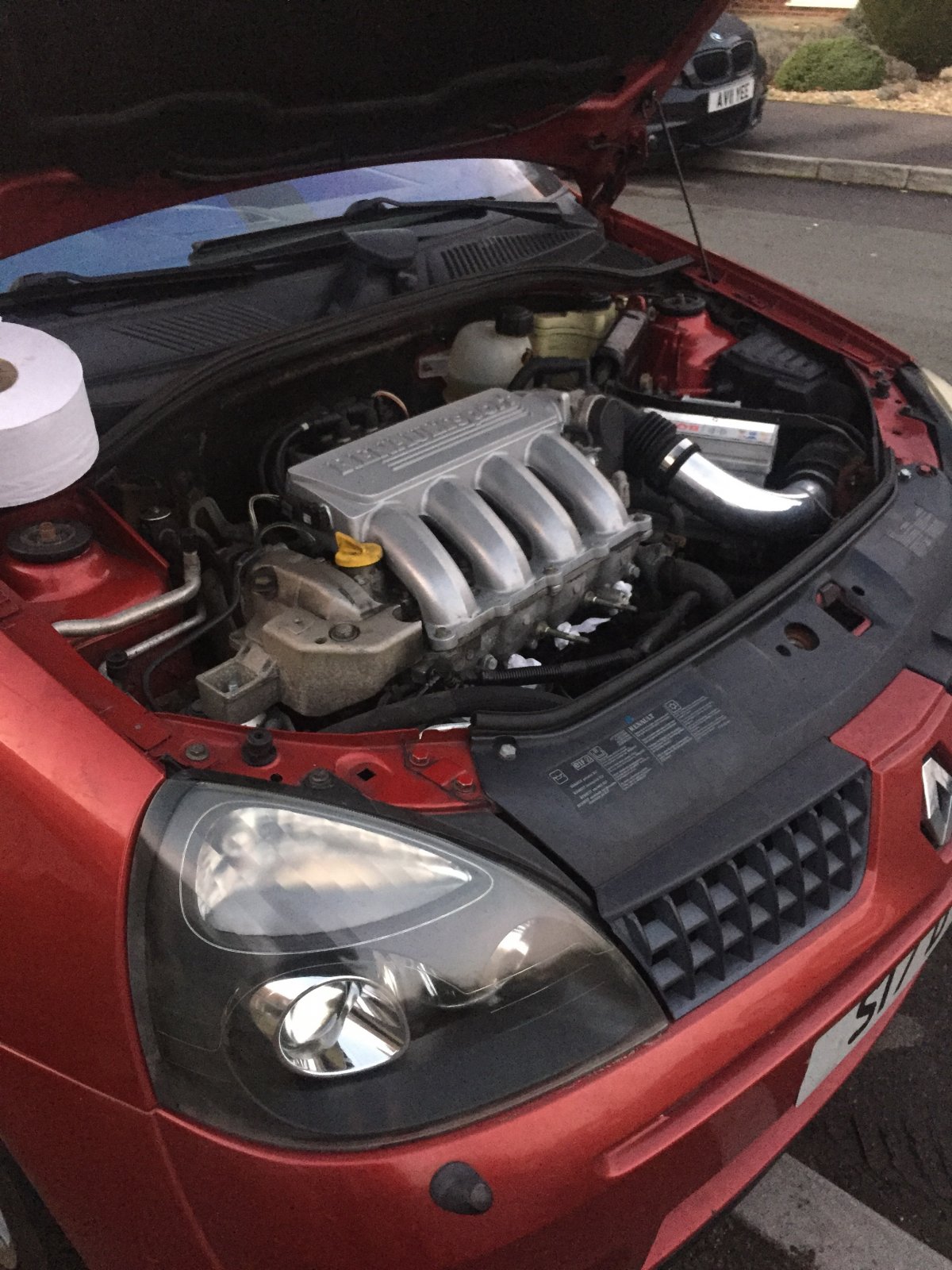

Struggling to get the feed off, it just won't pull! And I'm scared of snapping something else.

Done step 1, I was trying to pull the tube off, I didn't realise the plastic bit was like a release.
  330i. E30 Touring.
So removed the feed, undone 2x10m bolts. How do I undo each electrical connector bit mate?
There's a spring clip on the underside of the connector. Push that in, and slide the connector off at the same time.
  330i. E30 Touring.
Next step is to remove the rail. Pull firmly as you angle the rail down and the injectors will come away from the inlet. The o-rings will be tight and horrible to get in and out..

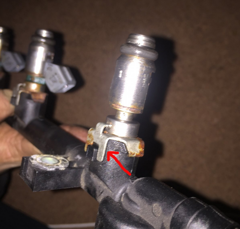

Hmm, it isn't coming away. A mechanic friend is coming over tomorrow eve so hopefully he can do it.

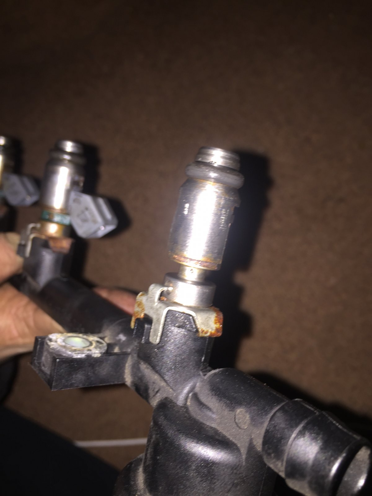

Does the whole metal clip bit at the bottom come off with it? Would be easier if i had a new one to refer to.
