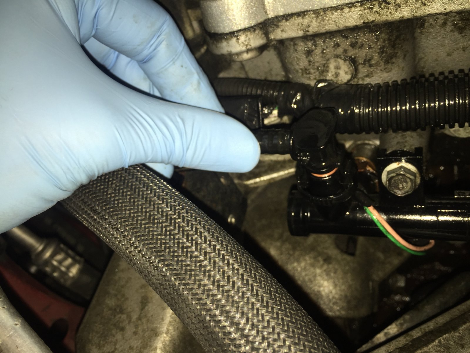

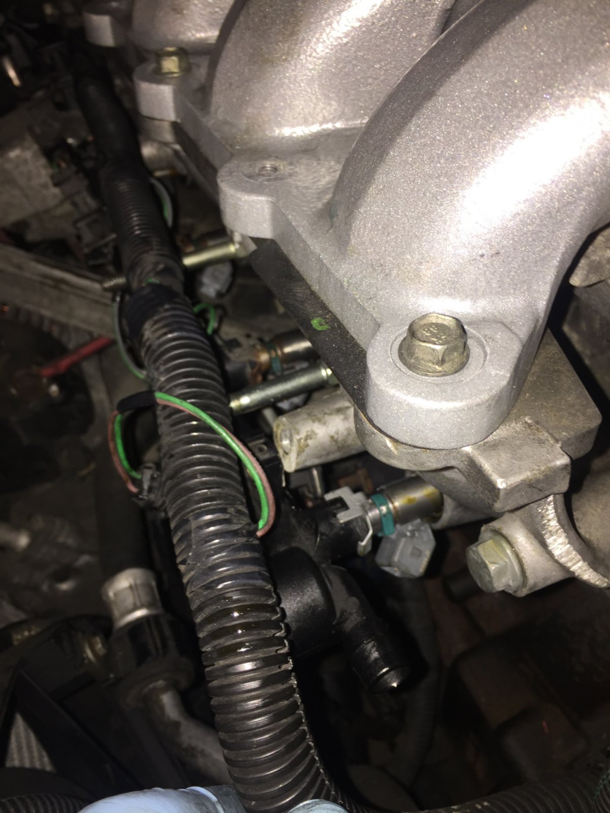

Fitted the new injector into the rail easily enough.. but cant get them to plug back into the engine. Put a bit of oil on the o rings but they just wone pop!

Dont worry about the up down movement, look at each injector to see if the o ring is pushed in to the inlet the same amount on each one. it is really hard to get them all in without lubrication. Wd40 or a little engine oil around the o ring will go a long way to helping.
Gus
  182Turbo,DCi90
Then fit the 2 bolts holding the fuel rail. this will sometimes help the injectors push in a little more if they arent in enough.
I wouldnt worry too much though, if the o rings are in the inlet then all will be well.

wiggle up and down whilst pushing with both hands , try starting from one side and working your way across.

it's not fully in. have you got a grown up who could help you:tonguewink:
I didnt know the orange bit needed to be in too!
Thanks again all. Was only meant to be an oil change, but £60 and 6 hours later, oil is changed and I have a new injector, yay.
