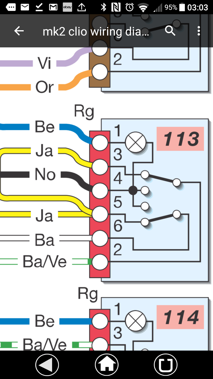

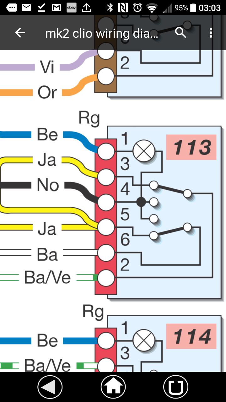

Can't edit my above post but here's a diagram to explain
113 is the passenger window switch on the drivers side. You'll need to connect up both yellows to whites so you have two pairs with one of each colour I'm each pair (yellow-white yellow-white) doesn't matter if they're paired the wrong way round, all that'll happen is the switch on the passenger side will work in reverse (up is down and vice versa) but it will prove whether the switch you've bypassed is faulty

Excellent thanks for your time and explanation mate, thats great, ill give it a try later, thanks again.
Just to clarify, i take the four wires off(yellow and white) and connect a yellow to white and yellow to white with a bit of wire?

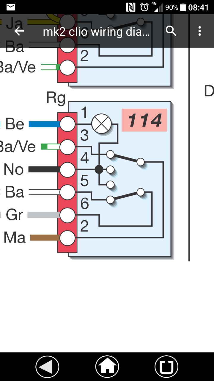

That's it mate, just unplug the drivers side window switches from the wiring connector and temporarily bridge the yellow and white wires as explained above. If it's the drivers side switch at fault you'll be able to operate the window with the passenger switch, if it still doesn't work then you can try the same on the passenger side switch to see if that's faulty instead

Passenger switch diagram just for reference if you need it, exactly the same process as above just different coloured wires mate

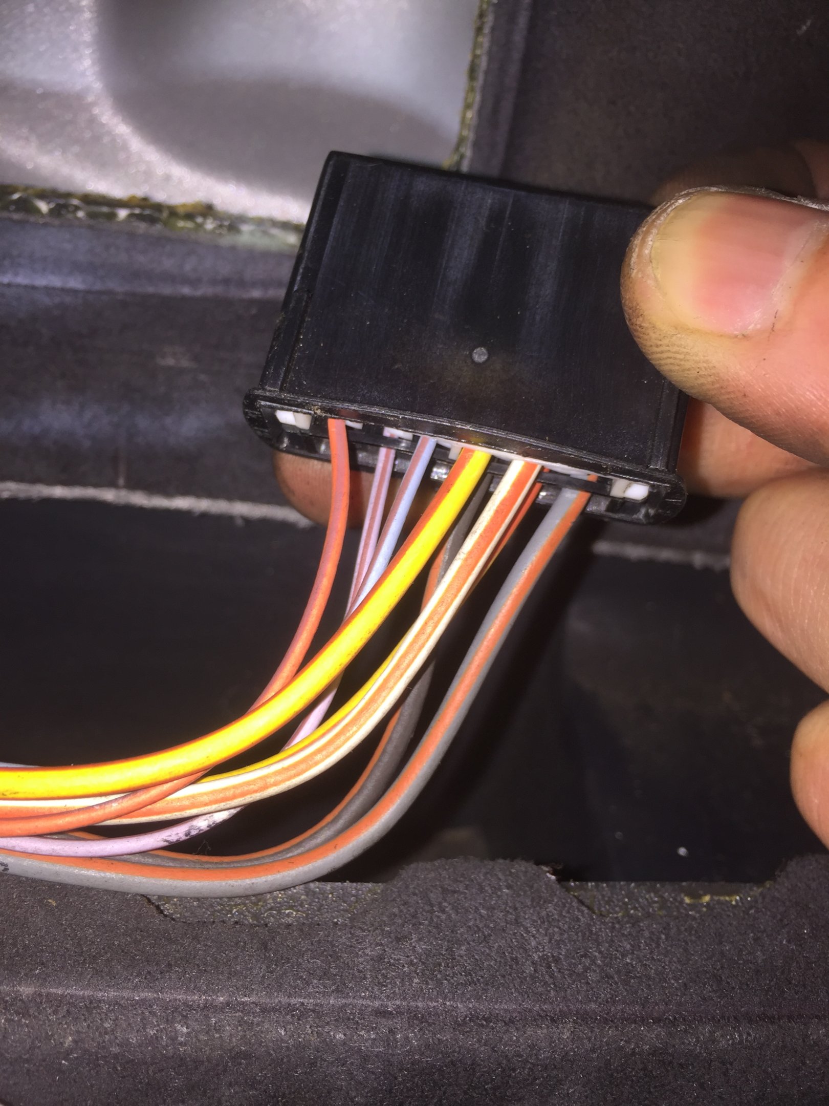

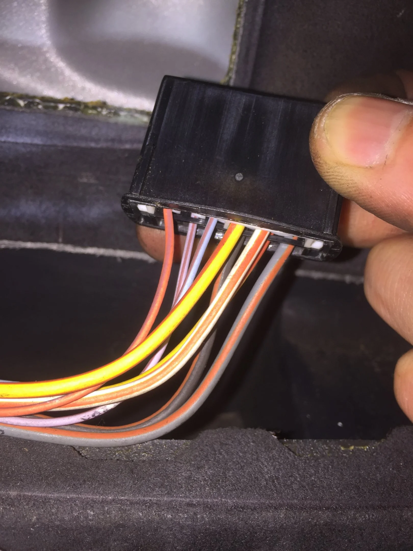

Seeing the wiring diagram above, I have taken a picture of my switch wiring and it looks totally different

Fair enough, unfortunately not as simple on mine.

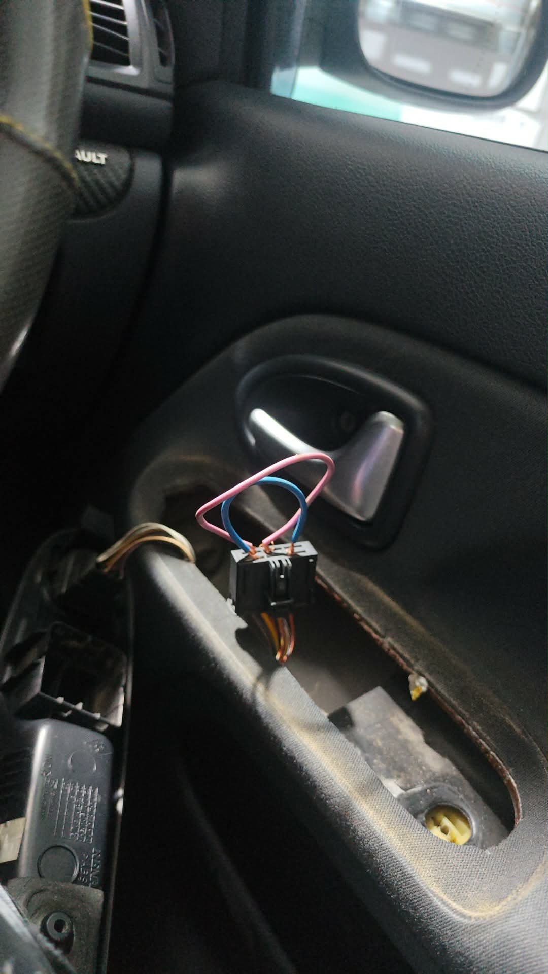

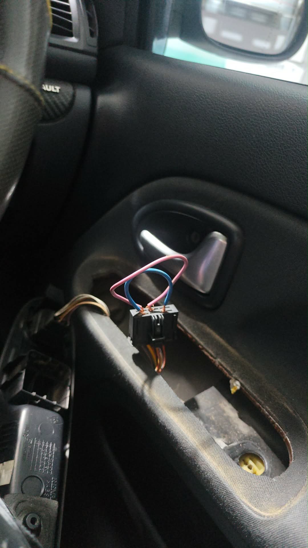

You, my friend, are a life saver. Glad I managed to find this forum post, I was at my wits end, was already looking to buy a new motor. Turns out it was the drivers side switch.
