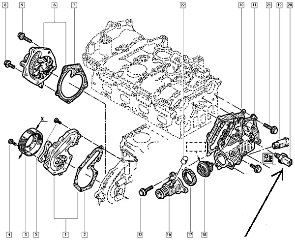

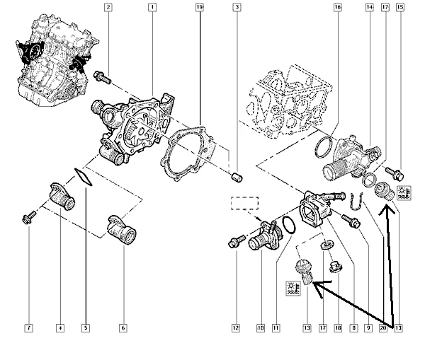

Sorry to steal your thread, but i have a similar problem with a 1.2 16v clio. When starting from cold, the revs are very low, and require accelarator revs to keep the engine from dying. It cuts out when you coast at low speeds or stop. Once the engine is at its normal operating temp which i think it 90oC, it is fine. Could this be the same problem? and if so where is my temp sensor located? Thanks in advance
  MERCEDES CLS AMG
eg

  MERCEDES CLS AMG
Heres the D4F Type - 2 options depending on what type of thermostat you have fitted
