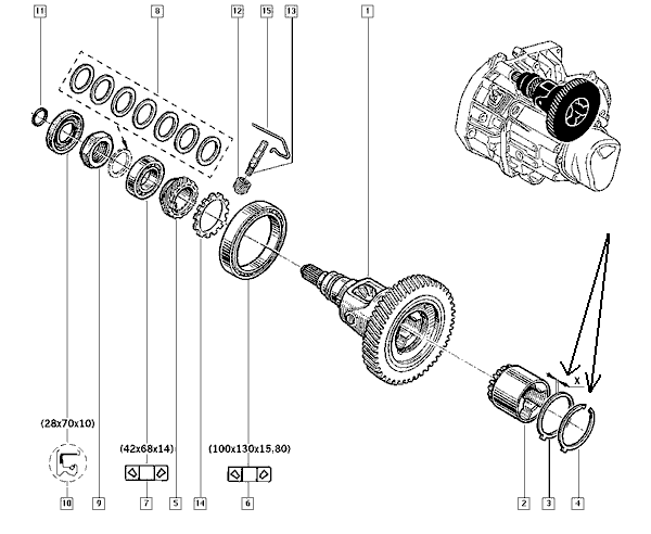

well people my car starts goes into gear and thats about it lol. does not go or move, when i put it in gear and i bring up the clutch the box knocks(like its spinning).. whats wrong? clutch gearbox?
clutch could have gone. Can you change gears without using clutch when engine is running?
The circlip has come off the inner section of the gearbox that the driveshaft pushes into. Unbolt your hub etc and pull the shaft out - there will be 2 circlips - part numbers 7700720854 £3.40 & 7703066331 £1.58. Refit the clips back into the gearbox pinion ( cup ) slot the shaft back in and away you go. Easy job - takes 1 hour and will cost you about £30 maximum with parts and fresh gearbox oil.
