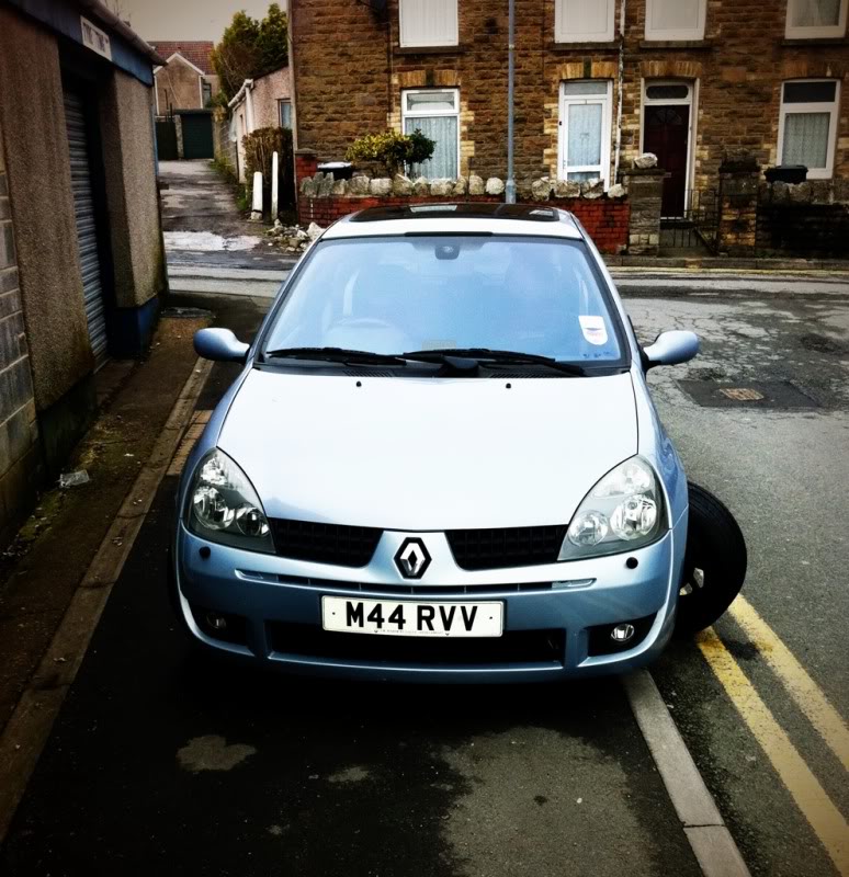

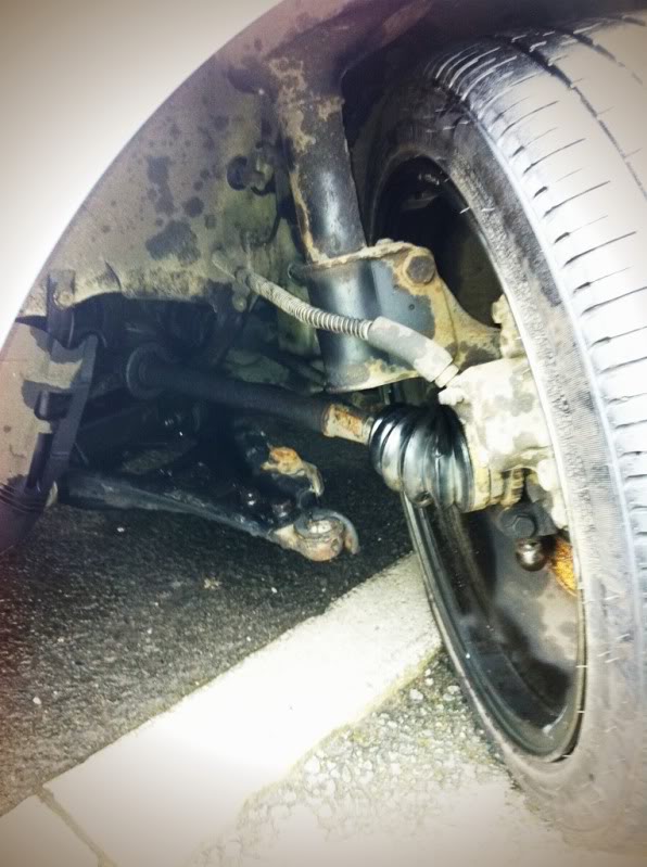

Just some photos!!!
Has the wheel damaged your wing?
Does not look to bad mate. Has not pulled the brake pipe off so just new ball joint and seal for shaft into gearbox and you should be ok.
Oh but if thats how it is now I would jack it up and take the weight off that wheel and brake line.
