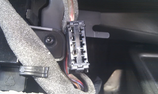

Right i have found the problem
IMAG0044 by sbridgey, on Flickr
This is the heater resistor pack plug that plugs into the resistor pack, as you can see one of the terminals has melted, i phoned Renault Leamington for a price for plug/loom and a the resistor pack, the price was £120 which i think is quite expensive but they do keep that part in stock and said it must have been a common for them too keep it in!

If anyone wants to know how i accessed the resister plug here is the guide: http://www.renaultforums.co.uk/showthread.php?t=53483&page=4
