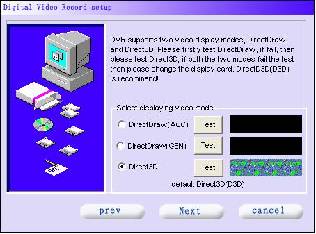

ok so a little man from china has been looking at my pc remotly, everything is connected and working fine but my computer isnt up to spec.
the issue is this -
direct3D -
ive no idea what direct3d is but its not working on my computer, the little chinese man said my graphic card needs updating. the first two directdraw both work fine.
here some spec info on my pc which is pretty old.
can anyone help with this problem and what i need to do to get this direct3d working on my computer?

my main desktop pc is a bit old, but i ran the direct3d tests and all came back fine
now trying on a newer laptop and again all direct3d tests worked but i just get a grey fuzzy screen

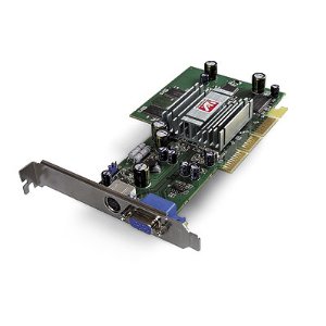

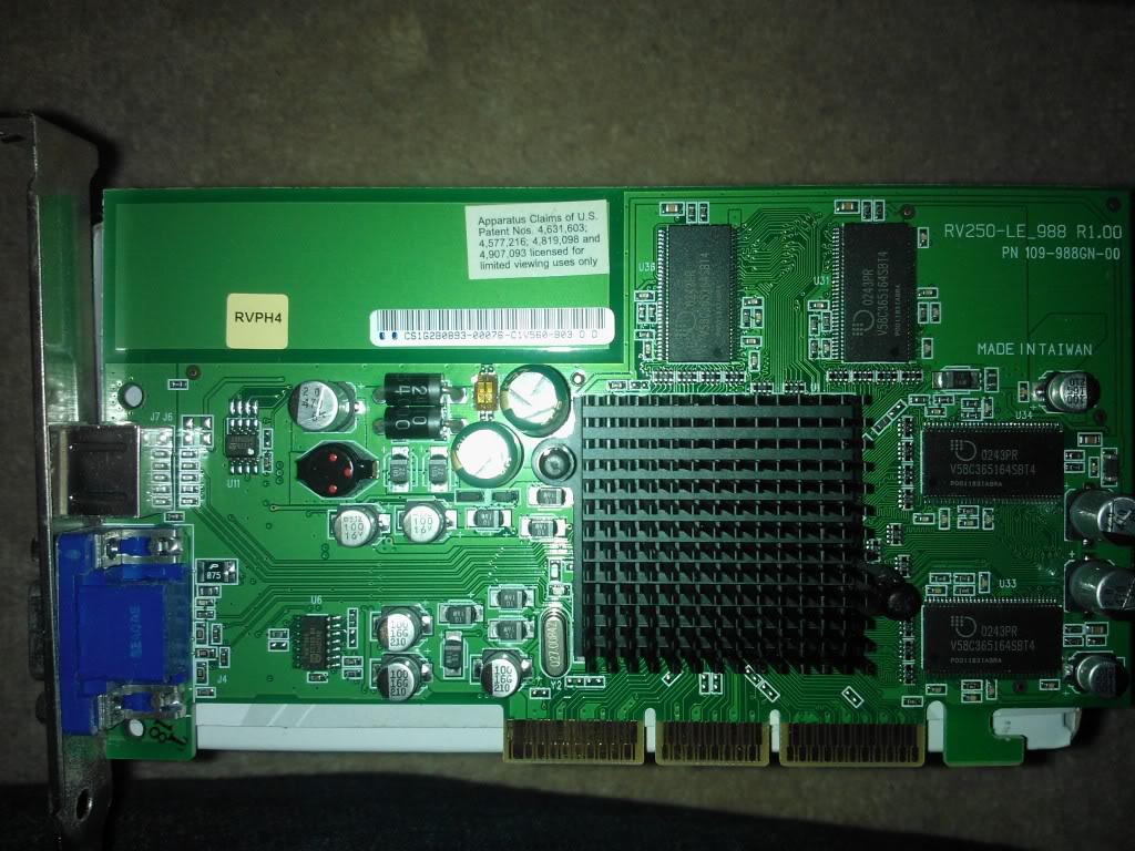

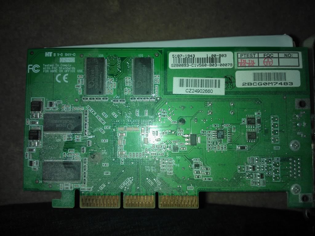

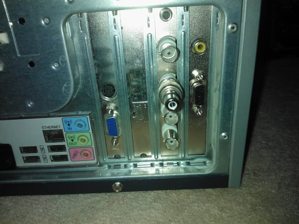

Take a picture of the socket the graphics card is sat in, Andy, then post it up
Does your graphics card look like this, inc the connector?

um ok, if i can find where the graphics card is.

brown socket will be agp more than likely blue is usually PCI-e. But its not a standard. I am 99% sure it will be AGP though

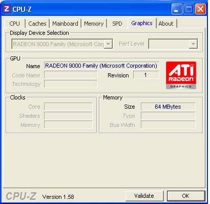

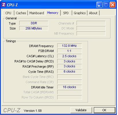

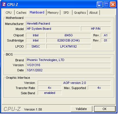

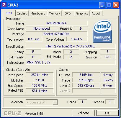

as requested pics from my desktop pc

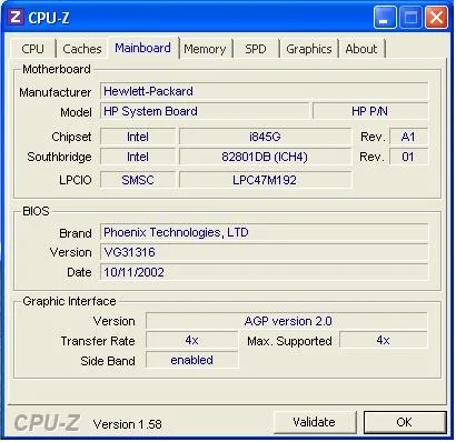

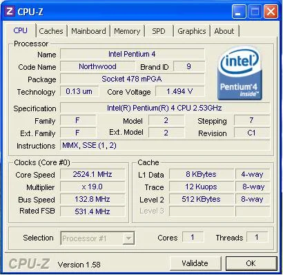

Show us the mainboard tab
And run gpu-z and show us the output of that aswell please
TBH you should really use this as an excuse to upgrade your machine. At present its a bit like ordering in Sky HD 3D then plugging it into a 19inch Blank and White Bush portable.
