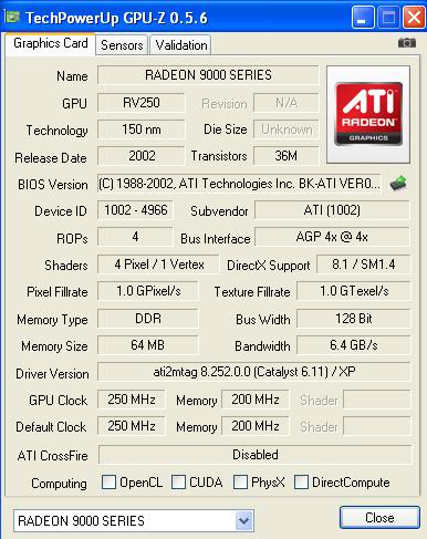

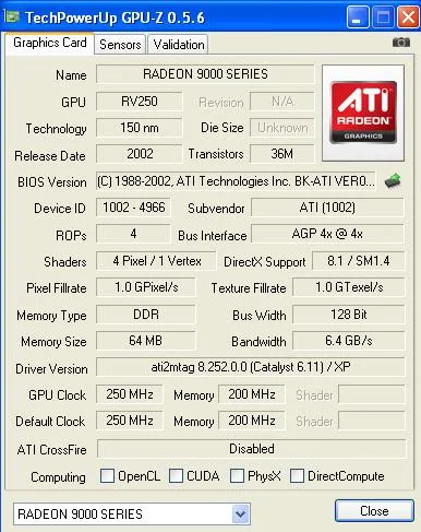

TBH you should really use this as an excuse to upgrade your machine. At present its a bit like ordering in Sky HD 3D then plugging it into a 19inch Blank and White Bush portable.
yeah i know as always in life money is an issue and this machine is used for cctv recording only. nothing else
so providing the ip camera works and recorded in HD i dont care. i can take the footage and display it on another machine to see its high quality if need be. im guessing it would probably be wise to get some more ram to

ok 2gb of ram ordered, just just need to sort the card out now
as requested
sbridgey
  disco 4, 182, Meglio
I am not sure that the gpu is the problem here, certainly an upgrade is a good idea i am just not convinced it will fix everything

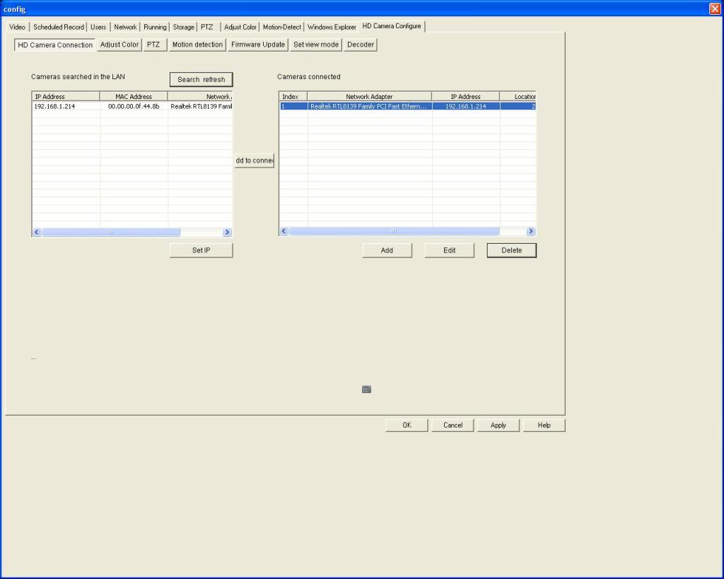

when i go into the ip camera software its picks up what im assuming to be the camera - realtek RT8139....

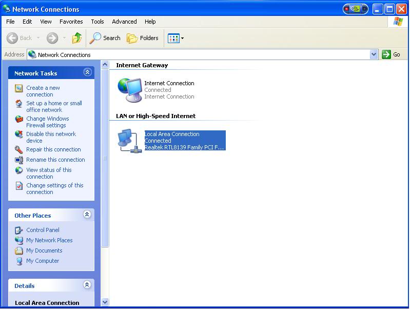

ive just gone into device manager and network adaptors and it says realtek RT8139...
so is the software actually picking up the camera and giving it the same name or is it not picking the software up? the camera software does give the realtek thing a ip address

Your camera shouldnt be in device manager and you should be required to enter the camera's IP address inside the software in order to access it as it is IP based and not physically connected to your PC, i am assuming you connect it via a switch to your pc

Wild guess says its picking up the network card in the computer, not the camera. Could be wrong but it's home time and I'm in a rush, I'll check back tomorrow.

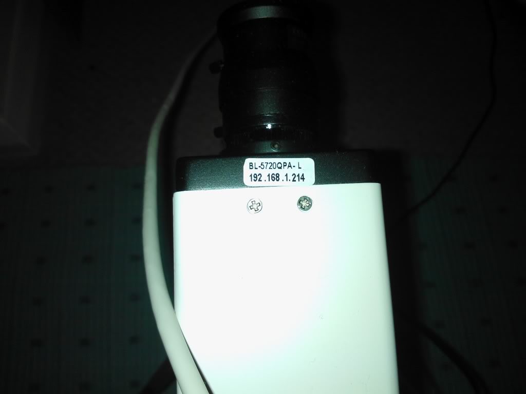

The ip address on top of the camera is 192.168.1.214.
When I go into the camera software the ip address of the realtek device its picking up is 192.168.1.214

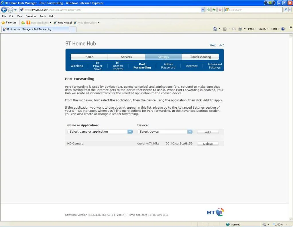

]when i go into port forwarding setting in my bt homehub it picks up an hd camera, all the computer picks up is a realtek thing.

The realtek will be your network card I think. Find out the IP address of the camera. If it's static it will be labelled or in the documentation somewhere. If it's dynamic the home hub will have it listed.
You should then be able to access the camera via a web browser (or at least ping it) by typing in the IP like you have with the home hub (providing they are on the same subnet)

and thats the problem...
so camera say 192.168.1.214 on it
the camera software says 192.168.1.214 but realtek
and connections manager says realtek
im completely lost and it seems like rocket science to get this camera to work

oh and the adapter should be realtek, it is showing up the card installed in your computer as the gateway to the network

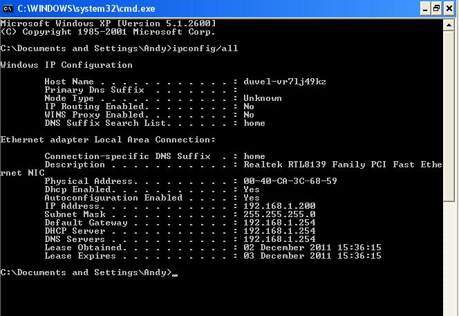

Open a command prompt and run "ipconfig /all"
This will list the ip address of your machine.
I believe the camera software is just showing the network over which its connected.

The mac address listed in the software is different to that listed in the home hub. So the software is seeing the network card or getting confused. As said find out the IP address of your computer and we can go from there.

ok found the unknown device in the bt homehub setting and the ip address is 192.168.1.214 i also enabled port forwarding on the unknown device
