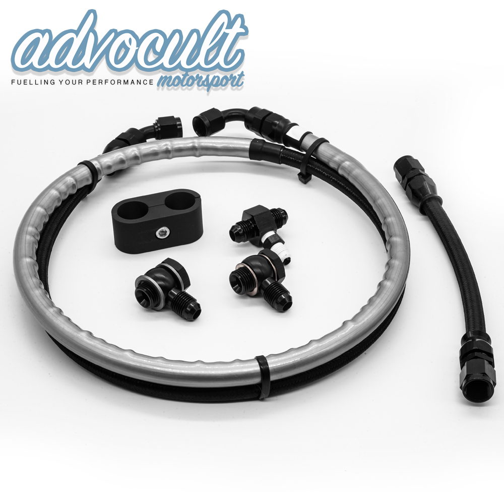

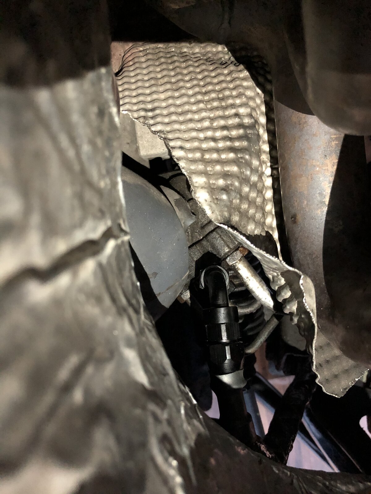

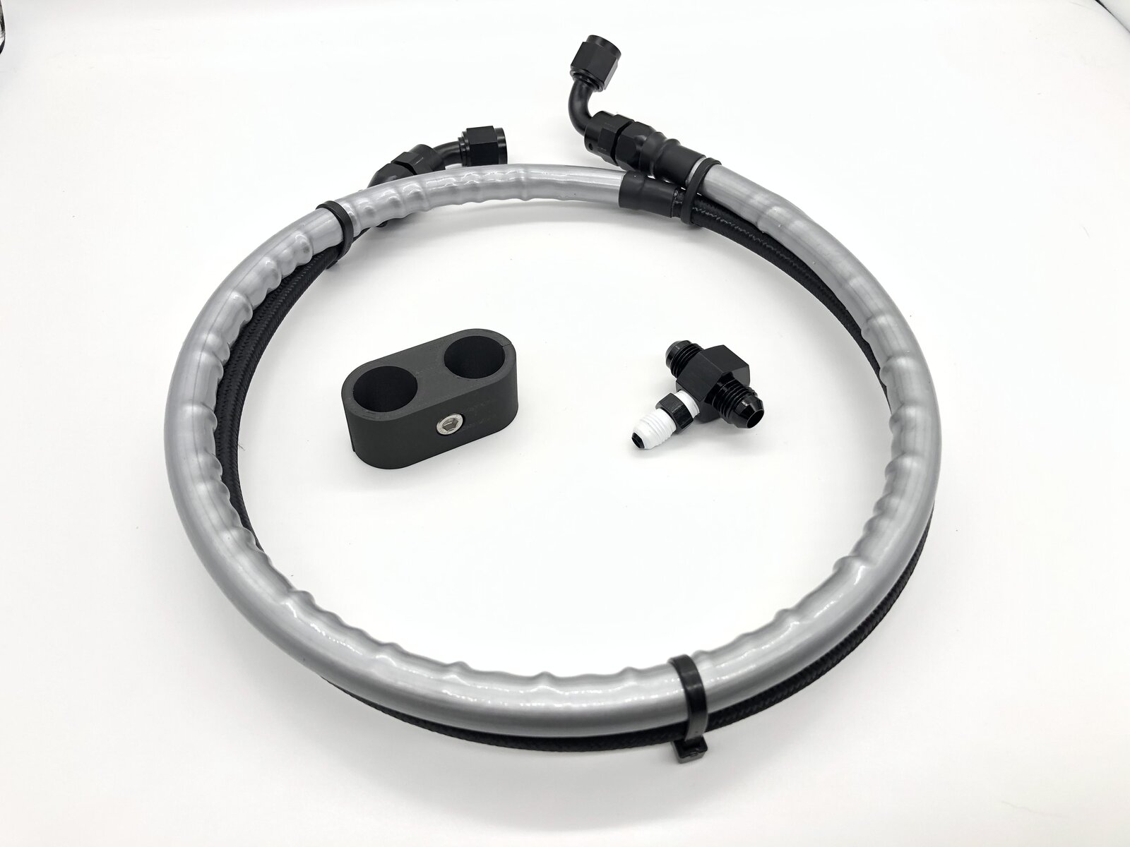

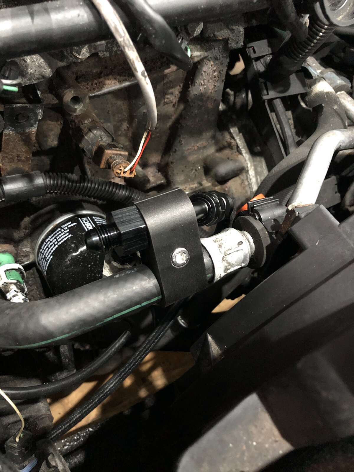

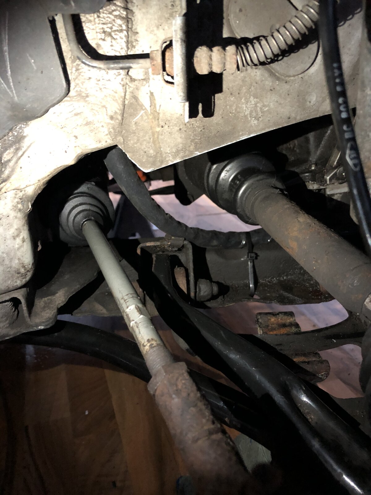

Feed hose pretty much mapped out. We decided to change the route of the original hose to the near side of the car. This keeps the hose away from the manifold. We are just waiting on some more banjo connections to come in to finish this off so we can start testing. We also need to come up with a more rugged method of holding the hose in place around the drive shaft.
So the kit replaces the high pressure pipe and has an inline oil cooler rad if I understand correctly?
Just a replacement for the high pressure hose at the moment. We will test that first then come back to the cooler.
The cooler will either replace the return from the rack to the expansion tank hose. Or the hose from the tank that supply’s the pump.
The biggest issue with the cooler is if it is really needed. Although the stock system will generate heat by working the fluid, a large portion of the heat will be coming from how the stock system is routed (right under the manifold)

Hi Frayz, after speaking to many owners we have come to the conclusion that the majority of the issue with boiling fluid is either due to old fluid that hasn't been replaced in a long time, and combining that with the fact that the stock hose is routed directly underneath the exhaust manifold.
We will be working on a cooler kit at a later date, but fixing the recurring leak issue is the top priority.
We use HEL performance fire sleeve as it is rated to 250C direct contact which is more than enough for this application.
