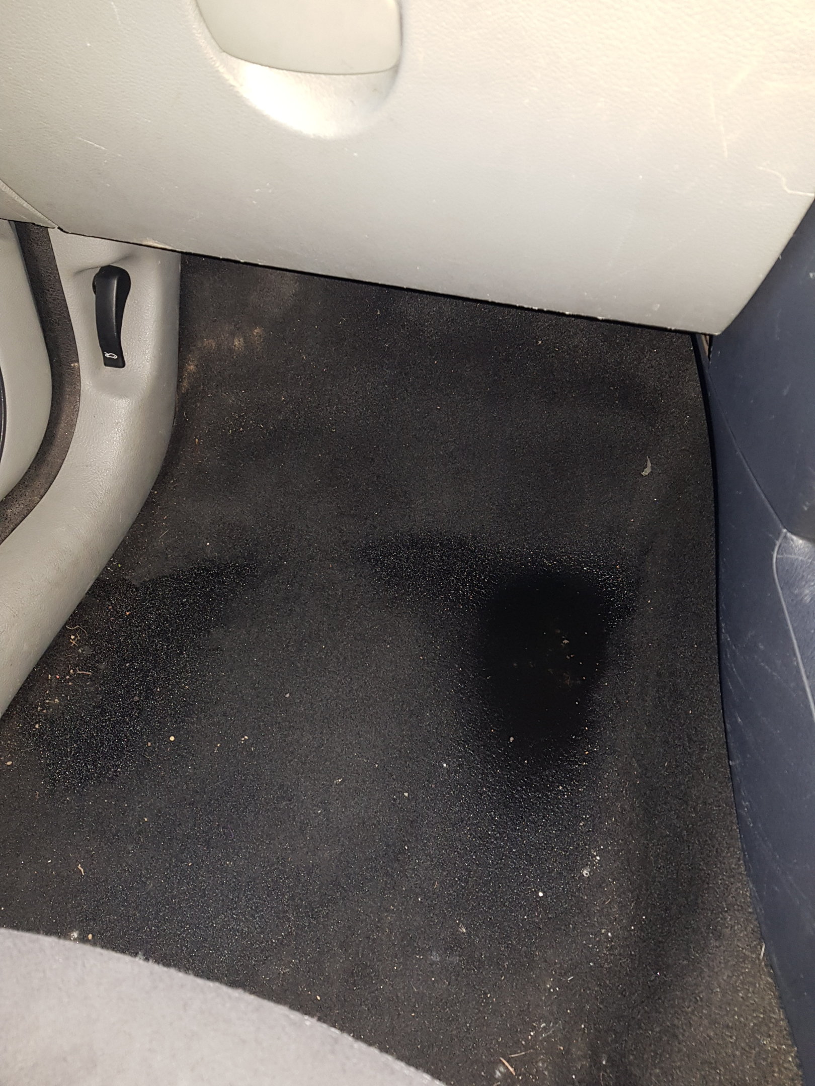

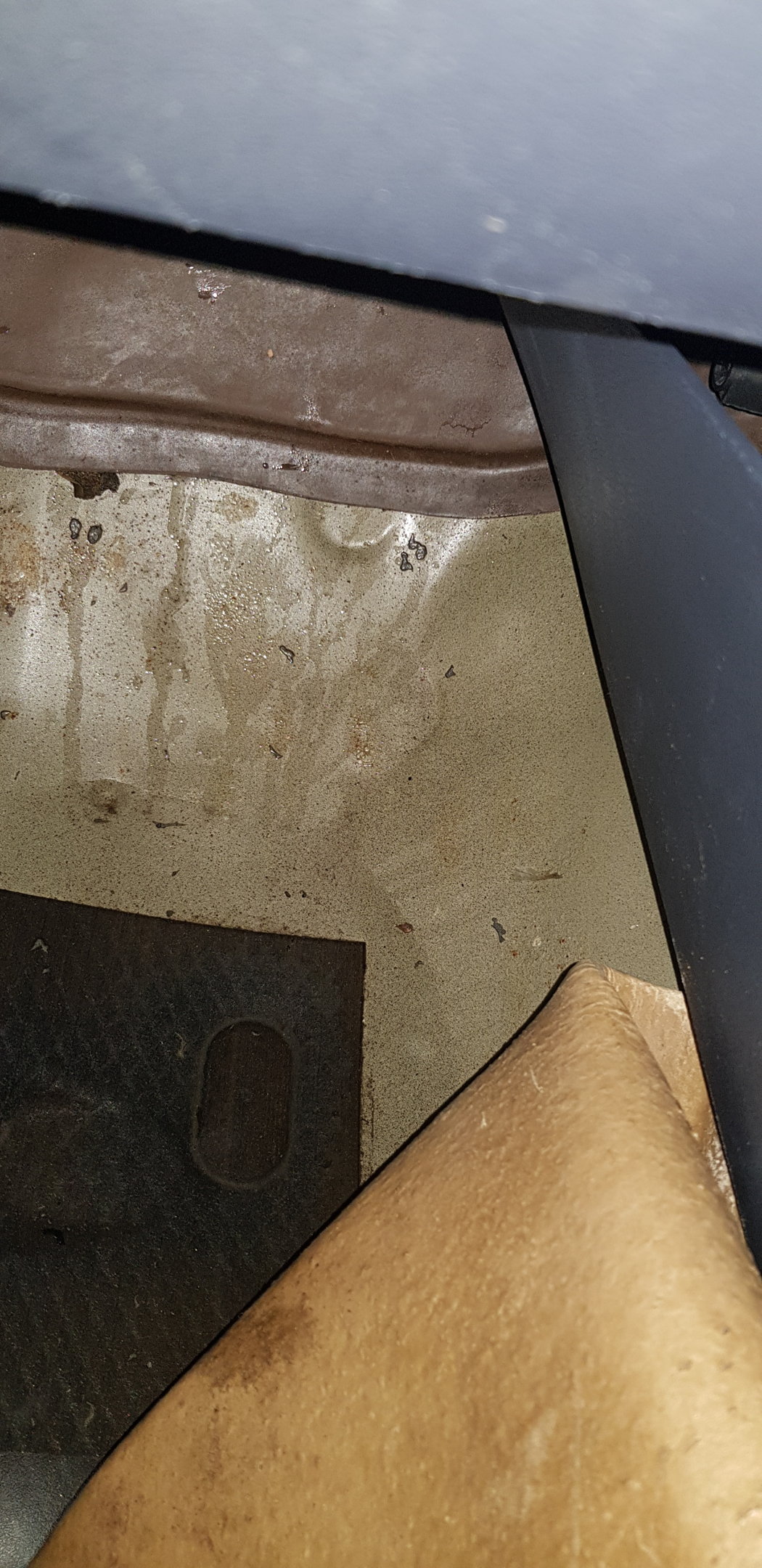

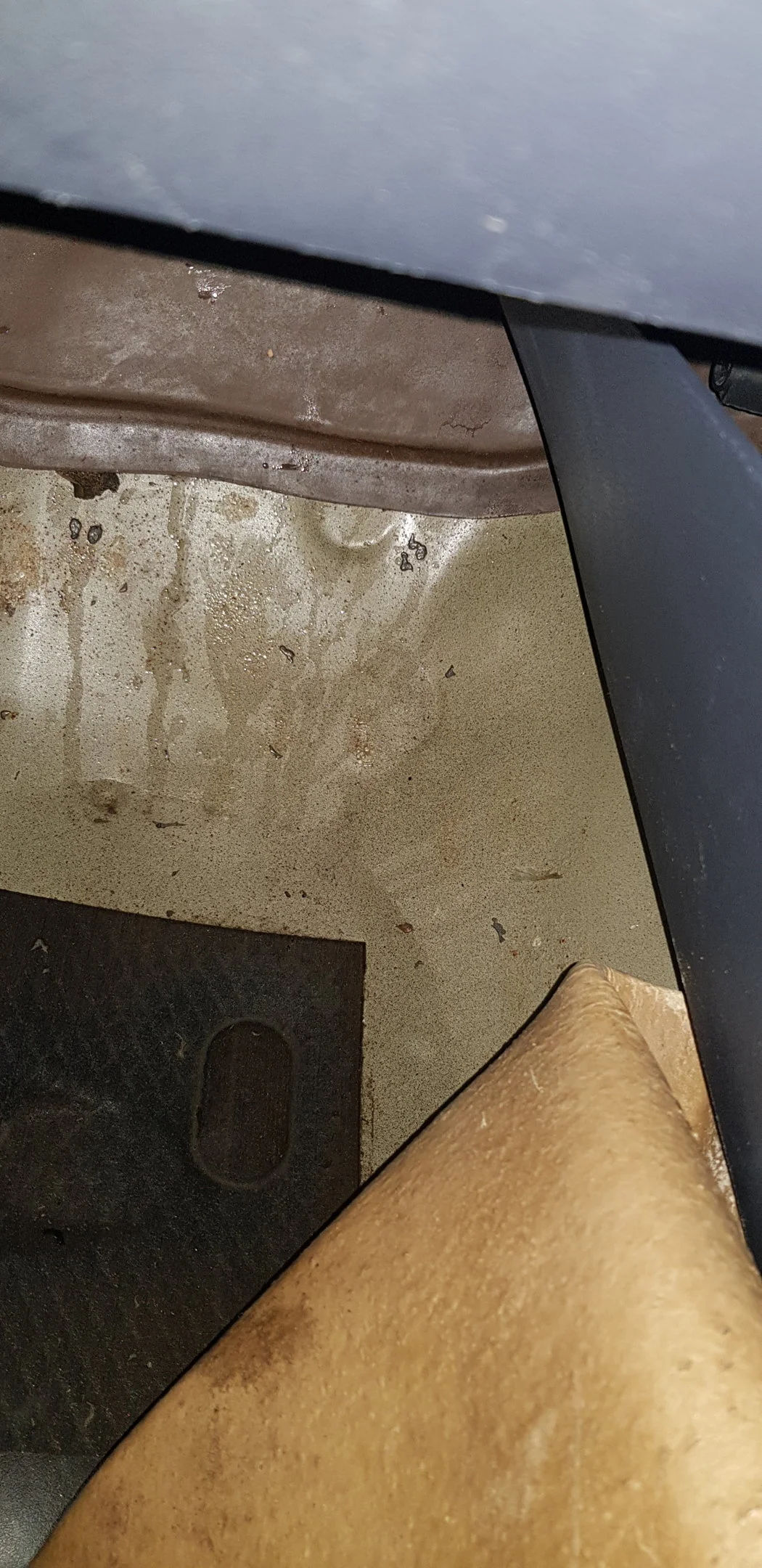

I have a clio 2004 and for the past 2 months I've had a puddle of water in my passenger footwell every time there has been heavy rain.
I have unblocked the drains on the left side of the car. My windscreen was replaced over a year ago. And the sunroof was fixed last year for a leak there.

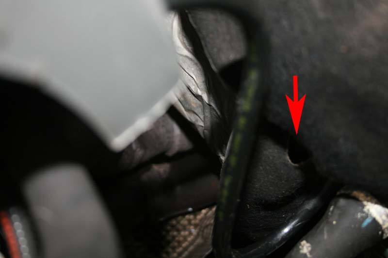

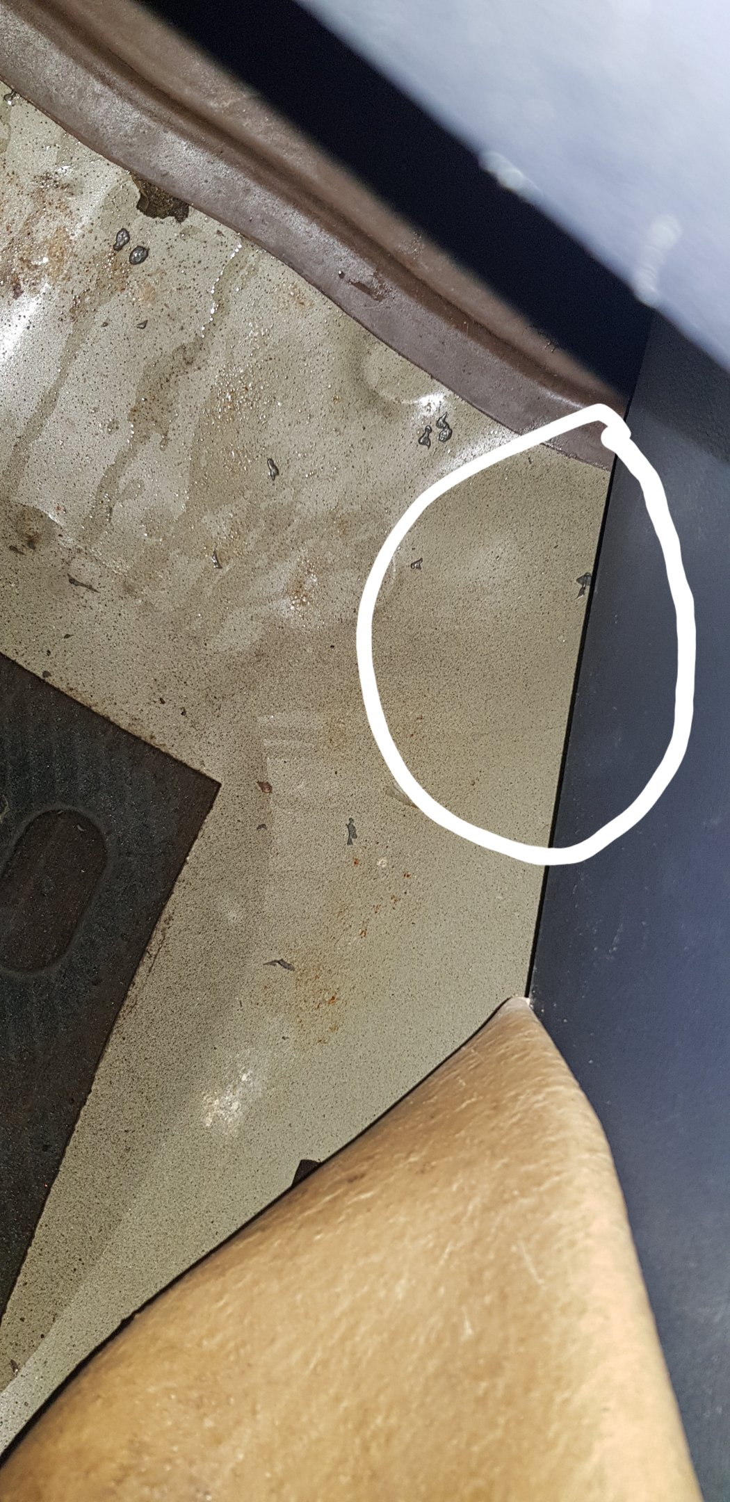

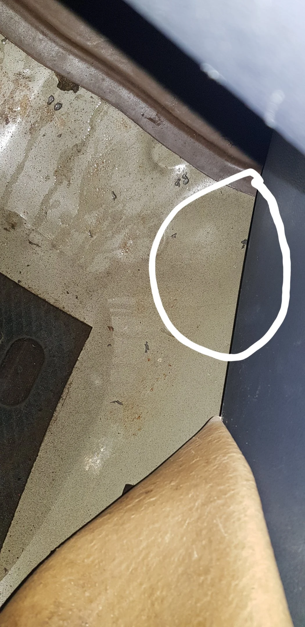

I've removed the carpet and the foam underneath (which waa drenched) last week waiting for heavy rain again. To find where the leak is. I've located it to under the dashboard (see photos attached where its circled I have actually seen water run in during heavy rain), the foam under there seems to be soaked too so this maybe where the leak is coming from and now I'm at a loss as to how to fix it.
It must be coming from the scuttle panel. Is there a drain in the middle that can get blocked. My drivers side one is fine.
The water is definitely rain water.
Can anyone suggest my next steps.
Thank you soooo much in advance

I would check the central scuttle drain outlet first, it can get clogged with dead leaves etc
At back of the engine -in the centre, run your hand down the sound deadening carpet until you find a small hole well down the back, pop your finger in there -there should be a rubber pipe outlet, give it a jiggle ans see if any water runs out, if you dont find it in there then it could have been ripped out before as these clogged.
If not that then the blockage could be in the scuttle, this requires removing the windscreen wipers and plastic scuttle to get at it.

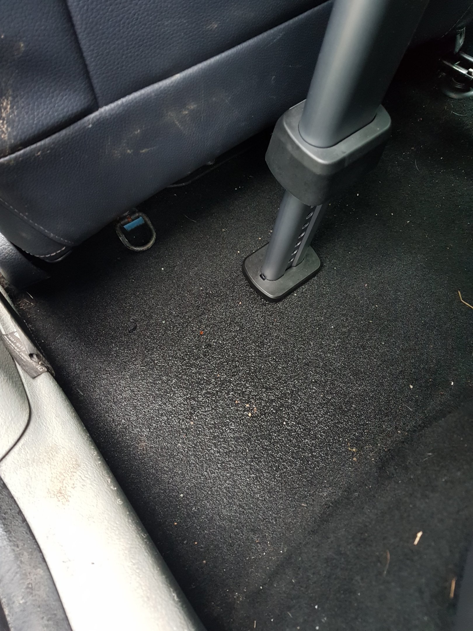

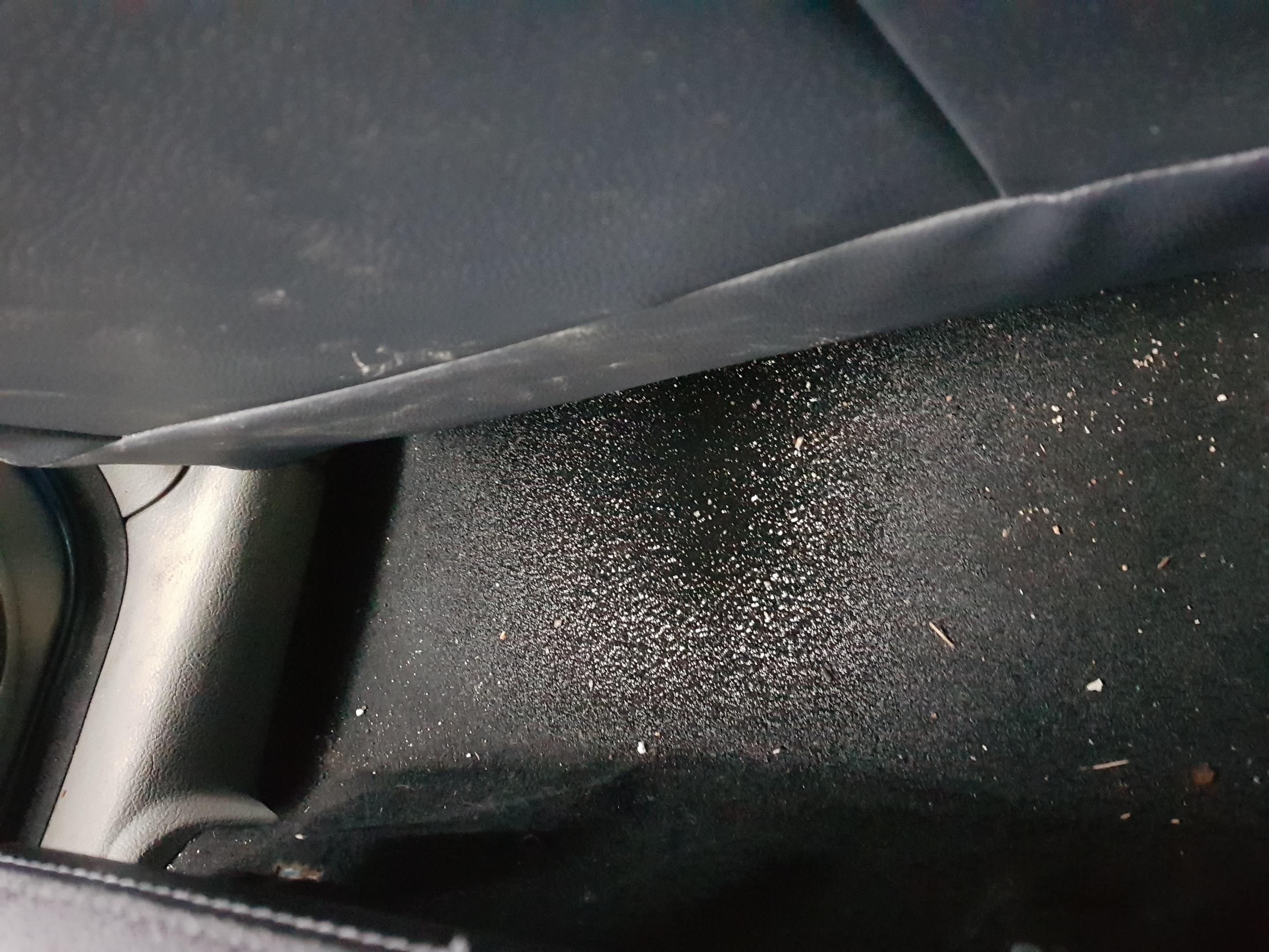

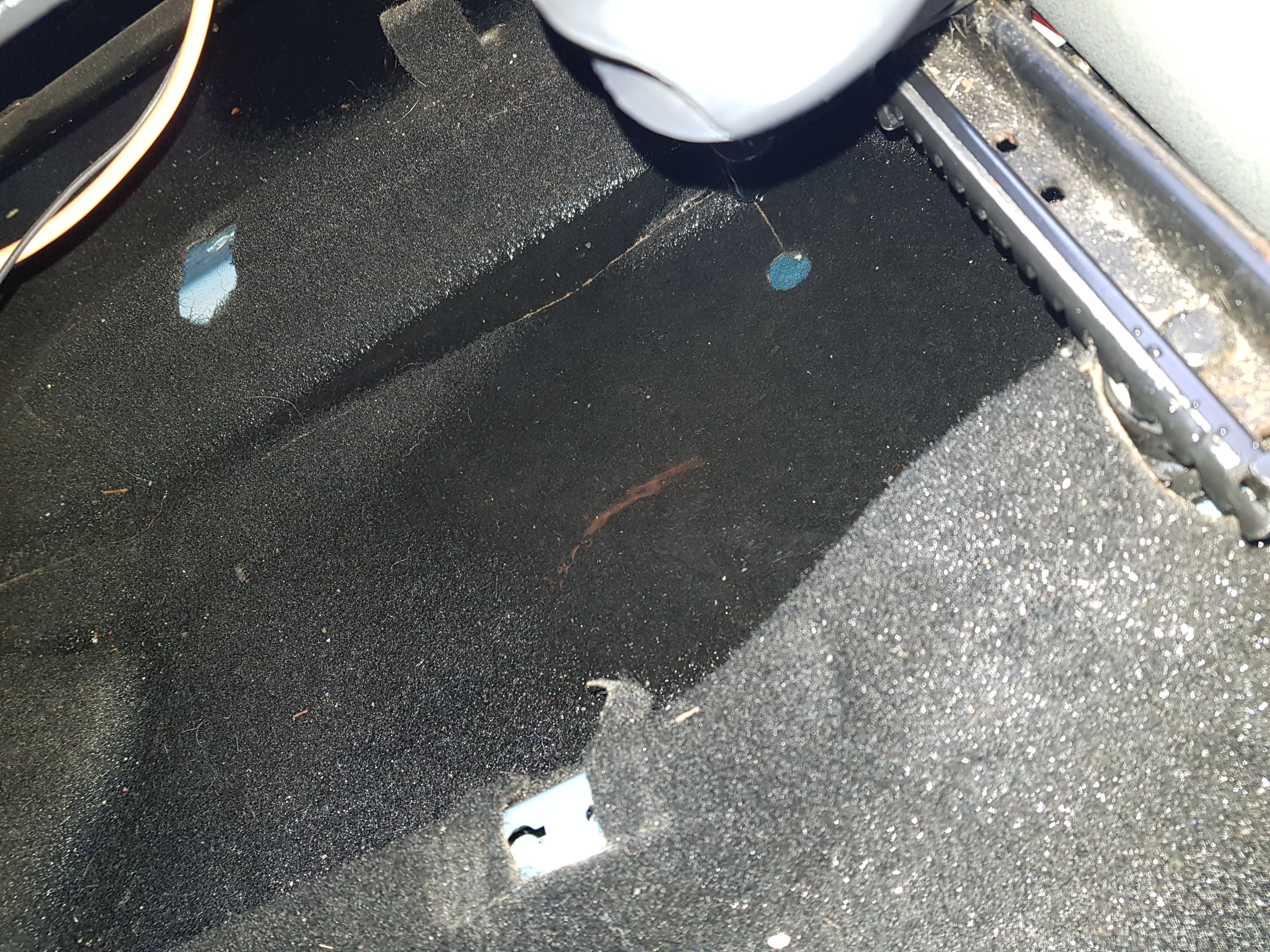

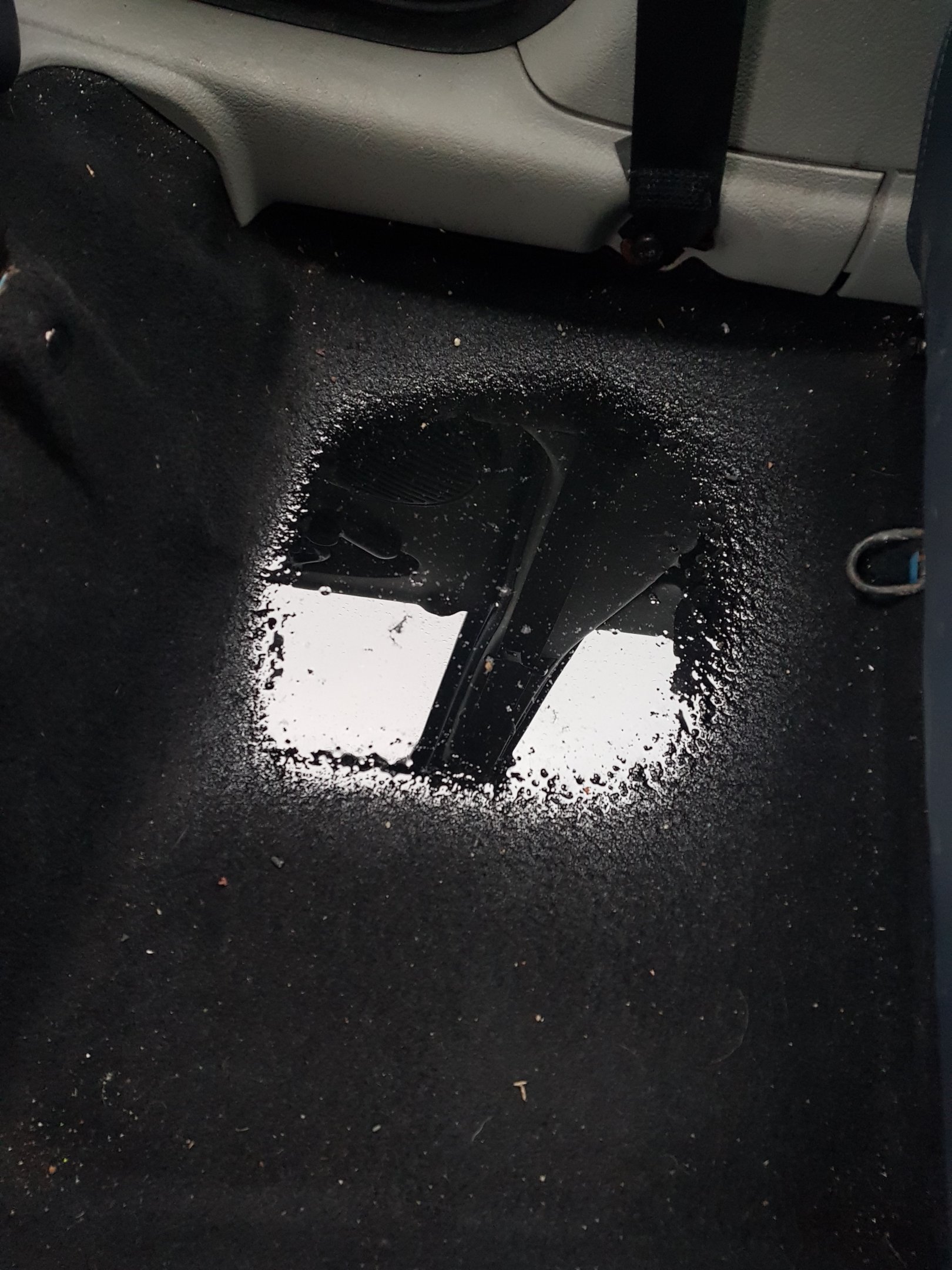

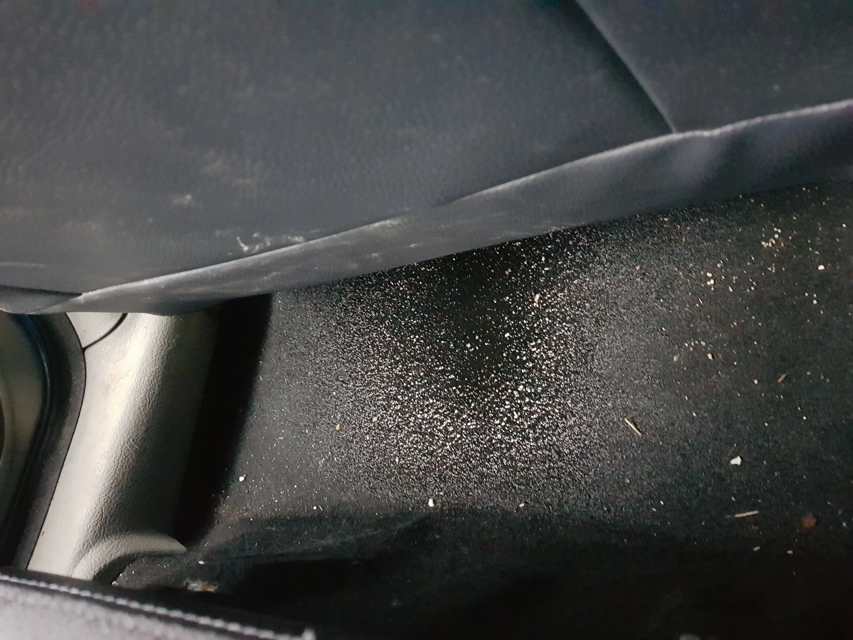

I spent 3 hours on the car tonight and found multiple leaks from so many places. Here's hoping I don't get this again tomorrow...
The whole passenger side including under the seat is saturated and the dark bits are actual puddles.. !
