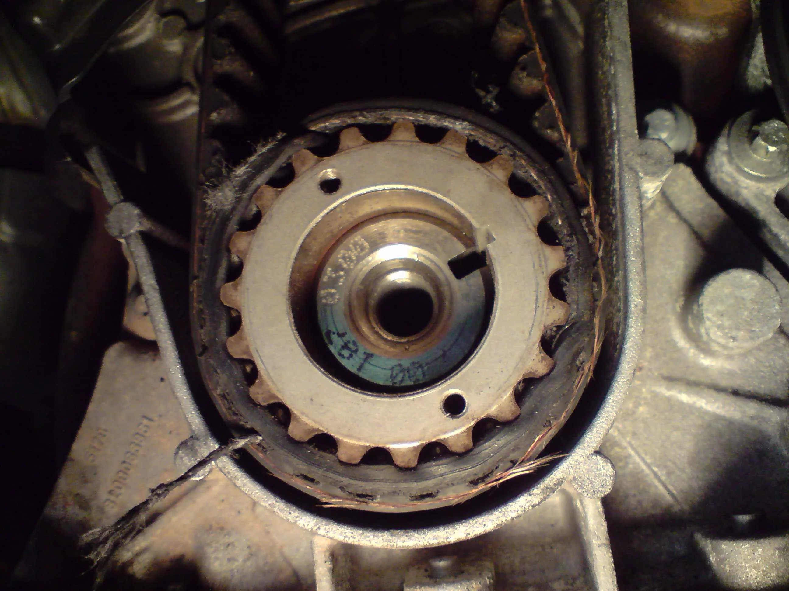

  Megane dci 130
It does this
  Monaco 172
It does this
Hi shepperdspie i reckon theres a good chance this is whats happend to my car, i just wanted to know if you could tell me more about it? like
has this completely wrecked the engine as the cams are still moving ?
Is it a big job to do ? is it pricey ? :(:( lol
Thanks for ur help

you could try and just get the timing checked and adjusted if needed and try it. seen 2 that have been out from this and done no damage , run spot on with no compression loss after timing reset . (probably lucky) if not , may have just done the valves , but head off to investigate . common fault.
its a s**t when it happens. price depends on what found when head is off if timing up doesnt work. get someone who know what they are doing to check/reset for you though.

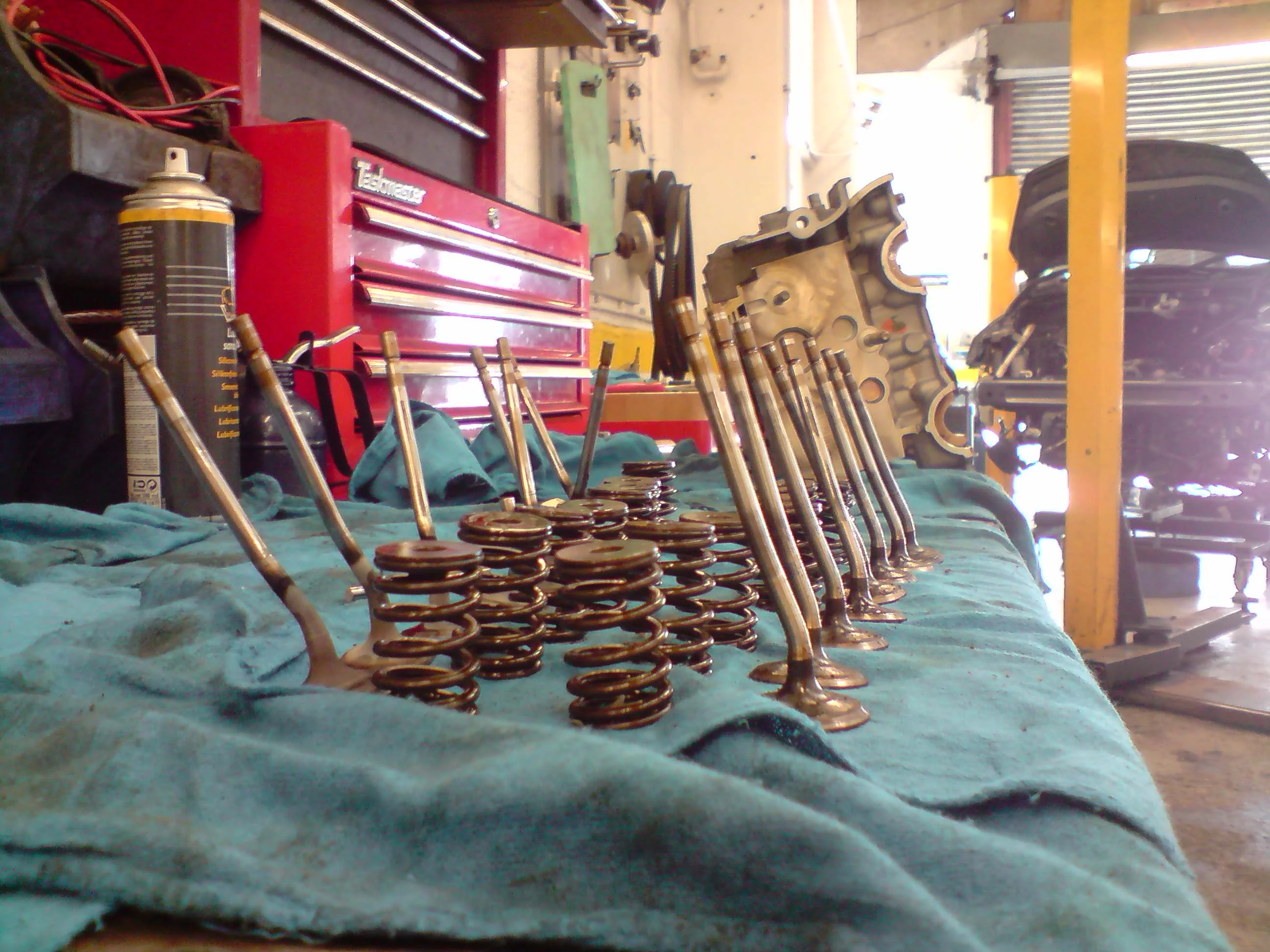

My cars been at the garage today getting checked and the belt did wrap round the pully, i had the timing redone but there was no compression in thre engine so the machanic reckons the valves are bent.
anyone know where i should go from here and if this is a major job and would it be better to replace the engine or not.
