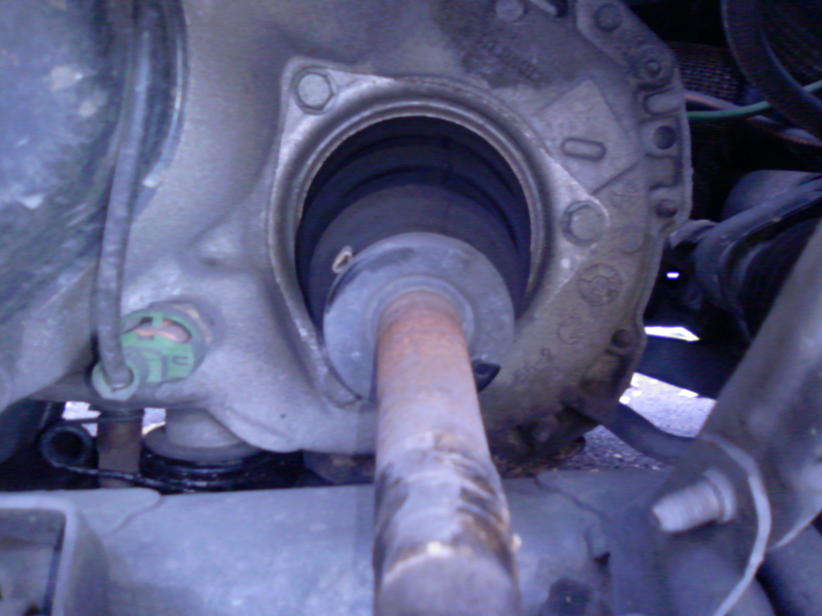

Hi i managed to damage the outer cv boot joint on the passenger side on my 1.2 clio, i have got a replacement part and have striped off the old one but am having difficulty replacing it with the new one.
Will i have to completely take off the drive-shaft? and if i do uno it what can i expect? loads of grease to pour out?
Pic below is the inner part of the drive-shaft.
Any help would be great.
Yeh, unless you want to put a crappy velcro one on it's a drive shaft out job - worth the extra effort though. Not too difficult
if you want to remove it, then just drop the gearbox oil out and undo to the 3 13mm bolts to remove the shaft
