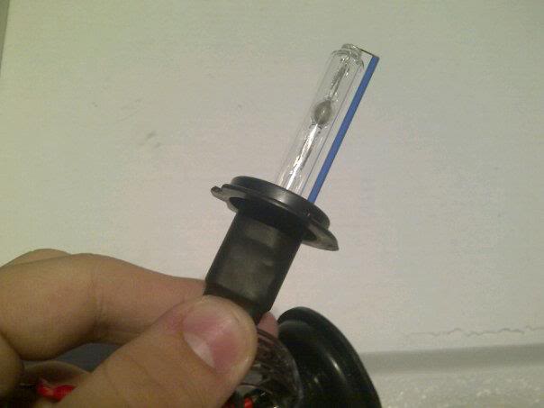

Im currently trying to stick mine on at the moment, but I dont see how I get the metalclip onto the light when its just a bulb sitting on a bit of plastic.
Apologies for the sh*t pic
Ged
  PD130 Peach
On mine the clip was in a slot at each side, bend the clip out of its little holders and then put the bulb in. Then replace the clip over the top of the bulb..
I think this is what your trying to get at?

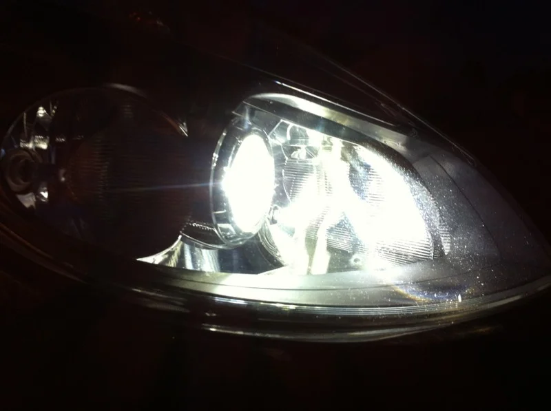

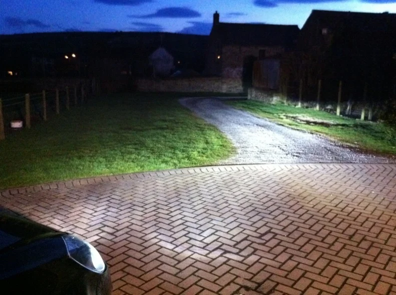

Overall can't say how much better these are!!

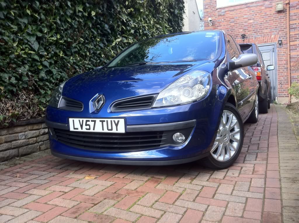

Hi Guys just a quick one, what fitment do i need for my lights (H1 or H7) I have attached a pic of my car below... Also is the bumper easy to come off??
