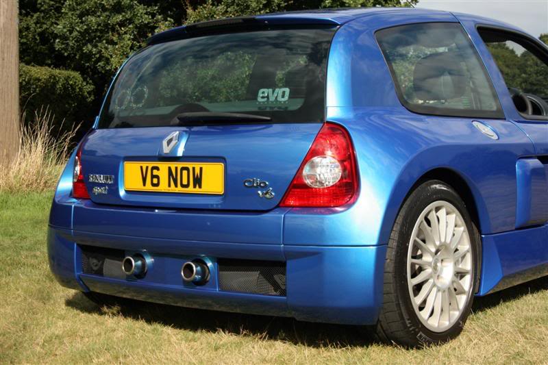

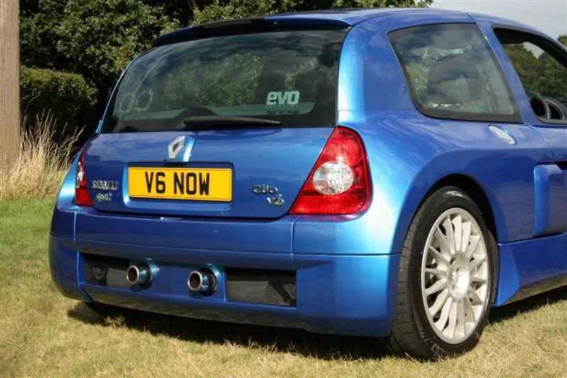

This is what it looked like when done, they are a mess now!
