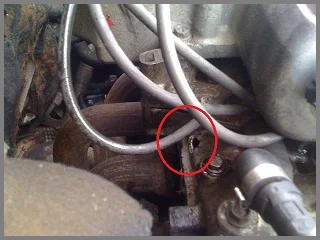

On the way home from a track day at Brands Hatch we found a hole in the engine which was coughing up oil over the manifold. I thought at first it'll be a simple case of whipping off the rocker cover to assess the internal damage (if any), but i've since read the rocker cover forms part of the camshaft carrier :S
Would i be right in saying that the pulleys have to come off to remove this part shown here in the pic? I'd like to have a go at stripping it down my self, but if it involves timing gear i'll probably leave it alone.
Yes the rocker cover holds the cams in place , and you have to remove the pulleys to take it off , how is there a hole in it ? It the engine making any funny noises ?
If all seems ok , you may get away with filling over the hole carefully with liquid metal which you can buy from somewhere like B&Q , it would stop it leaking oil out and may fix the problem .
Other than that , it needs taking apart and welding up

The engine sounds and runs fine. It's the not knowing what caused the hole that's worrying. It has been suggested that a stone chip may have caused it, but I put that down to wishful thinking...
I suppose we could drain the oil, change filter, use some engine flush and check for contaminants. If all seems ok then just plug the hole and see how we get on.

Update - as suggested above we used some putty type weld mix which sets rock hard. It held for quite a long time and even managed 3 hours of abuse around Brands Hatch before it came apart. Given the way the engine performed i'm fairly sure that it's ok internally so i want to avoid taking it apart, but i need something stonger to patch the hole.

I struggle to see how you could have something make this hole and still have a running engine!
I would suggest pulling the manifold off to see if the nearest valve is opening as a compression test wouldn't really highlight a non opening valve, however this would involve dropping the subframe and is probably more effort than taking the head off.

Rocker cover needs removing to weld it anyway so you should see anything obvious then. Aside from that, having a look down the bore with a camera/scope would be helpful.
If you remove the cat first (a bit harder on a 172 than a 182) you may well be able to get the manifold off the studs far enough to get an inspection mirror in place and see if all the valves are opening, I've managed to do this on a 182 when replacing a manifold gasket, although that's all I was doing, I wasn't looking at the valves. Alternatively, a well equipped workshop may be able to get a boroscope (or similar) down the plug holes to see if there's any valve damage
