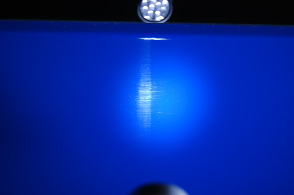

Marring covers both.

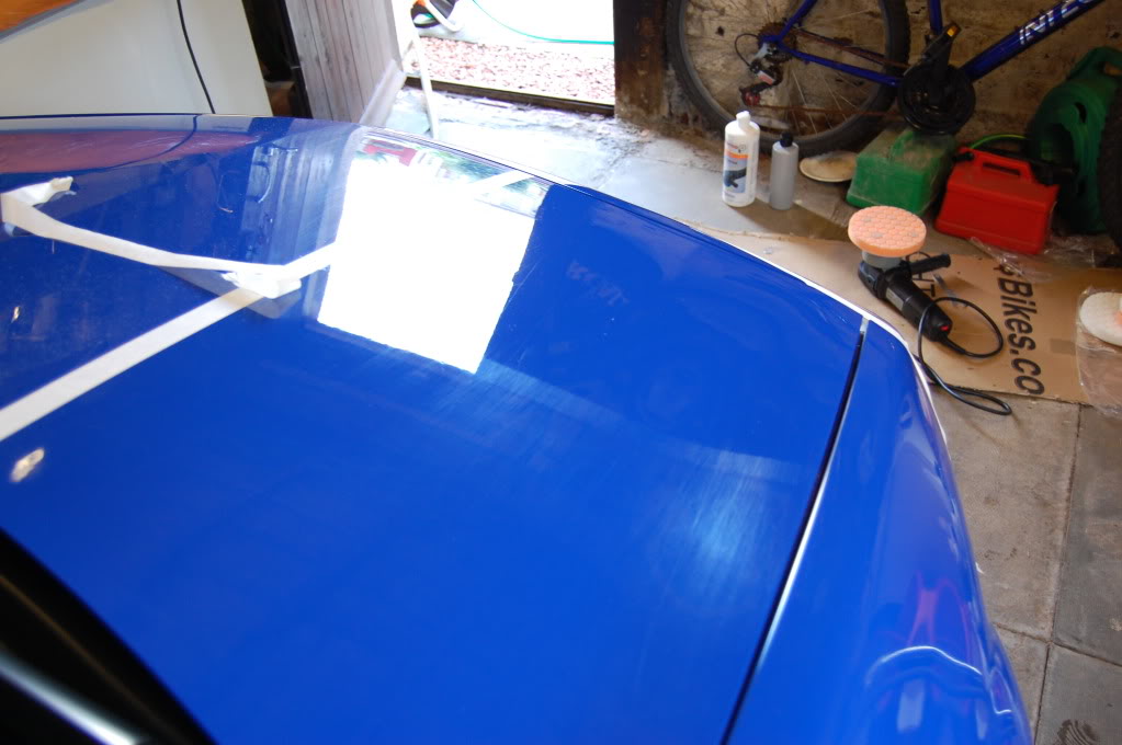

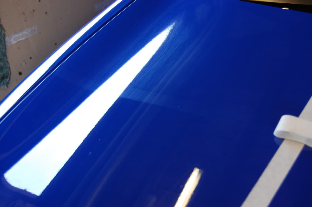

Hologramming;
Swirling and hologramming (notice the difference in rotation and travel lines difference);
