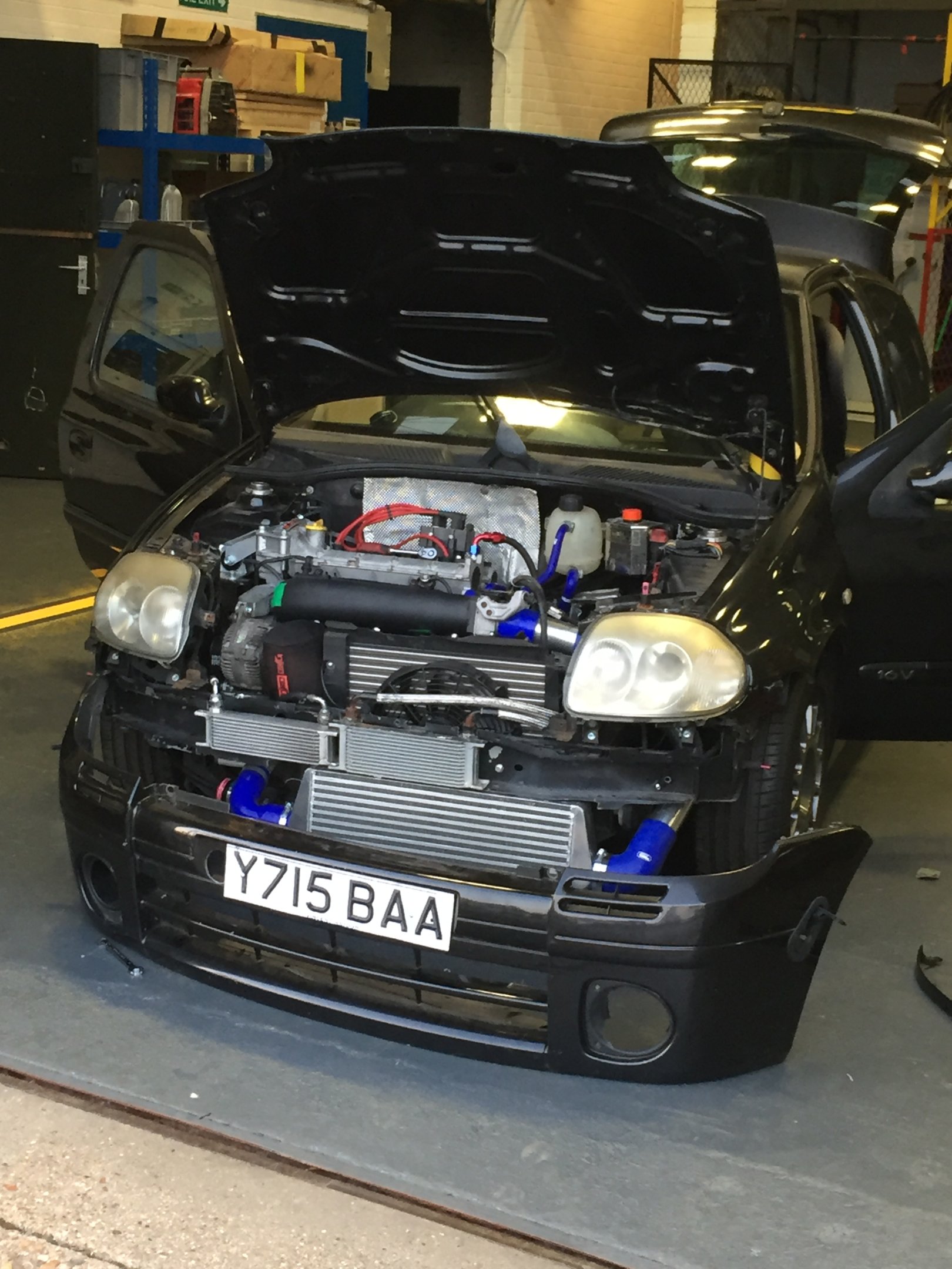

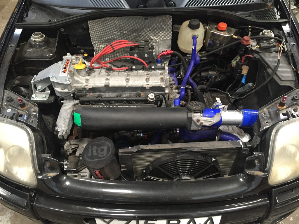

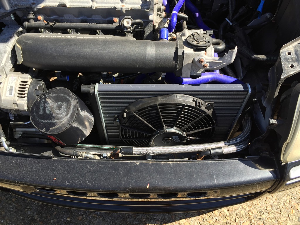

Fan fitted to rad today, now need to pack the intercooler and rad gaps with some high density foam to stop spilling of air
So had a bit of spare time this weekend.
Managed to find a donor car for some bits, so got all my lights, wipers,horns and windows to work so 1 less problem come mot time
I also grabbed the radiator surround and got rid of the idle control motor block, hoping to run idle control through omex, boost pipes are also just about finished

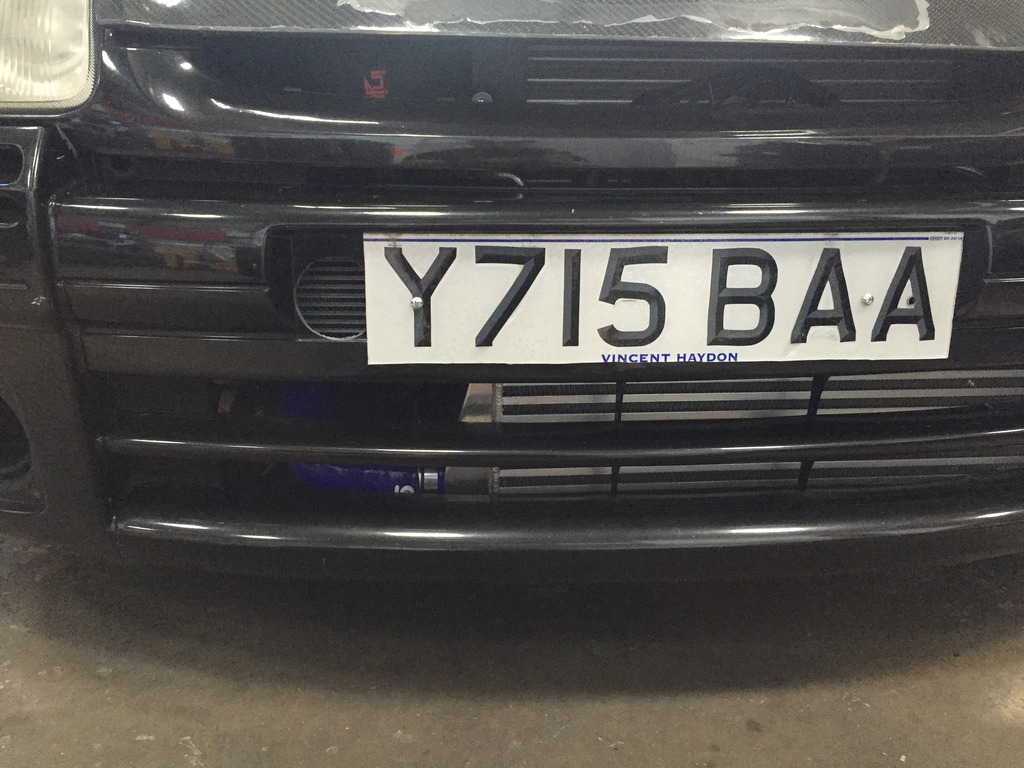

I put the front bumper bar back on as I think it looks far more subtle and will protect the radiator better, I cut the number plate down as a test fit to see what size I needed
It's offset to allow air into s/c oil cooler when plates on, now just waiting on a few sensors and wires for everything

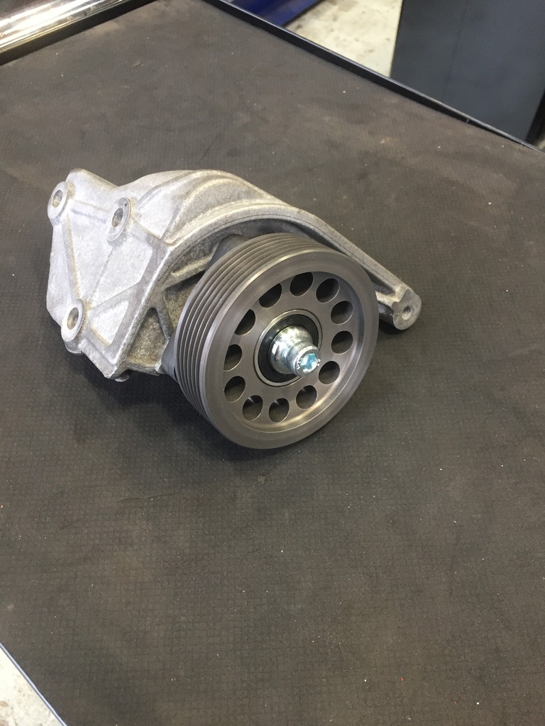

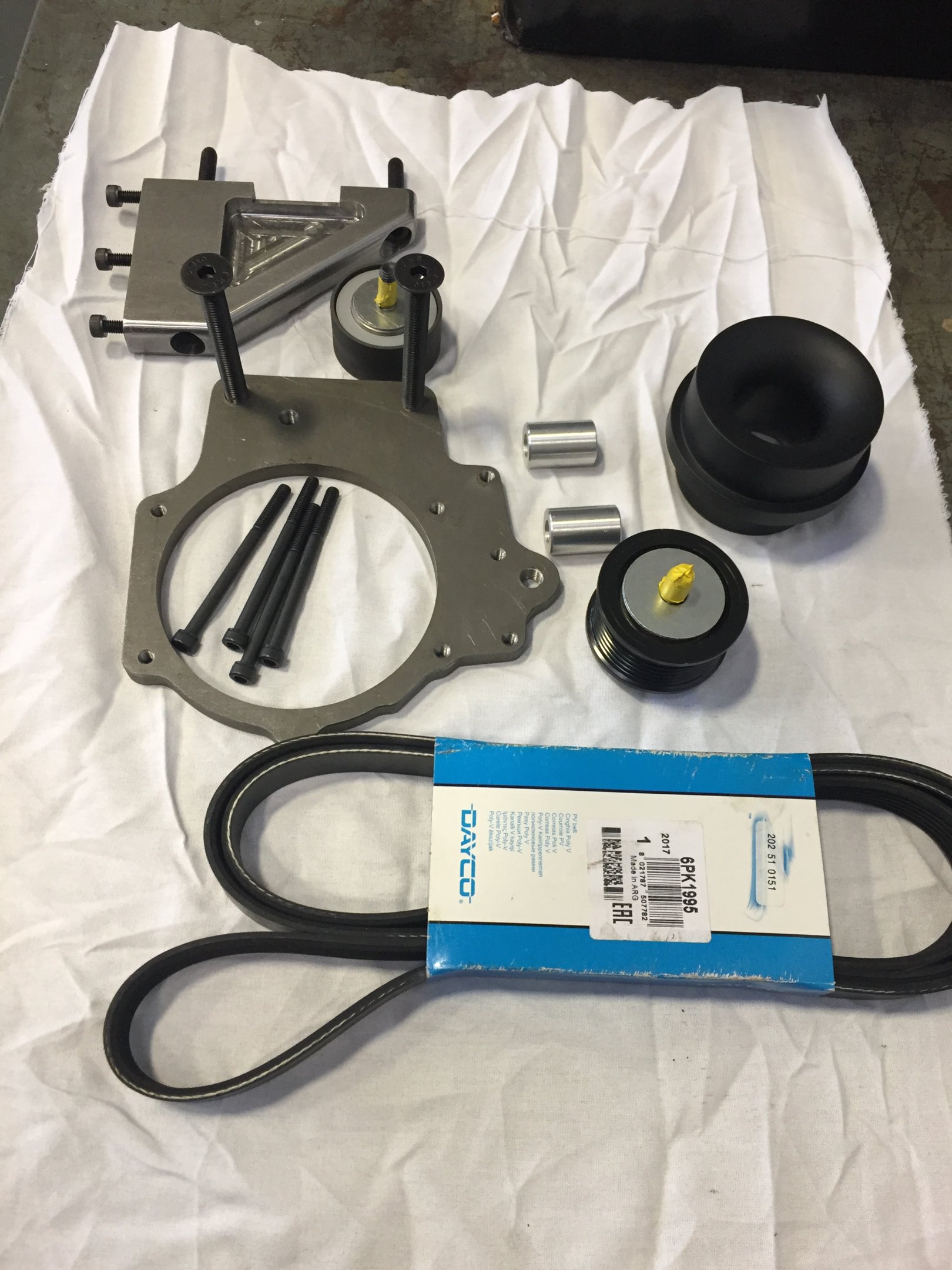

Car has progressed on quite well with the time I had with it , managed to get it all put together ended up using a 1995mm belt as using a 90mm pulley, tight but it fitted

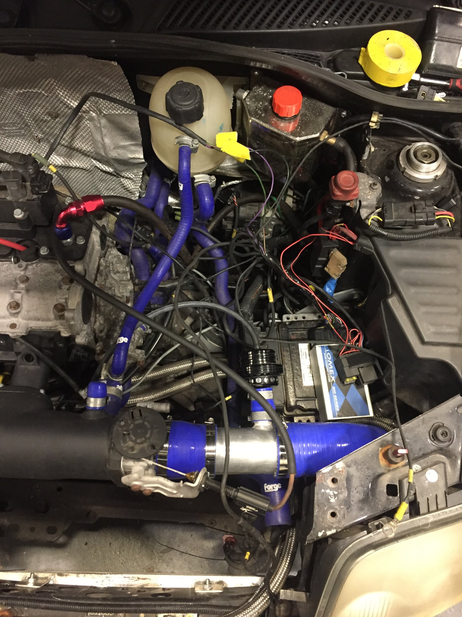

Managed to wire up my 3 bar map sensor to the omex, finished off the boost pipes, charged the Rotrex with oil
Built a spare kit up for a lad in Australia

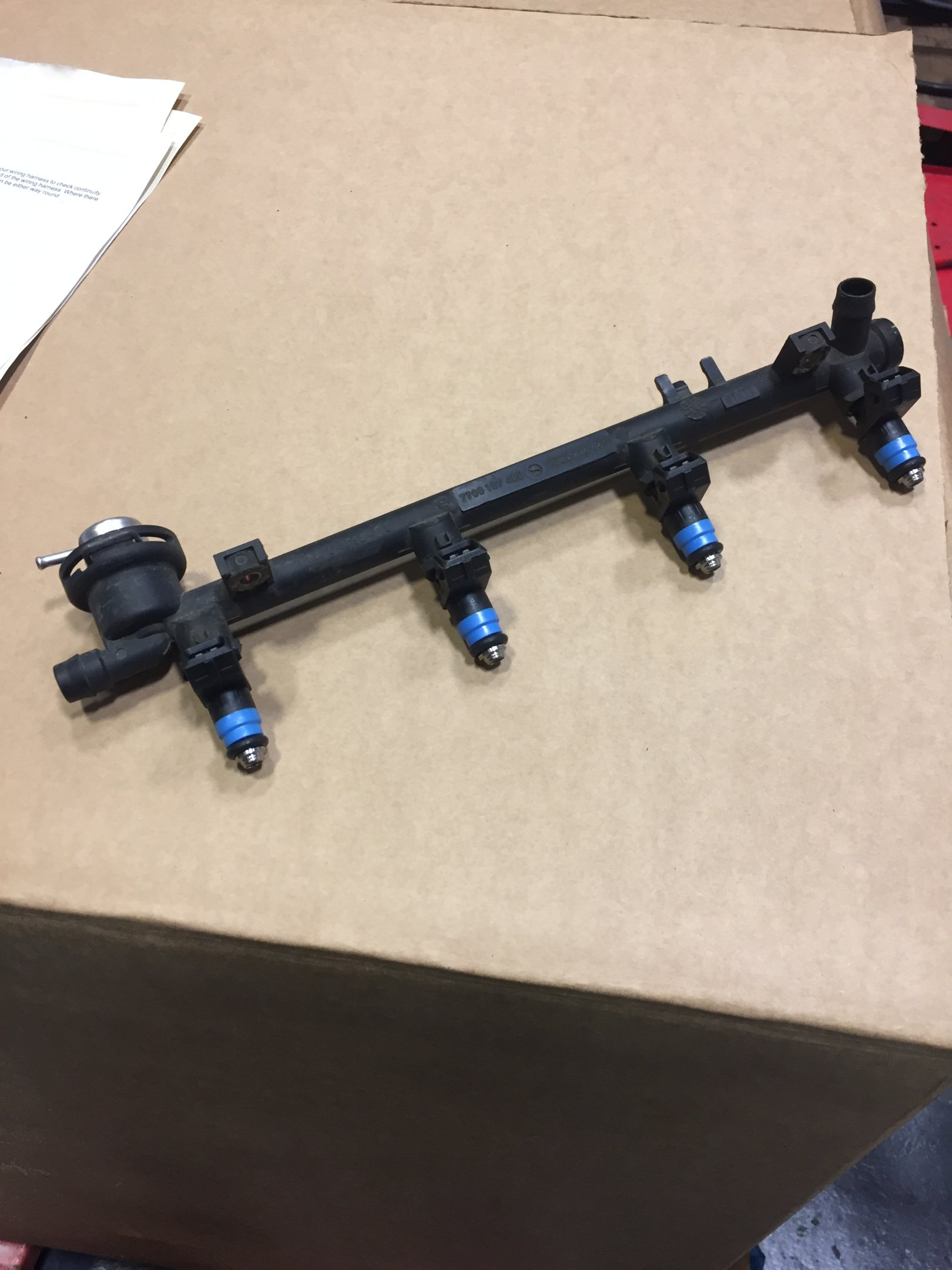

Then cracked on plugging all my injectors and omex in looks like a snakes nest but will tidy it up in time after getting it all running

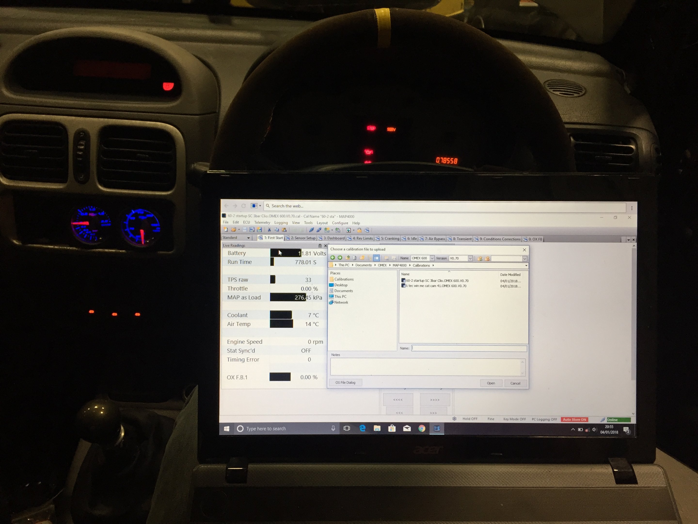

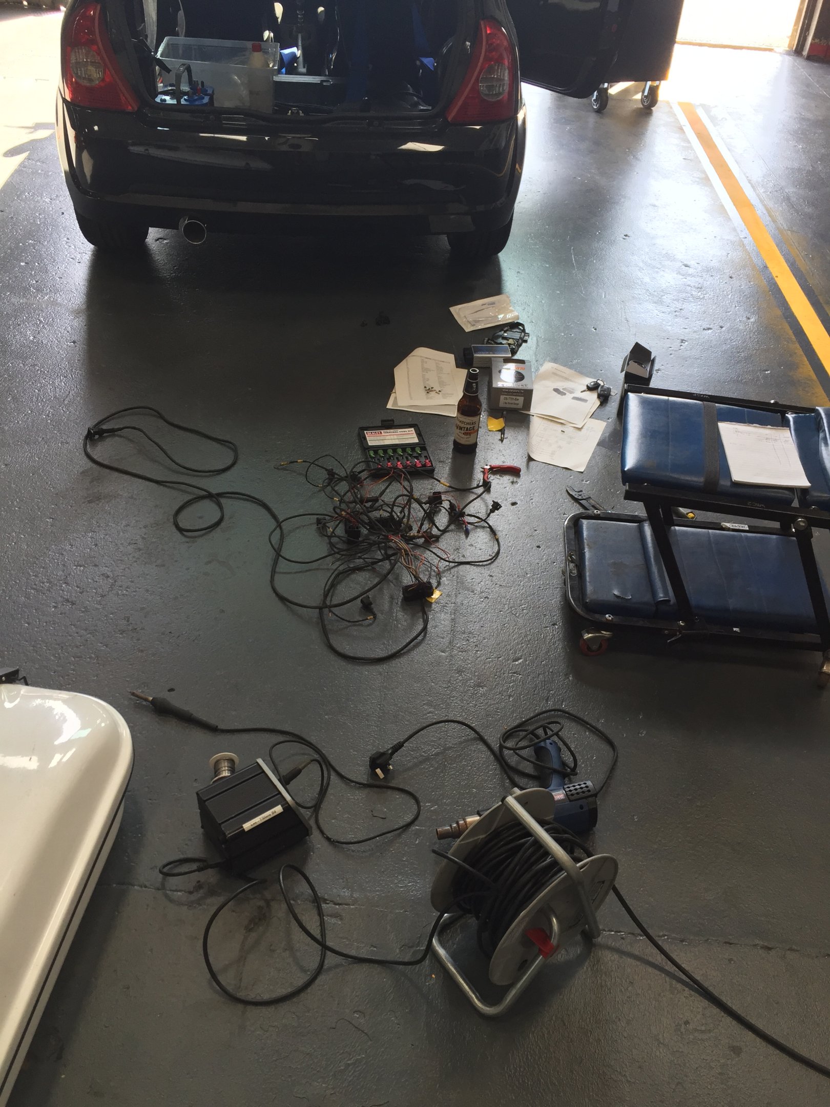

I then banged on my base map, took a bit of pissing about as had to buy a USB adapter to get the omex cable to work
But managed to get it on and all sensors calibrated ready for first start
Good bit of software, quite impressive the stuff you can do with it

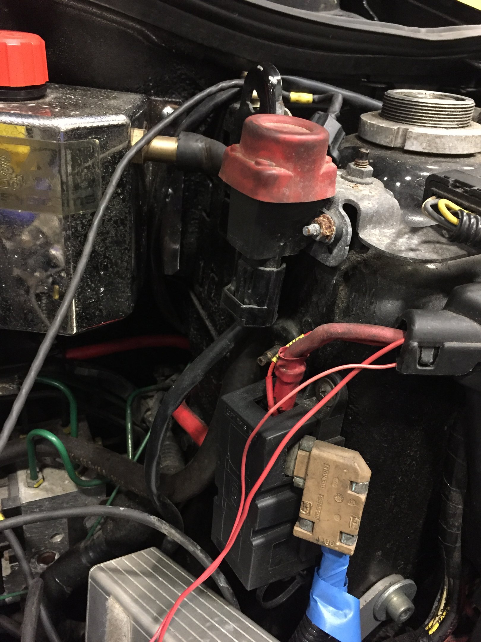

sitting in the car, I noticed no fuel pump priming noise, honestly it did not take me an hour to figure the problem, sometimes it’s the little things mainly this big red button
Clunk, quick turn of key - fuel in the rail -sweet

i'd just get rid of the fuel cut off, seen a couple now that will throw a wobbler going over bumps.
as above, just joint the wires after chopping plug off, did this to mine years ago

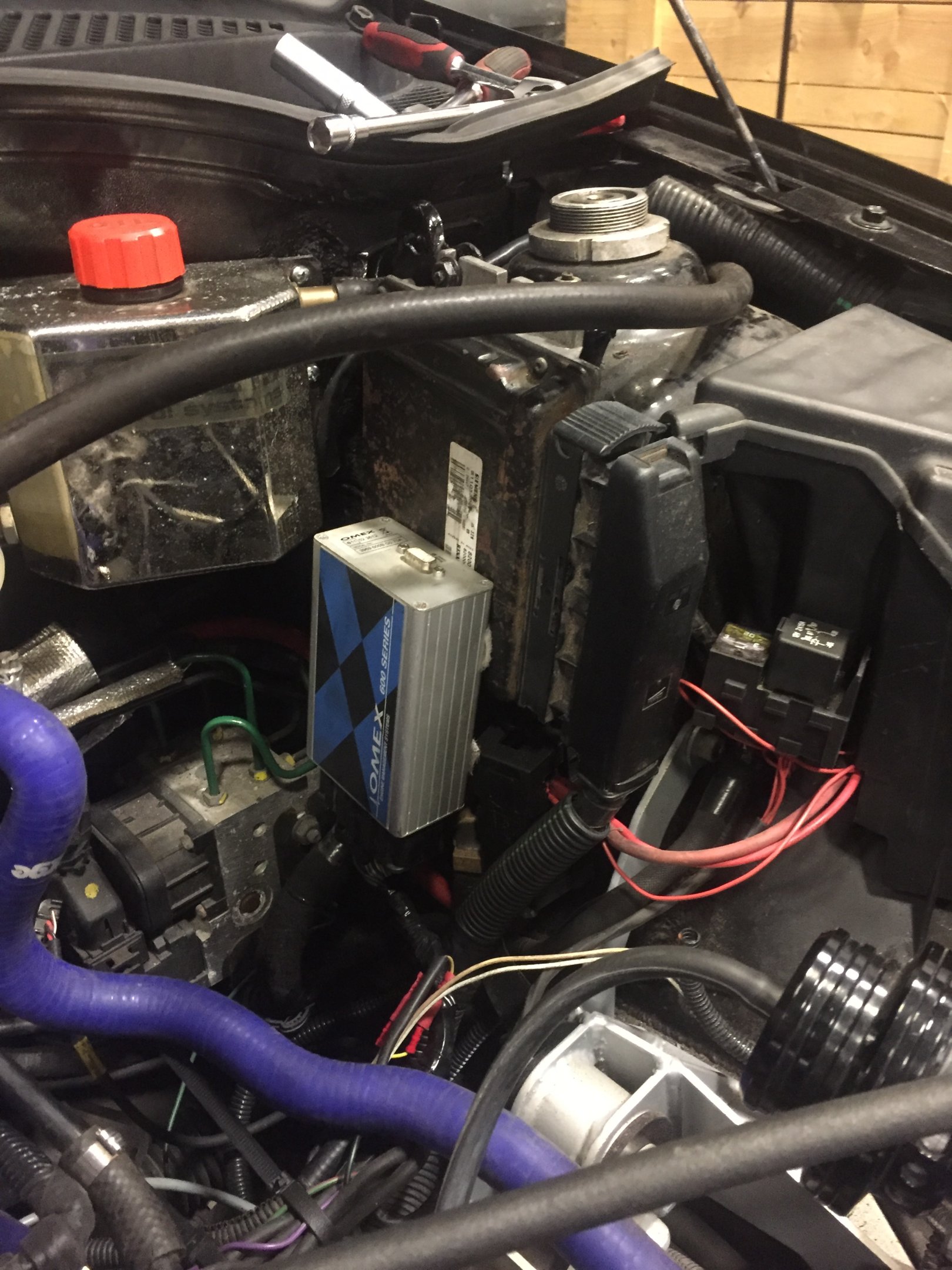

Got a good bit of work done tonight. Was struggling with a plan on how I was going to mount the ecu’s as there was not a massive amount of flat space, little bit of moving about and come up with this
Fairly stable and tidys the bay up quite nicely omex will be Velcro attachable to the ecu
