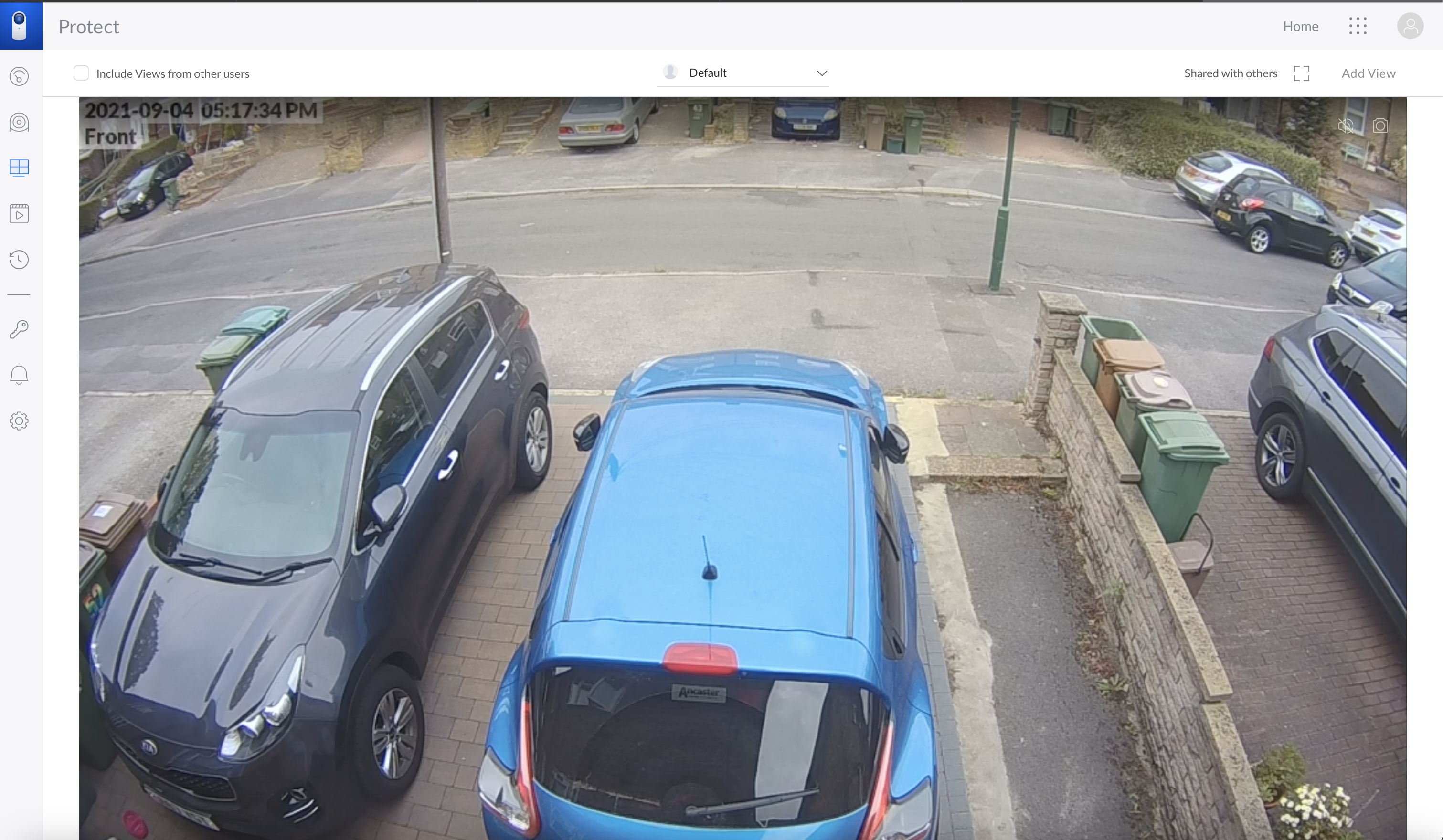

I've got unifi cameras, they're probably not as good as Hikvision and they cost more, but I went down that road and don't feel like replacing them as I'd then have to replace them all if I want them all visible in the same place, the unifi protect software doesn't support other cameras, so unless I replace everything it's not really worth doing, I don't think I'd get more quality for the cost.
I have a camera facing the front, one at the back and one in the shed where my tools are kept, there's additionally a camera in the lounge but that's purely just for checking that the dogs are ok.
All CCTV systems pretty much have the same issue that there are limitations of the optics and whether you'd be able to make out a license plate clearly or somebodies face at night.
Funnily enough though, when I mounted the first camera (front of the house) about 2 nights later I was looking at the footage just to see what was going on and a woman walked down our drive to our front door and then went back to our daughter's car and tried to unlock it, she couldn't so she went to our neighbour on the left and fried their care.

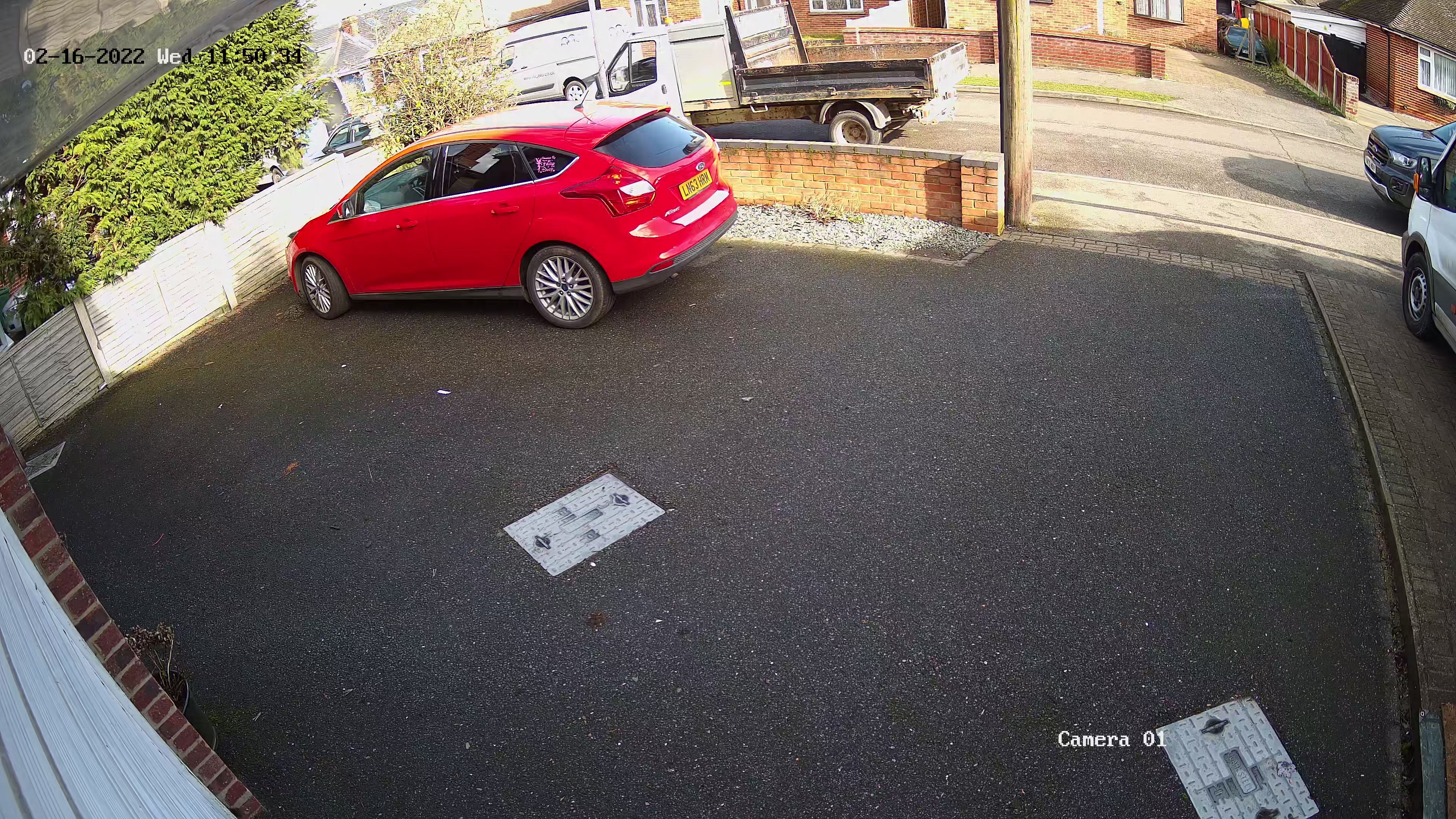

Went for a POE NVR in the end.
Dilemma now is which lens size to go for, 2.8 or 4mm. Will be positioned under a garage soffit so only ~2.5m from the ground and not sure whether a 2.8mm lens would be too wide angled.
leeds2592
  Bean 182 + E70 X5
Depends on what area you want it to capture I suppose.
I've got a 2.8mm on my garage soffit and it's bang on for the area I need it to cover.

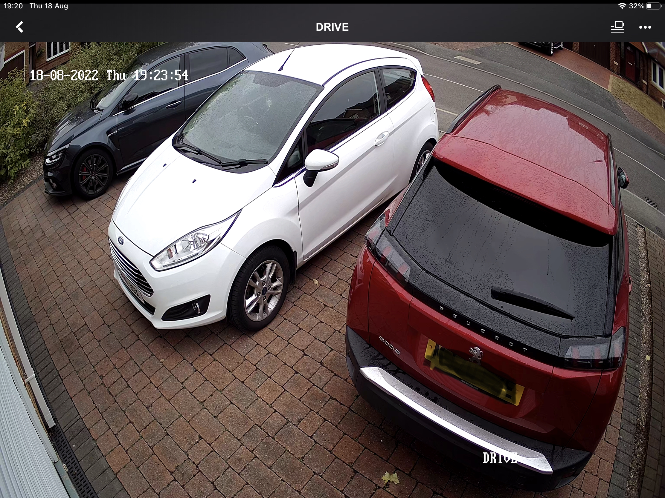

Went for a 2.8mm Hilook Colorvu camera with the white LED for coloured night images. Held my previous camera up to where I want to position the new one and there are naturally some blind spots. The field of view on the previous one is similar to a 2.8mm lens so a move to 4mm would create even more of a blind spot to one side.
This has now caused me to plan an additional camera from another angle.

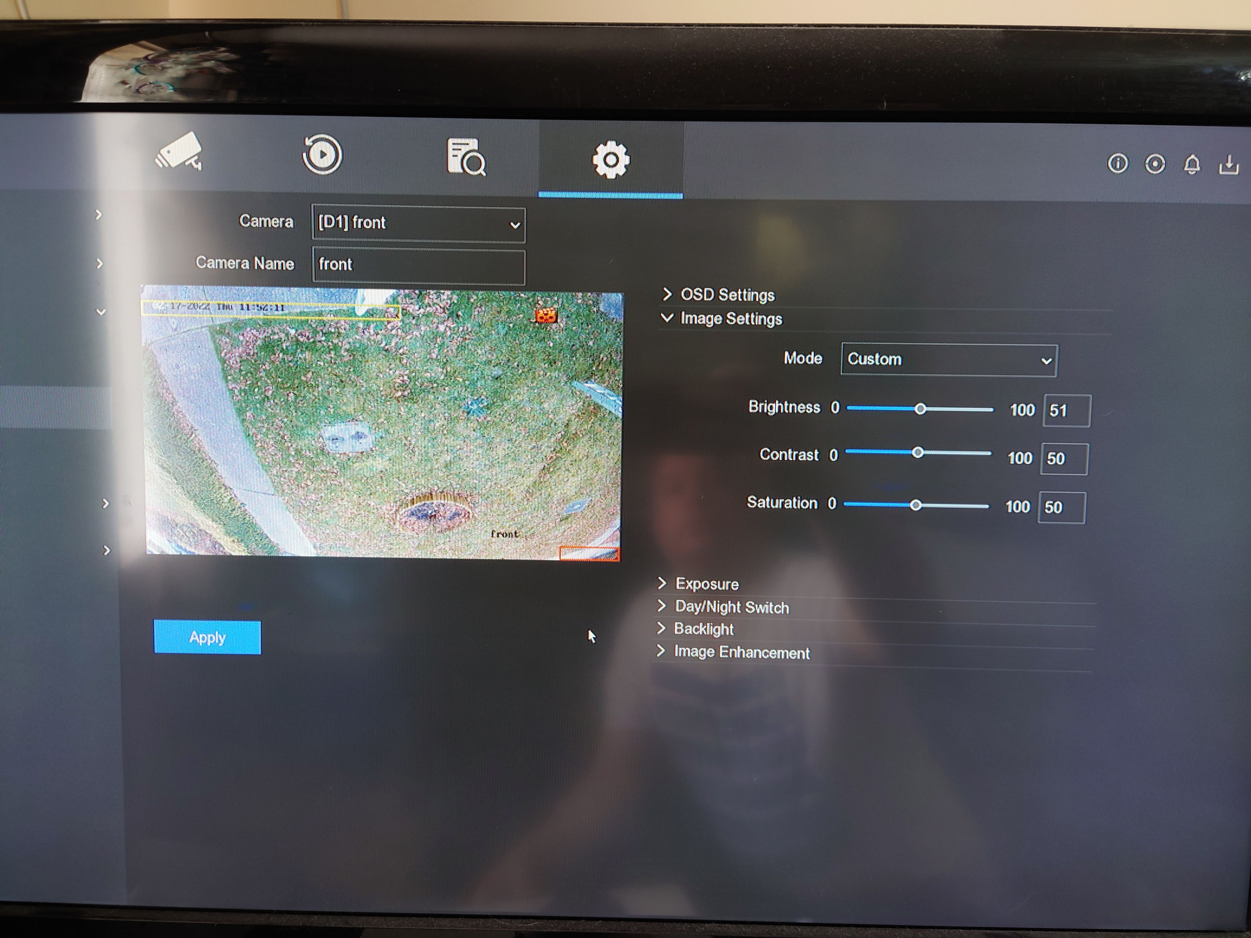

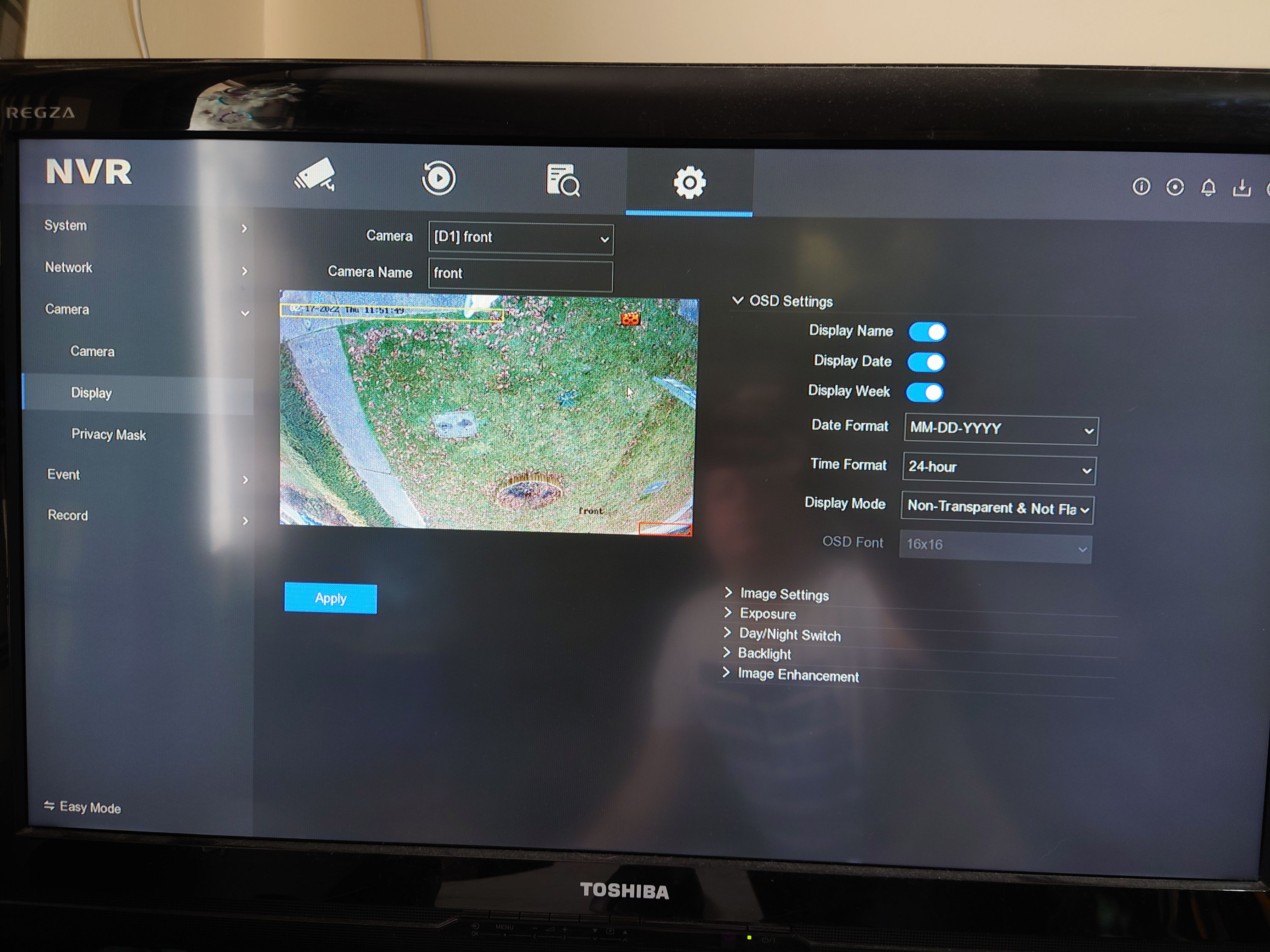

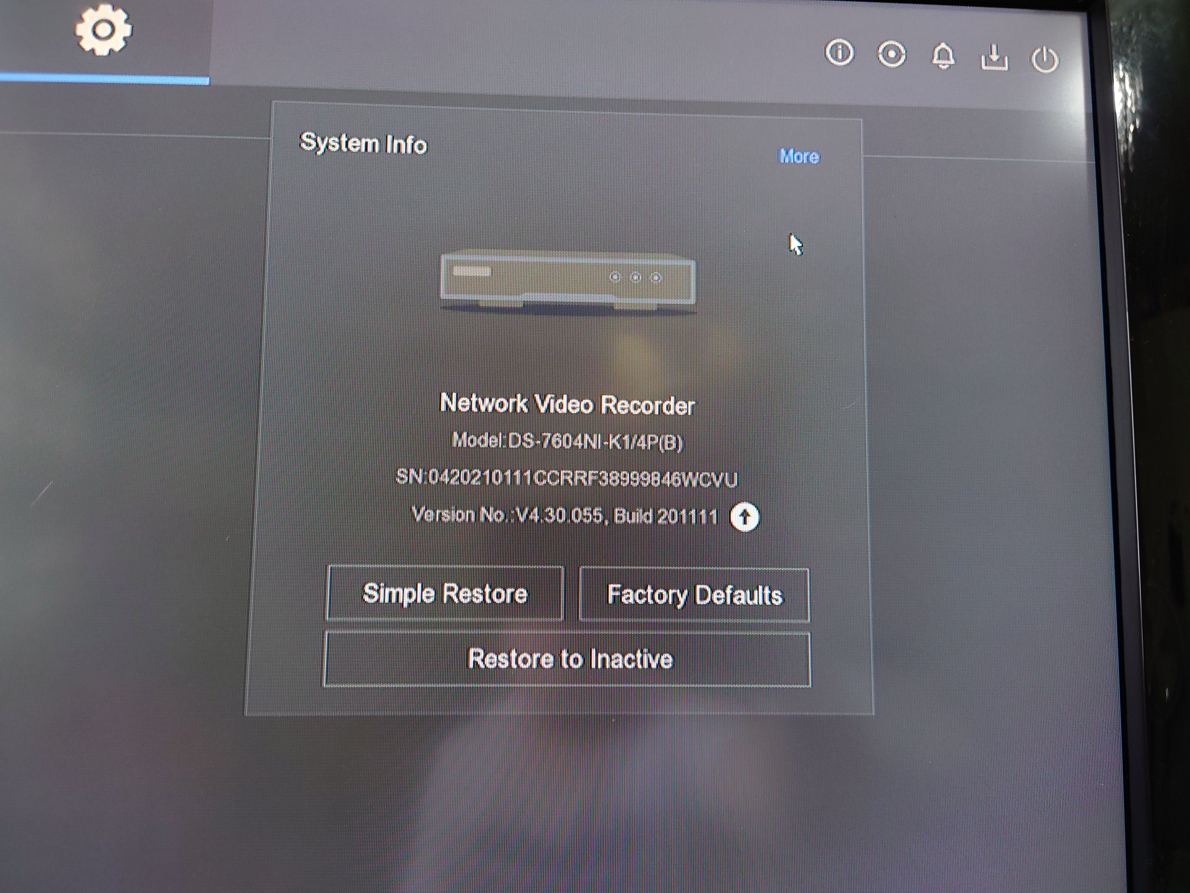

heres an issue i have, CS may not know the answer though
installed a brand new hikvision system today but cannot flip the images. so everything is upside down
cameras -
the manual says -
Image Settings Rotate mode, saturation, brightness, contrast, sharpness, gain, white balance adjustable by client software or web browser
MatthewR
Can you not just turn the camera? It may be a daft shout but when installing my reolink there was a small arrow pointing up but I didn't spot that when installing?
Andy_con
  clio 182
sadly not, the way the housing is designed is s**t.
found the answer, i need to enable virtual host to be able to access all camera settings

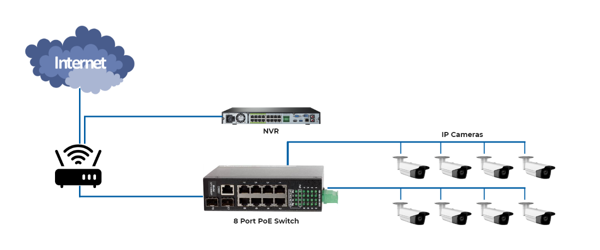

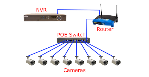

What's the deal with the poe switching? Is that just one little junction box hidden away and then you just run one cable to the box?
rctempire
Works in the same way as a network switch. Just it provides power to cameras and network via the switch
Diagrams to show.
Essentially you then don't use the NVR for the POE side but rely on the switch and then all cameras are on your standard network and all is happier.
Plus helps on longer runs of over 100m of cable, if it came to it.
What i would do its run 2 cat5/6 from router to PoE switch, then patch leads from PoE switch to the cameras. NVR plug into the Router directly (LAN/WAN Port). Avoids having 8x cables all plugged into the NVR and mess really.
