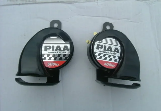

Replaced mine with these from PIAA cost £27 from http://www.priracing.com - much louder!

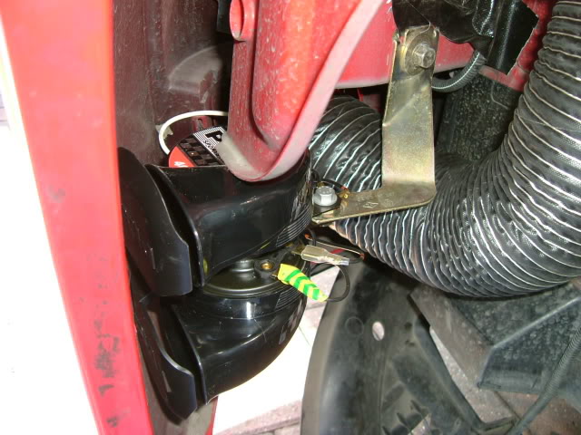

whats involved in fitting a dual horn like that ^^
are the wires already there, so just disconnect and reconnect? surely you have to split the wires into 2 somewhere?
They just work in parallel
Make sure you change the rating of the fuse or first time you use it .. phutt !
