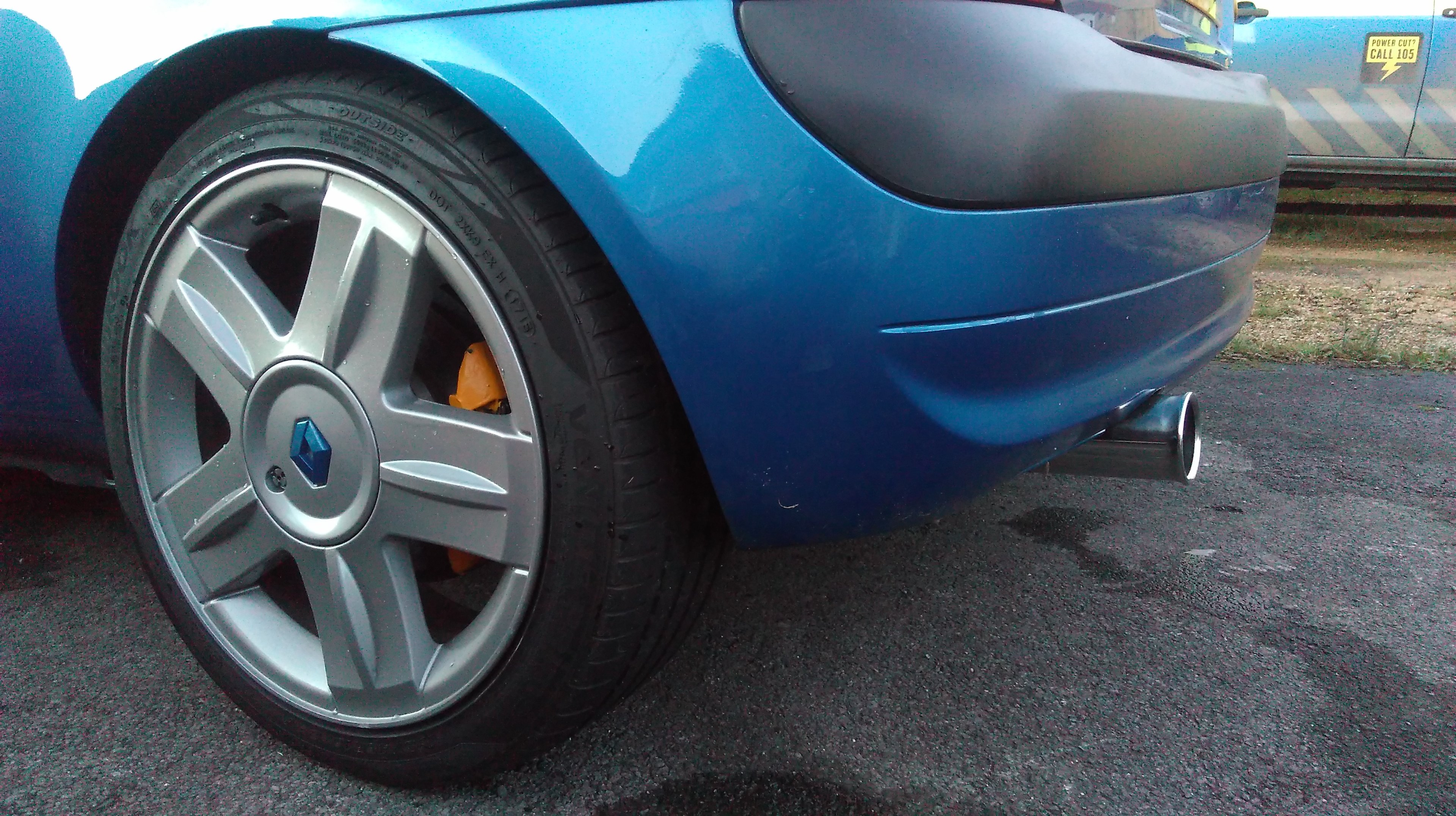

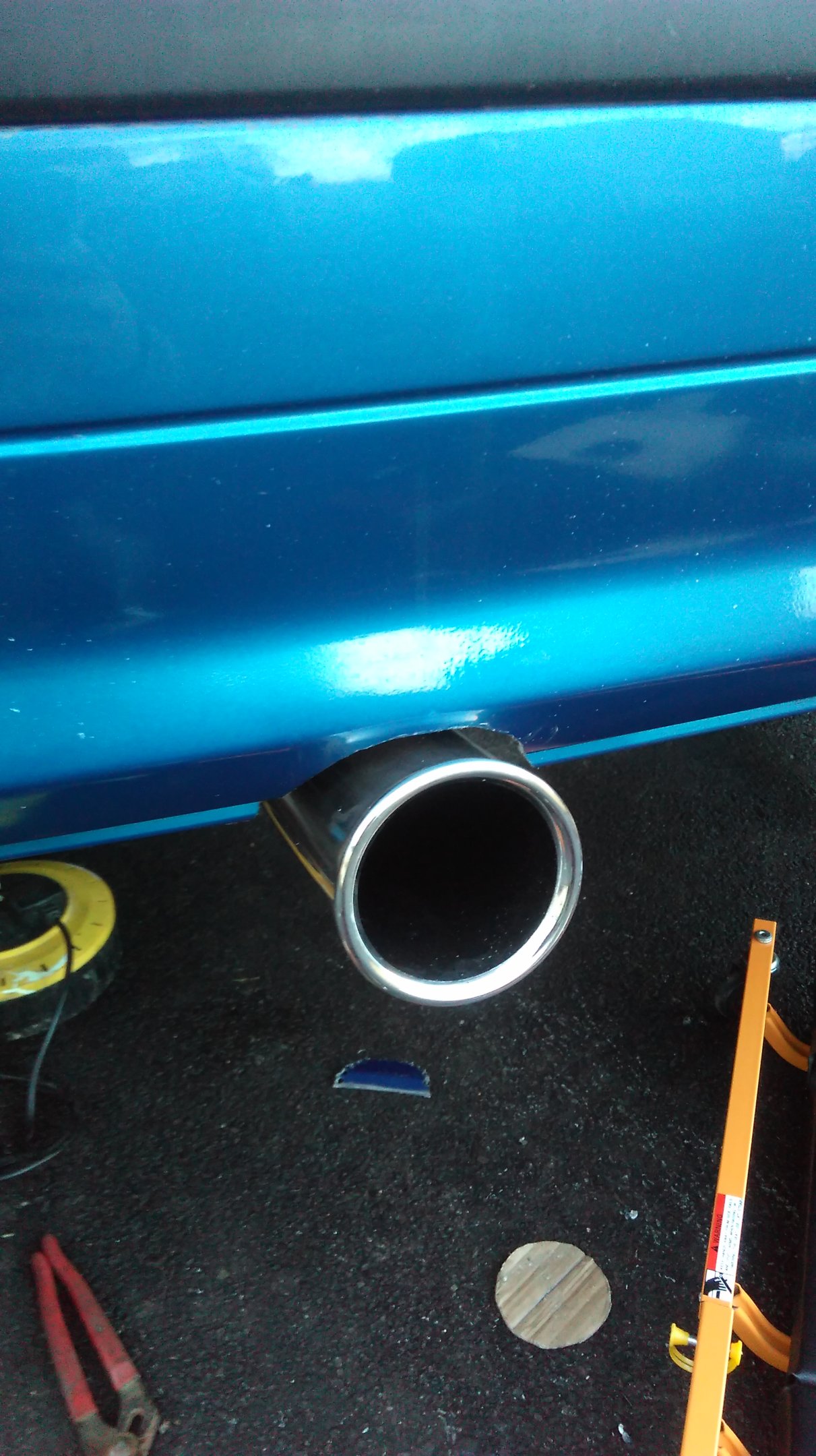

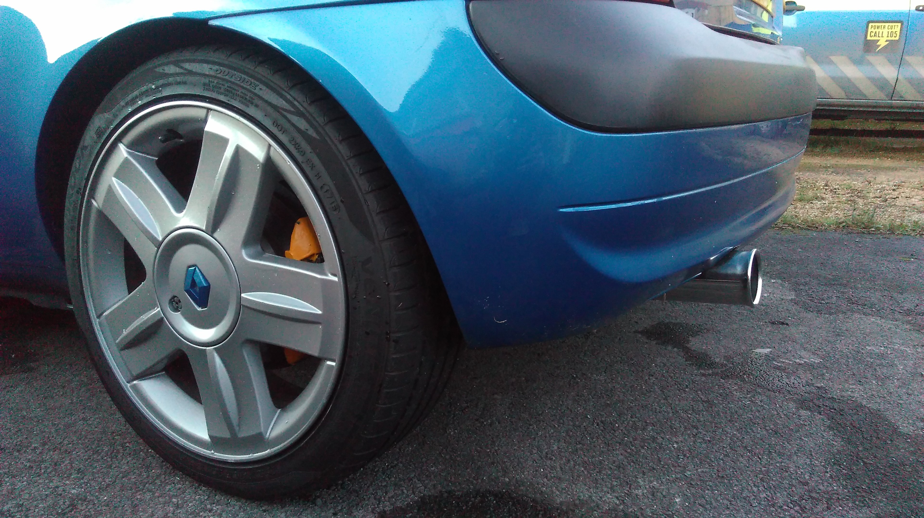

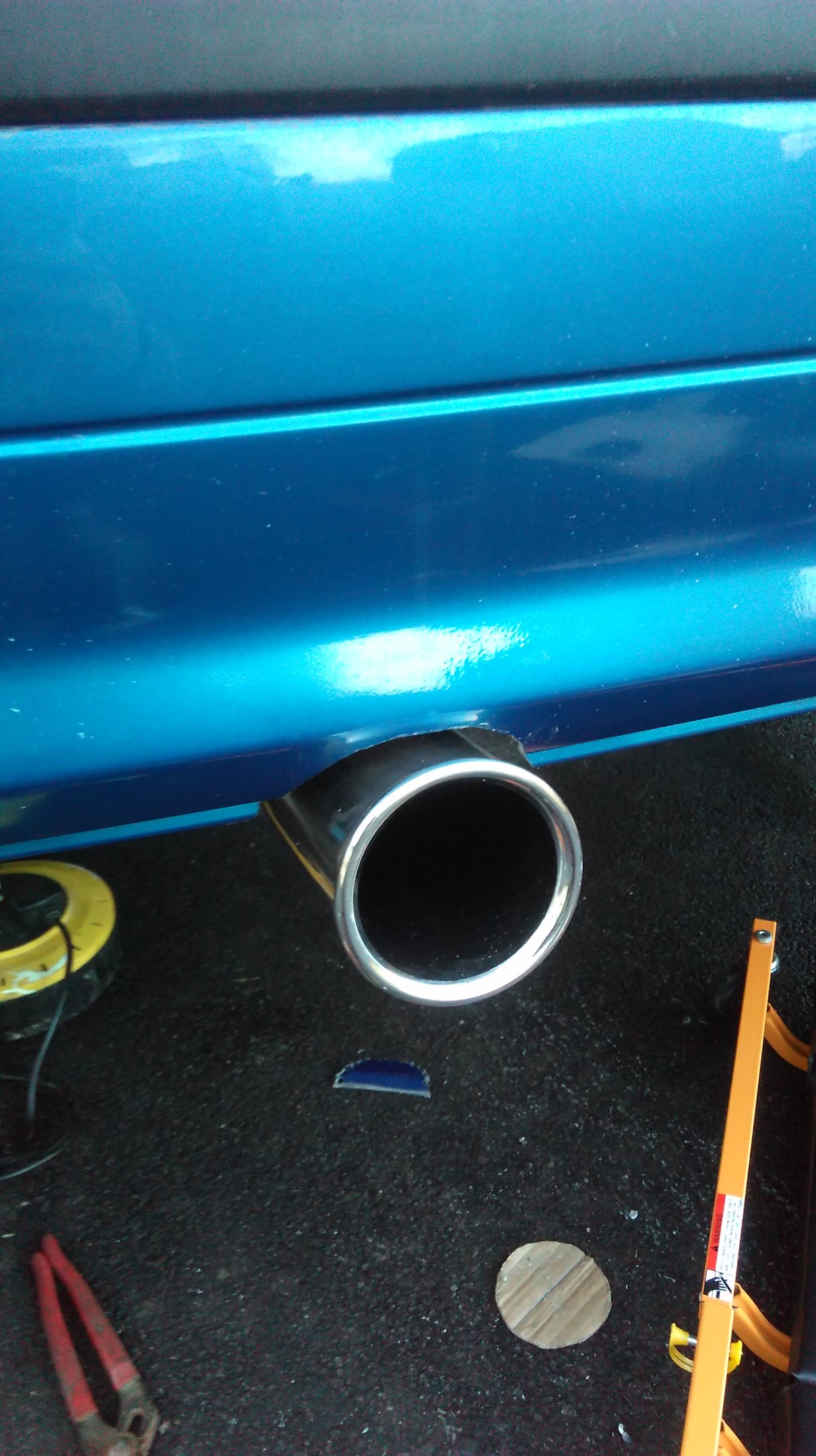

Well whatever anyone else thinks the hornet is installed and I like it , after being told by the manufacturer that I wouldn't be able too recess it there was no reason why I couldn't do it, although half the pipe is still below but better than all below the bumper. You were right @Chris_Beer, thanks , haven't been out for a drive as clutch is slipping but will get a video when that's done
Yeah regarding how much it sticks out dont know why every one of these ive seen are hanging out the back so far there's so much adjustment really easy install only took 2 hours
Well whatever anyone else thinks the hornet is installed and I like it , after being told by the manufacturer that I wouldn't be able too recess it there was no reason why I couldn't do it, although half the pipe is still below but better than all below the bumper. You were right @Chris_Beer, thanks , haven't been out for a drive as clutch is slipping but will get a video when that's done View attachment 1404162View attachment 1404163
Hi mate, I just got a clio and I've been recommended this exhaust, did you need to weld it? And was it easy to install with basic tools?
Yeah really easy. No welding involved, just cut the exhaust in front of the rear beam then slide on. Bit of exhaust paste And a 2 inch exhaust clamp
