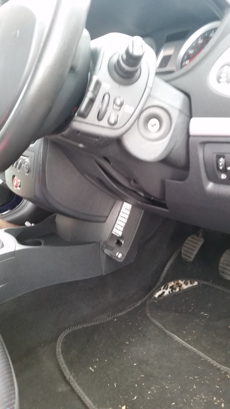

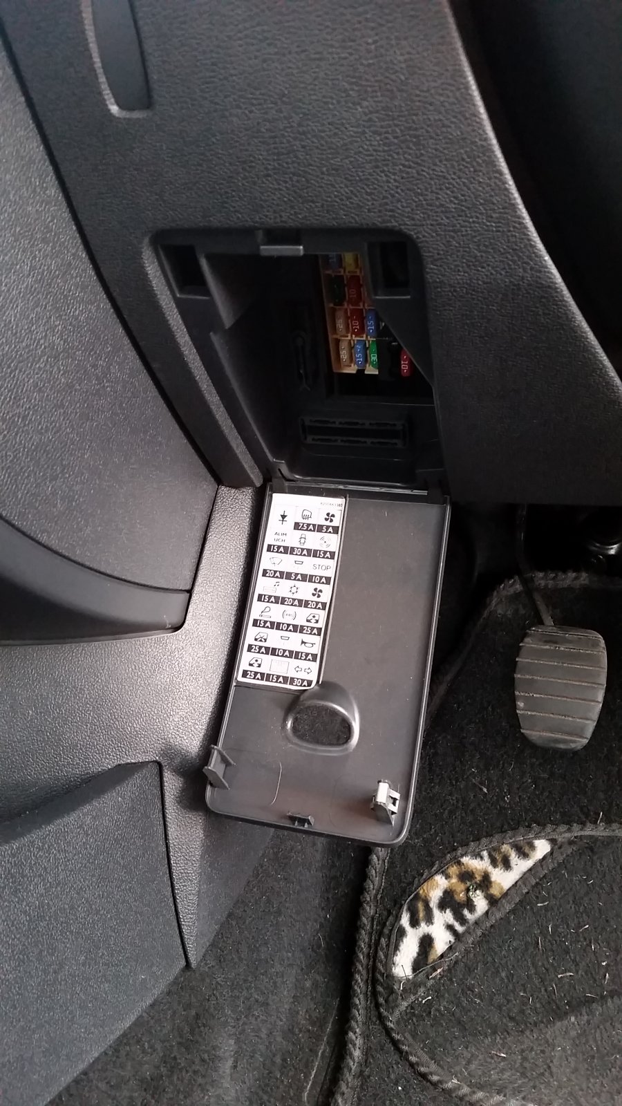

Apologies for the delay in replying, just bought the mrs a Mk3 so I now know where the fuse box is. It's below and to the left of the steering column as seen in these photos
Window fuses are bottom left and 3 up from bottom on right hand side, 25 amp and a sandy sort of colour
