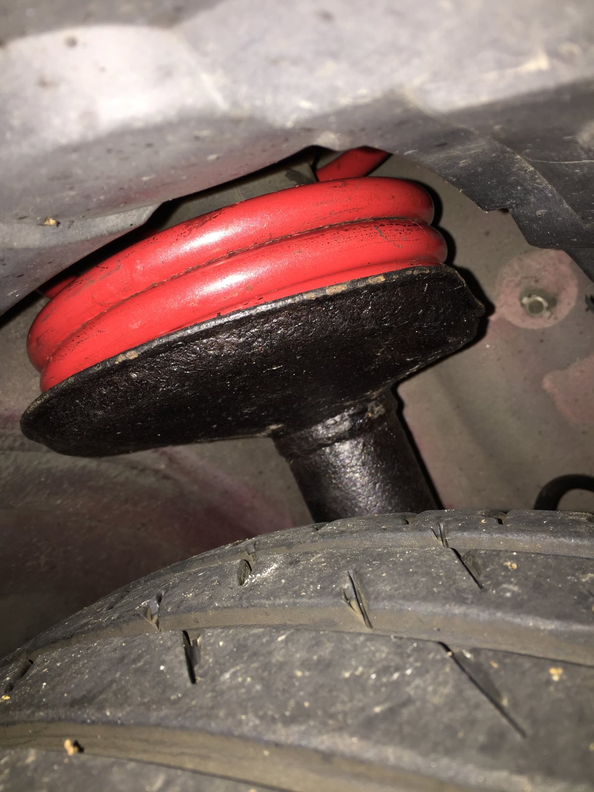

I've just fitted some used Eibach Sportlines and noticed that when I dropped the car back down the coils look like they are touching at the bottom - pic below - both sides look the same.
Does this look right or have I dropped a clanger (duff springs or poor fitting)? The ride height has dropped about 15mm from the springs I took off which I assumed were stock. I also fitted solid ktr top mounts at the same time.

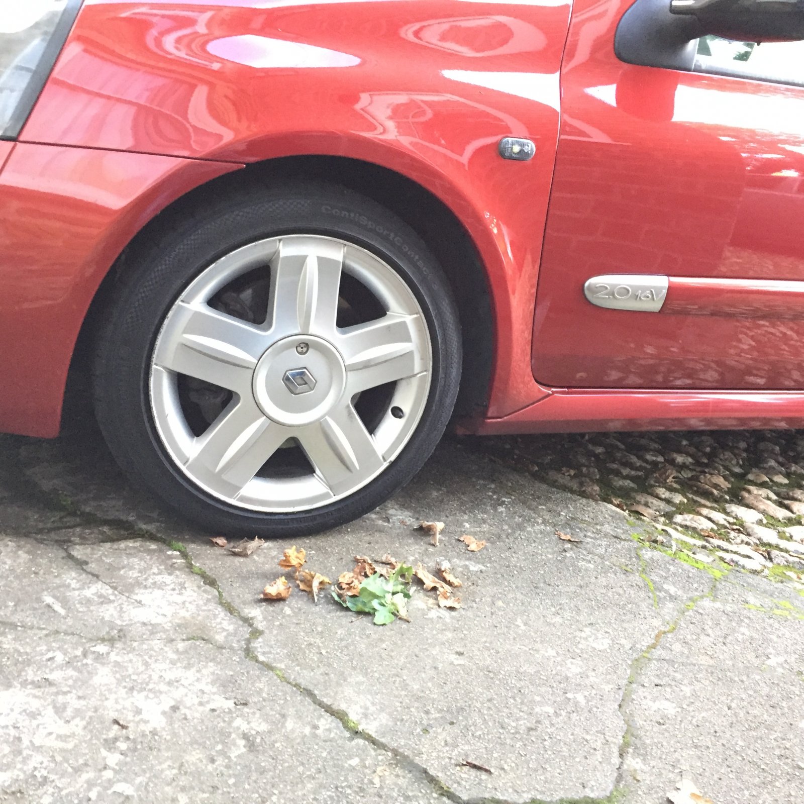

No, wheels firmly on the ground, after being taken for a quick spin up the road & back.
Sorry, I might have misled you there, I stuck the phone up inside the wheel arch to take the photo.
Here's the gap...
If the spring was broken (too compressed) I guess the drop would be too much rather than too little?
Thanks for the responses :up:. But do you know whether the coils of the spring are supposed to be touching each other at the bottom, as in the picture?
Pretty certain my old prolines used to touch, there was definetely a noticeable wear line on the lower coils
These had wear lines on the lower coils too, which implies, I guess, it was like it when fitted to the previous car :up:.
I'll see how it goes over the next few days :cool:.
