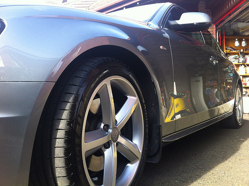

Some pics of my other motor:
Great pics of Holly too!
