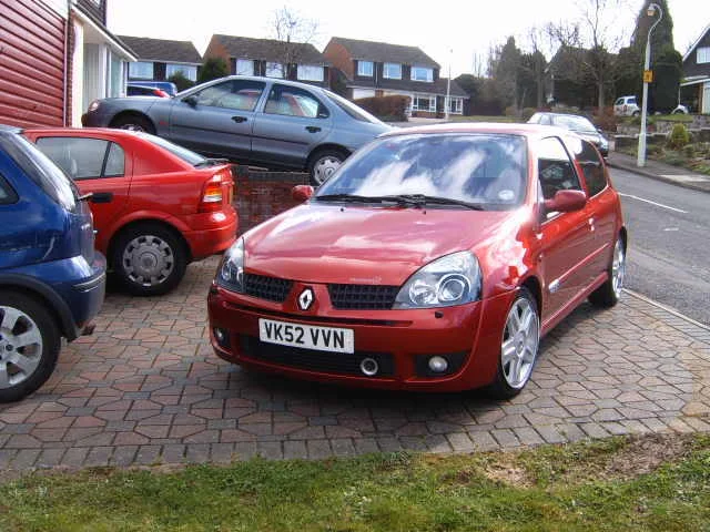

as above really. do i just need to cut a circle out of the plastic grille at the bottom of the bumper? will the trumpet not just drop out of this?
i couldn't see any other way of doing this?

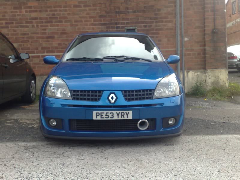

I put mine in my lower grill and put the feed up through the arch
this is what i did.
but imo i should have put it behind the grill. the airflow is just as good and then you dont have to cut the grill. (unless you want the trumpet look)
It's easy to cut the hole mate, just remember it's better to make it smaller and cut more off than make it to big because you cant put it back on.

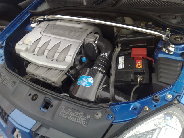

Did anyone else have any problems running the ducting?
My radiator bracket got in the way a little.

cheers. i have got 80mm ducting and i don't see how i am going to run ut un-restricted to the front grille
Ive got the Maxogen as well. My duct runs from the front grill and up to behind the head light stopping just before the open end of the filter just to get more cold air to the general area.
Im going to have a better look at the week end to see if I can unrestrict the route a little but mine is slightly ovalled where it passes the radiator mounting point.
