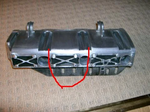

Just started to polish the fuel rail protector and having a bit of a problem. How do people get in here? My fingers are too big so what else can I use? Thanks in advance.

A few on here have just left that bit.
We are making up some small mops for the machine polisher on the one we are doing at the moment.
on mine ive just cut a small piece of wood which fits in each slot with room to spare and then rapped wet dry around it.
