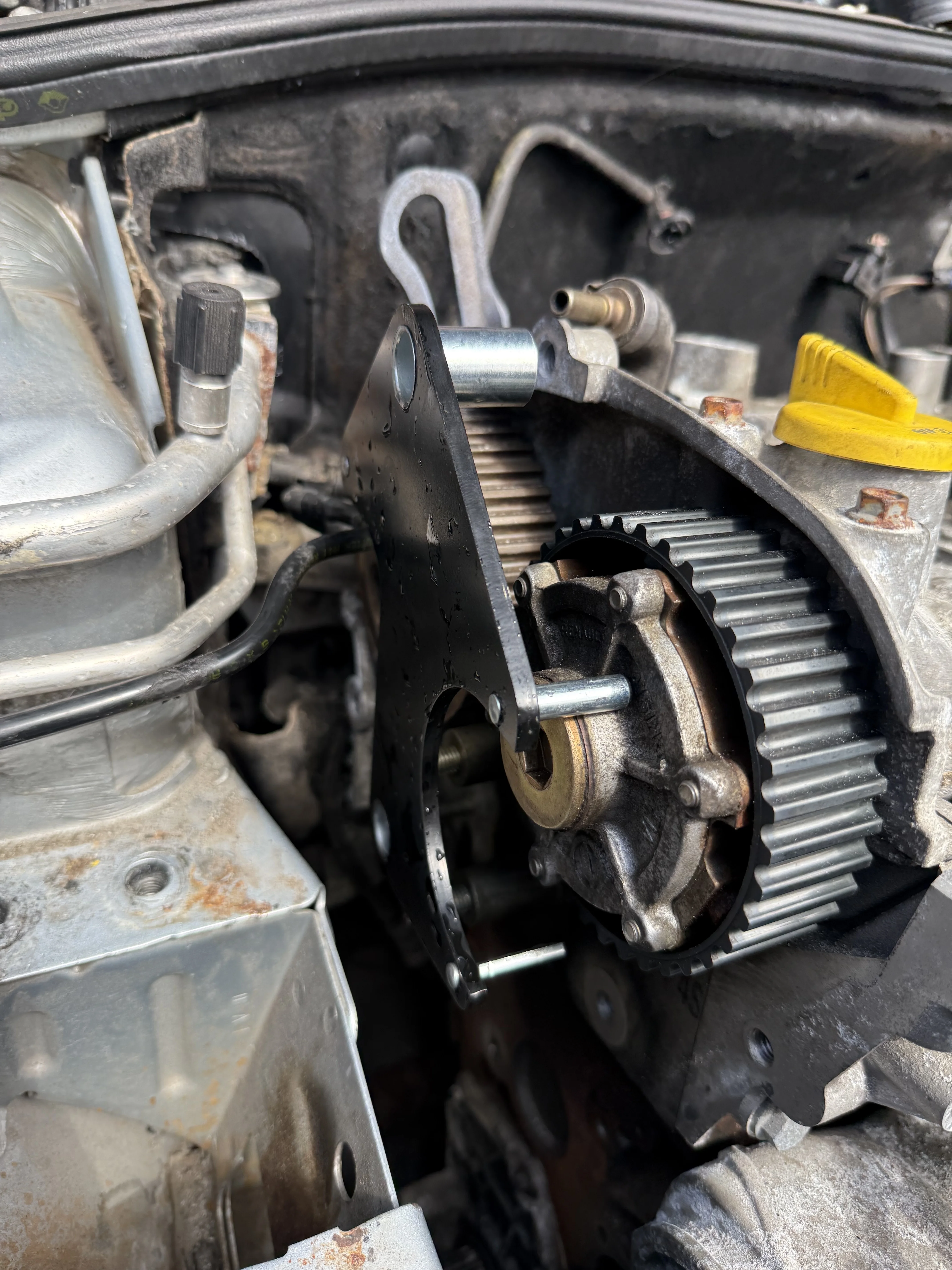

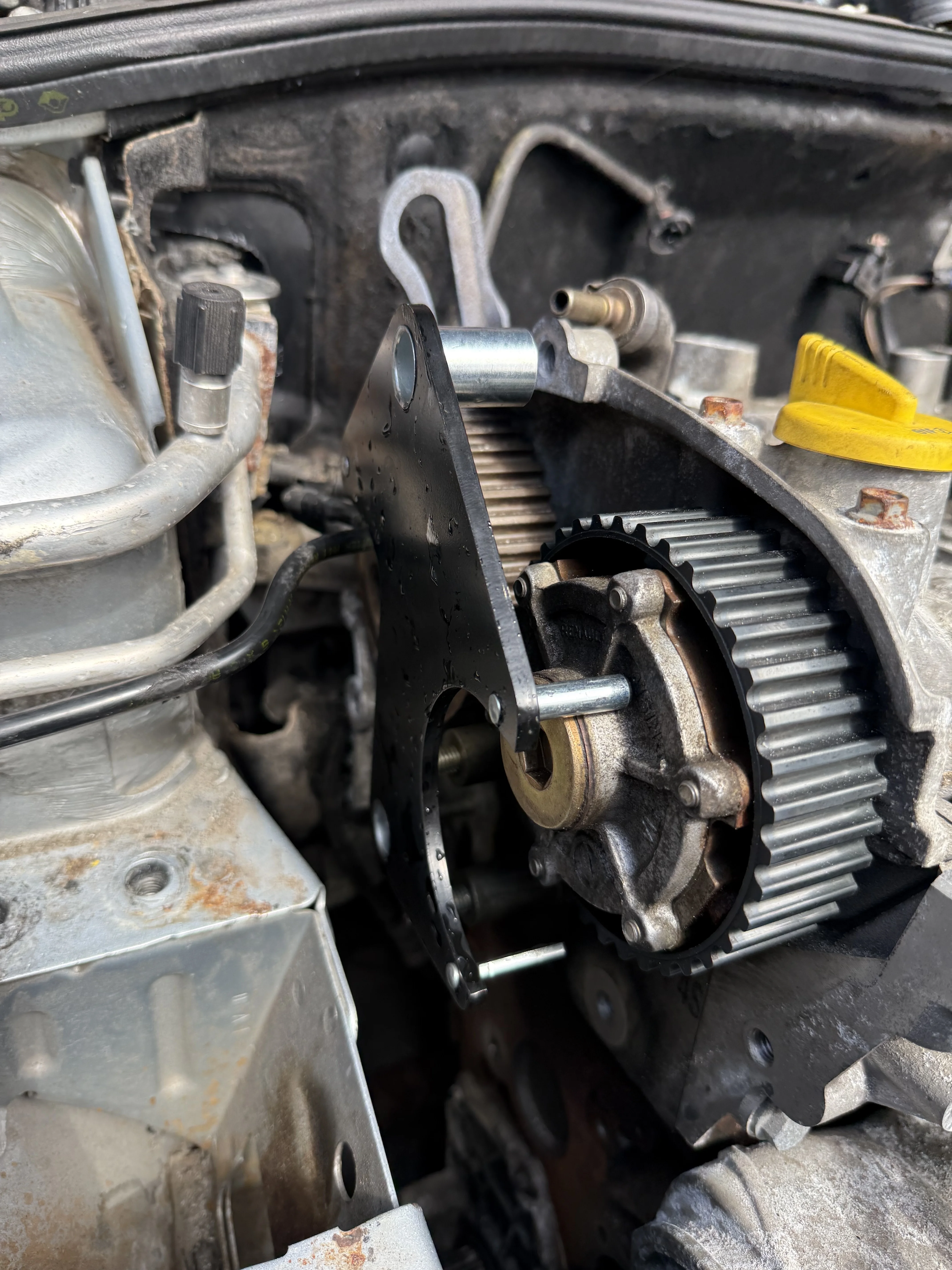

Yes, I know it’s a cheap naff tool but I couldn’t exactly spend £300 on a Renault one.
Anyways, how does this fit?
Anyways, how does this fit?View attachment 1796049
Leigh, so Greater ManchesterWhere are you based Jake?

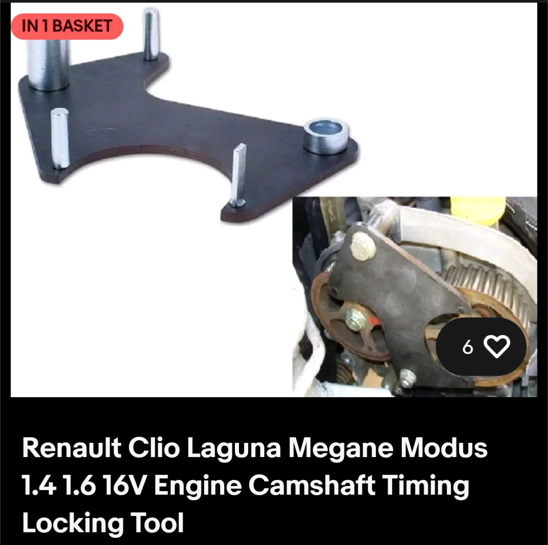

Does the OEM Renault tool work on non VVT and VVT engines. Seen one of hire at £80 buts it’s for a non VVT.
Thought they would be different.There is an additional cam pulley locking cog with different offset for the dephaser pulley, the set on eBay for sale doesn't look to have it

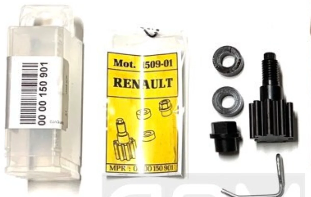

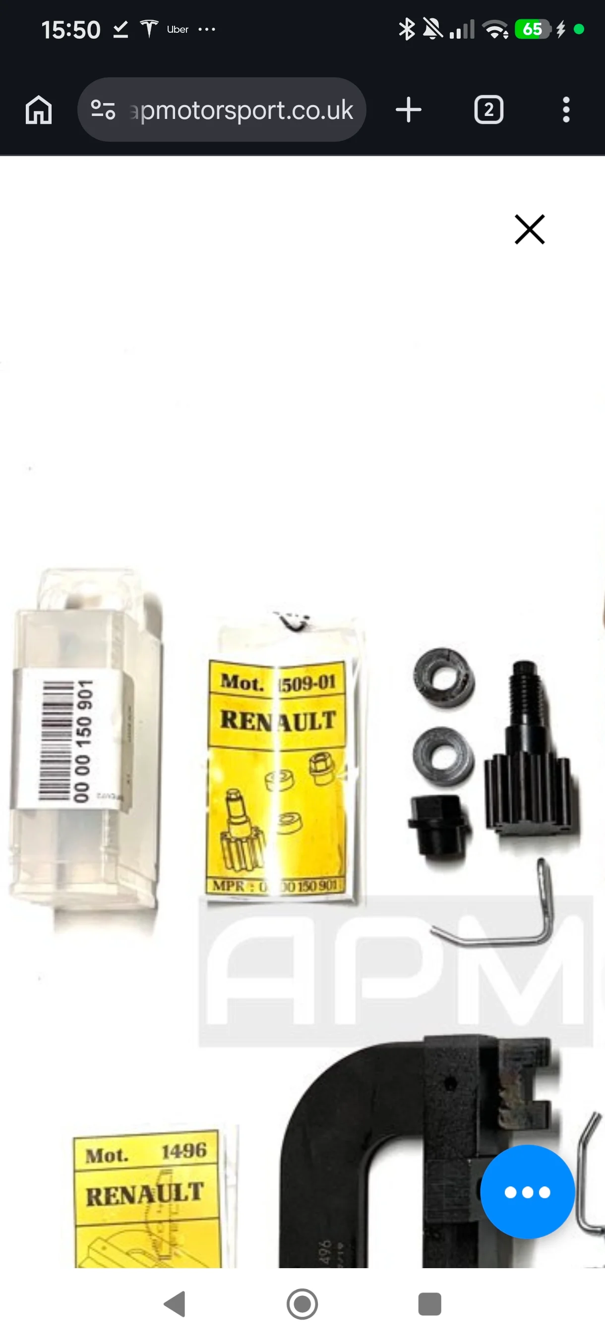

This is the part you need for a dephaser pulley
