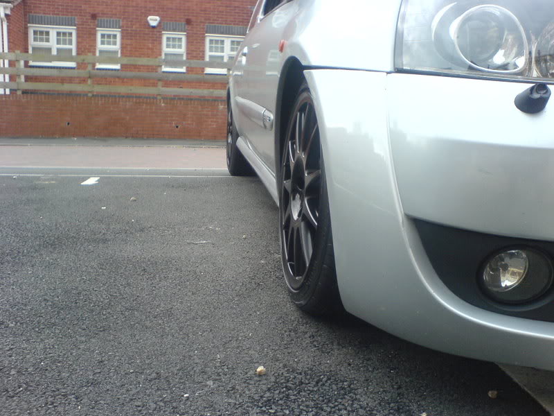

Pics plz ali :D

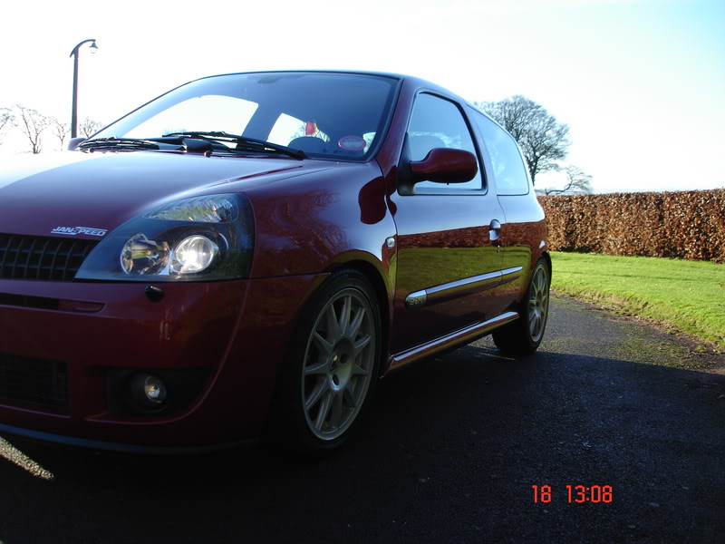

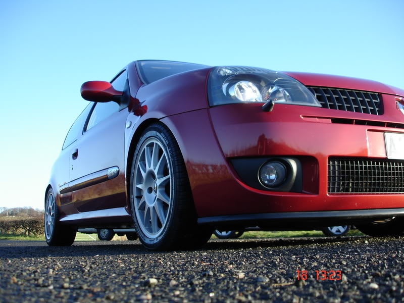

not the best pics to illustrate. but it's lower than this now!
Yes you need your camber, tracking, and basically a full geo done - pref a MS one.

I have modified bump stops ;) - plus its been raised about 10/15mm since the above pic.
