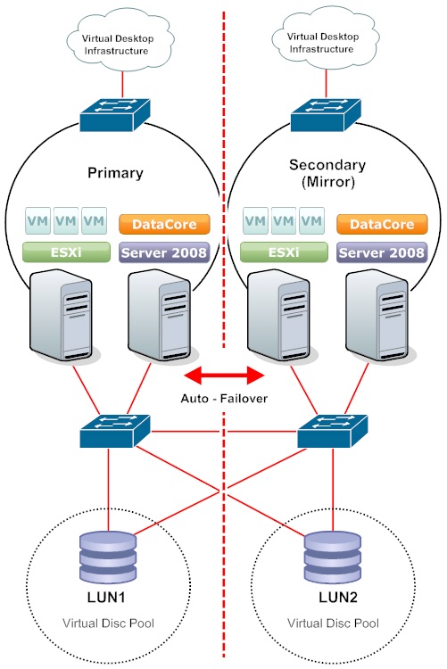

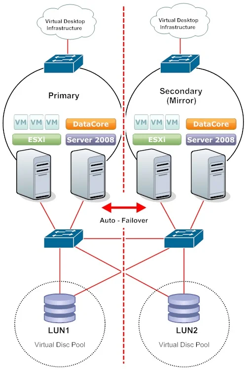

For just the VDI solution I was thinking two servers to cater for the hosts, then to implement redundancy/resilliency in case one of the servers, or the NAS storage, or network hardware etc goes kaput then it can fail over onto a secondary mirror.
This is an edit of one of my diagrams, just one server for the desktops and another for the storage - this isnt my final diagram. This is on one office site btw. My old design was this one, mirrored again to provide DR at a second site, it was for an old assignment.
I see what you mean about using the third server. Kind of like planning for redundant throughput in a way with networks, only this time with a server. Two servers can cater for the lot, but the third provides a bit of resilliency and extra performance as they are evenly distributed between the three. One goes down and the remaining two can cope for a while until the third is put back in place. Cheaper than having 4 servers mirrored......
hmm, didn't realise you were using that s**tty san wannabe software rather than a real san, how many spindles does the storage server have (or do you not need that detail)? for vdi, it will need more than you probably think.
I don't really know how that software works, i deal with hardware SANs (which admittedly are running software on them, but they are proper sans from the main vendors, not a build your own type thing). So the data core sits on windows 2008? And the 2 data core servers (acting as the SAN) mirror between themselves for resilience right? then the ESXi boxes, you have 2 of those, although i wouldn't draw it and set it up like this personally, the 2 storage servers go together and the 2 esx hosts go together, then you have 2 iscsi switches i'm guessing, again, all 4 hosts would connect to both switches, not how you have set them up. You'd also probably use stacking switches too, like cisco 3750's. Your cloud where it says virtual desktop infrastructure, thats actually the esxi servers, think you mean the thin clients, which are not the VDI part really. Theres also no need for a line down the middle of the image, thats only if you have 2 sites, same site means everything is logically in one site, you wouldn't use a line to signify a mirror really, and by having the esxi server in the secondary (mirror) circle you are insinuating that the machines are replicated (mirrored) from the primary, but they aren't, each host would have different users on. Thats how i'd change it (i see you say this from an old assignment, they don't really sound very similar so i would start from scratch on the diagram)
If you're going to have failover nodes i.e dual nodes on the front end, I hope you have redundant switches and redundant NAS. For two nodes, depending on how you have it, I would consider using local storage, it'll be quicker. Less complicated and cheaper.
Then backup from the local storage to a local NAS box, then replicate that NAS box off site.
