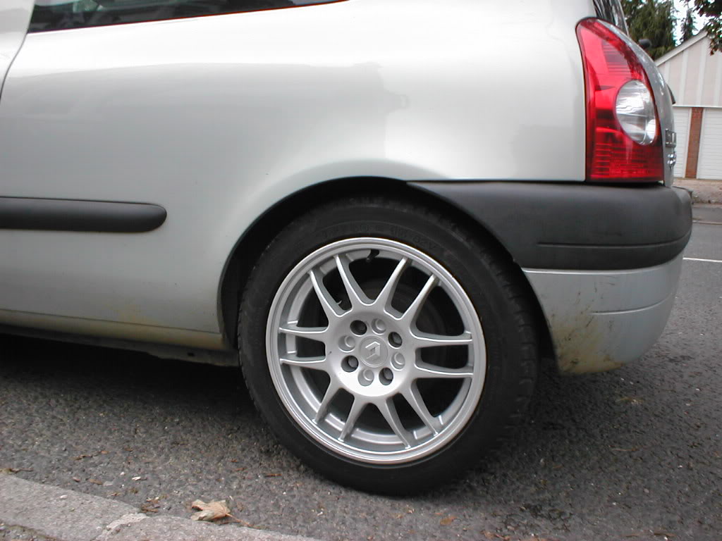

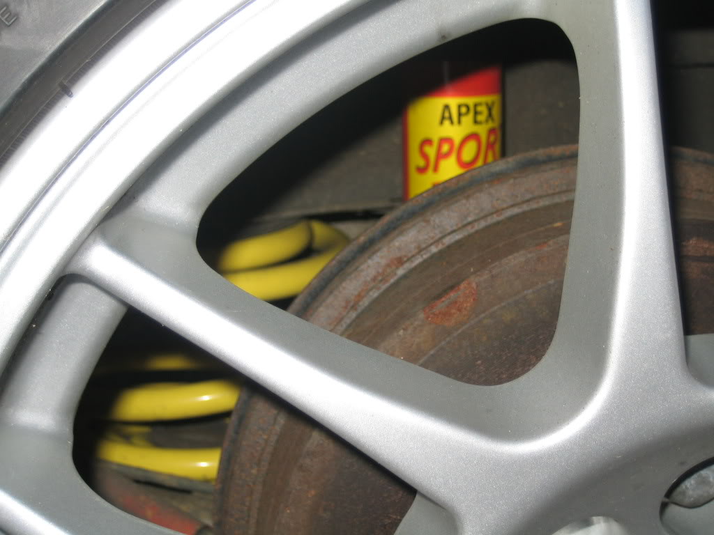

I'm on 15's with 60mm drop. I think you can go to 60mm on 17's without any scrub. But you won't be anywhere near scrubbage with 15's and 60mm with a full car because the springs are so stiff. I've got the apex kit and deffinately recommend it for the price.

I like the look of that, got me thinking of getting a set of 17" now :approve:
should i get a set of 5 spoke or a set of multi spokes?? at present i've got a set of 15" fox racing 3 evo's (multispokes) which i will probably sell.
what suspension setup have you got?? uprated springs and shocks or uprated spring on standard shocks??
which springs/springs & shocks are you running on??

go for the springs & shocks and if thats your budget defo go for apex mate - £260 boys from www.motorsportworld.co.uk

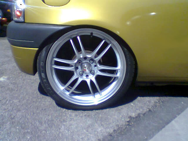

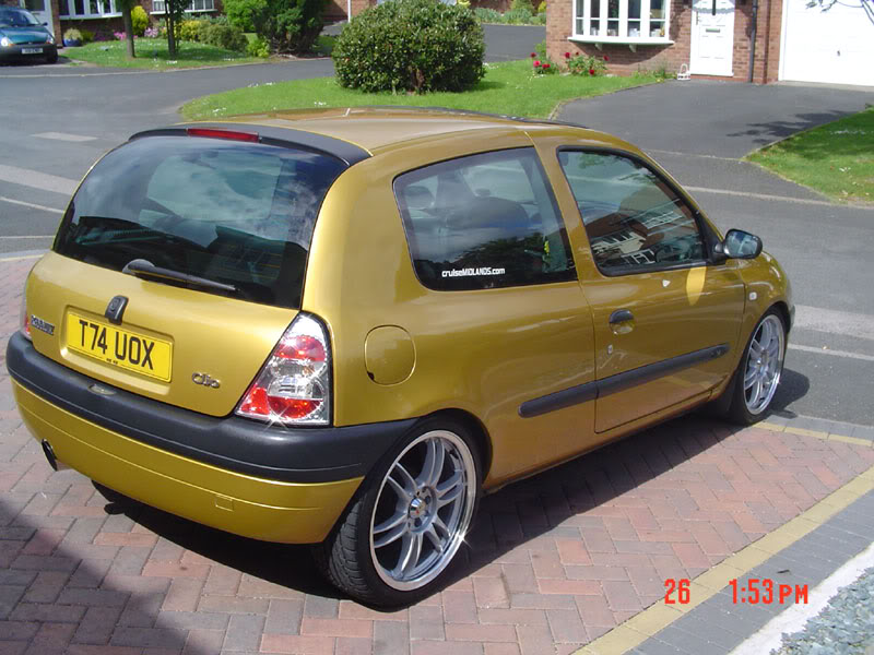

what model is that crazy clio? not a fan of big wheels on clios tbh but everyone to there own, I do like that gold colour though hardly ever see them.
