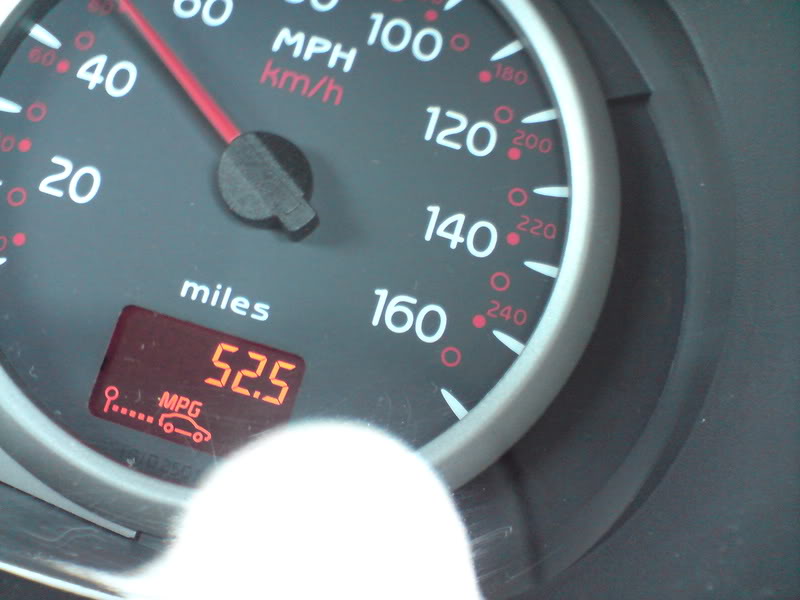

Mine did, read my project post, did 15/20 miles down the m4/m25 at 50mph with an empty car with my foot just resting off the pedal, yes i was driving old man style but i was a happy boy to see that :approve: , never did that before the re-map & de-cat, only managed 43mpg :dapprove:
Yep thats true, soon as i took it to 70 on the a30, still driving easy it went down to 46/47.. then got to the lights.. & erm cooper s wanted some fun.. 34mpg :o
