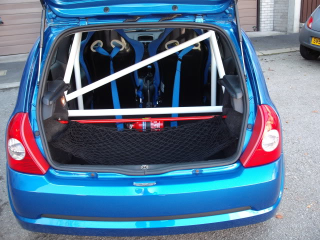

Okay im expecting the comments 'use wood' but seriously im stripping the car tomorow, and i would like a flat floor all the way to the front seats. But surely it would wobble and flex because there is nothing to hold it behind the front seats.
Maybe something like this??
  106 GTI
Make a cardboard template then either make it from mdf or be different and cover the cardboard in a cloth, afterall its what 197s are made from
  Ph1 172 + Combo van
Just copy what he has done above. no need to cover the rear footwell too.
To stop it rattling or making a sound whack down a bit of loft insulation under the wood. Id also advise screwing it down some how. Maybe cut holes in the wood above where the isobar fixes, then use the bolts with some big washers to bolt it down there.

Yer i wasnt going to leave it loose but i want it to be perfect, maybe i could use some soft insulation to support the wood closer to the front, any other ideas?

Cover over the hole that teh door card has left with some cardboard, glue gun it in place. Carpet over it. For the flat floor just use some wood, though it might be a good idea to have a couple of strips of wood, going from the back of the seats to the back of the boot, then cover over them with cardboard and carpet it. Only reason I would say not to make the whole floor from wood is it would be a pain to put in!

For all the weight of 6mm ply. Not even 1/2 a sheet is needed. Do it properly its the best way. The ply is sturdy enough not to flex and doesnt move around if you get a tight fit :D

Yer well i have put the door cards and the side boot plastics and carpets back in looks much more tidy now im going to get a sheet of MDF or plywood and make a flatfloor.
  Petrol Blue 182.
I just drew around the carpet that covers the spare wheel and extended it down to cover where the rear seats where mate

Dont use mdf mate its far to heavy, 6mm ply is just fine, even 9mm ply if your worried. Make a cardboard template then make the ply floor, much easyier.

Ecka, have you got any pics from the front seats looking backwards. Would like to see what you done with the wood over the back seat area? Did you use one big flat piece?

Just use a thin sheet of MDF if you want it flat that bad.
Cut it to shape using a template made from card/newspaper.
Cover it in carpet.
And then paint the metal black or carpet it. I would have left the rear door cards in tbh.
