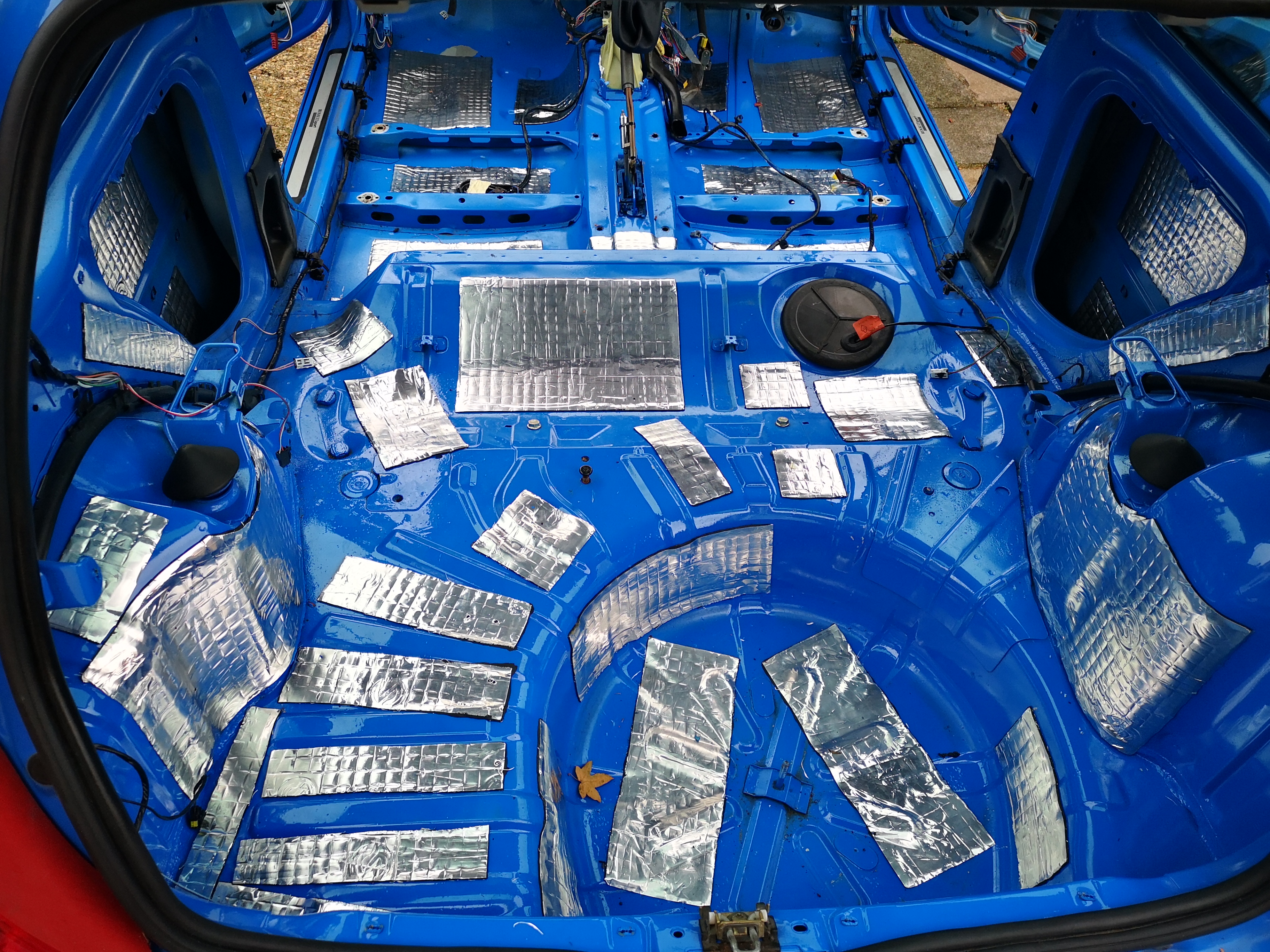

Used the dodomat bitumen/ foil sheets mainly. Makes a massive difference on the larger panels.
Also used a sticky backed foam sheet on the arches and some other areas to add a little extra. Not heavy at all.
A pack of 20 sheets is about £30 and a few kg so not something you’d notice or want to moan about id have thought

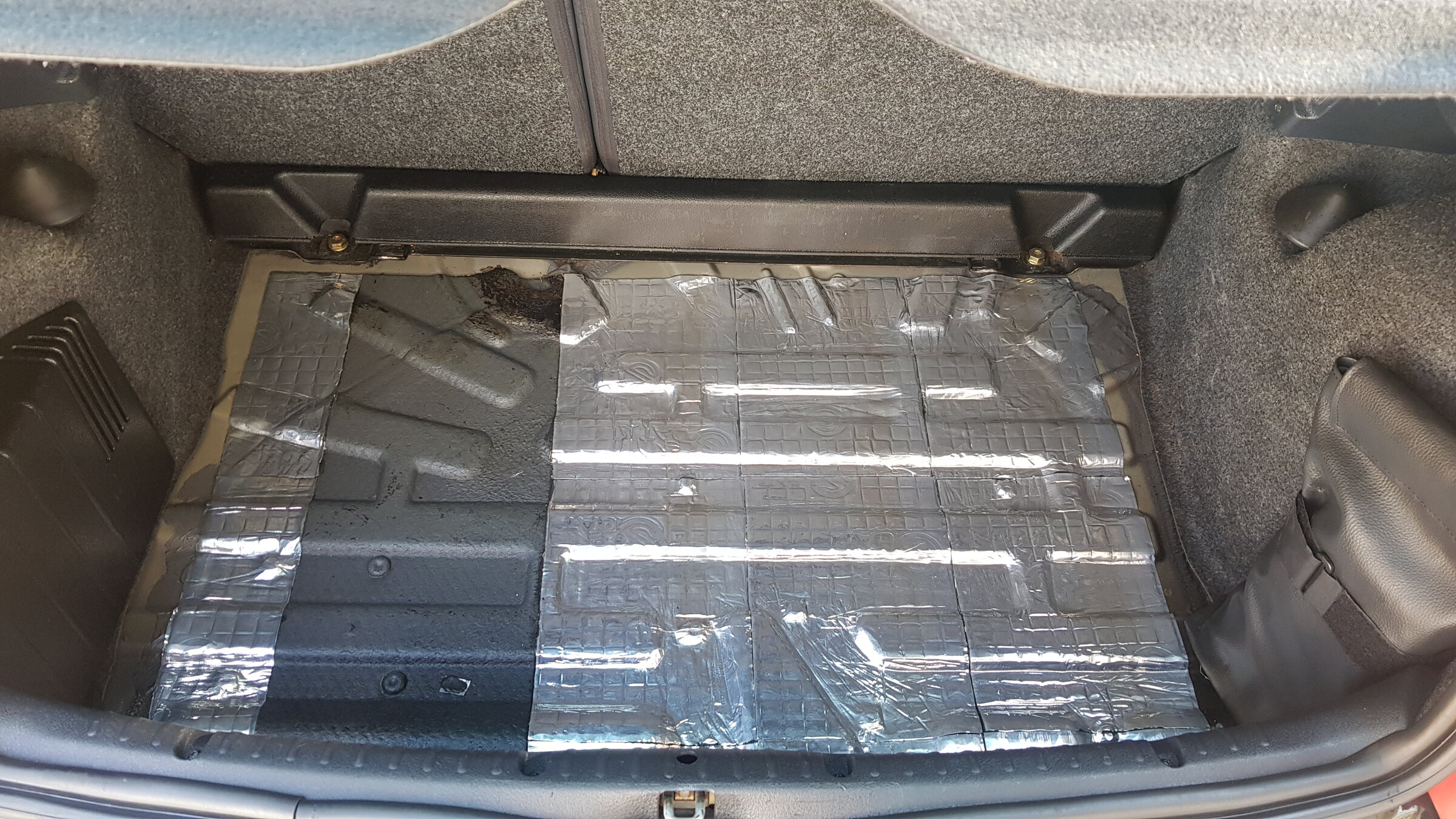

This was around 20kg of silent coat sound deadening.. Managed to get it into the rear quarters and front doors also.. Would need much more to cover the whole car, I tried to get it on the flatter areas to reduce resonance as much as possible and make the 20kg go as far as possible
I then added a full layer of closed cell foam throughout the whole car before fitting everything back. The foam doesn't really weigh anything so went to town with that.. Only issue is the thickness so some of the trim can be awkward to get back in but it reduces trim vibrations at the same time which is a bonus.
Wouldn't say the difference was night and day, but certainly did reduce road and exhaust noise.. I think the bulkhead/bonnet would be a good area to reduce engine noise into the vehicle.
